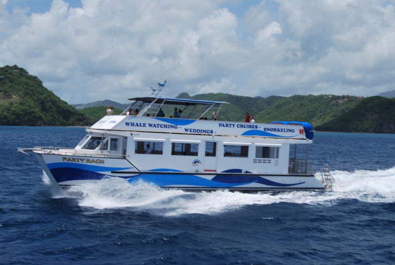

    On my power catamaran I want to replace the plastic curtains on the downstairs windows with a Polycarbonate or Acrylic or any such material that may be recomended.
    The space is 3' high by 6' long and i plan to put the forward section fixed, with the back piece slide able on a track.
    I think 1/4" thickness would be fine for this application.
    Does anyone know of some good suppliers or have any other suggestions.

    Here is a look at the boat and the downstairs windows i want to block.
