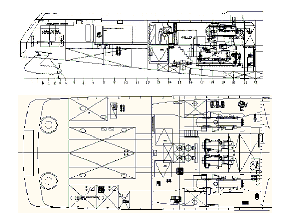

    1 Picture below :
    This presentation features the ABB installation on a 65m Yacht under construction at Azimut SpA - Benetti in Italy. The Ambrosia III is due to be completed in mid-2005.
    The main generator sets, two Caterpillar 3512B, rated at 1200 kW, 1500 rpm, and two Caterpillar 3408C rated at 300 kW, 1500 rpm, are located midships. The smaller gensets are placed in a soundproof compartment and used for station keeping and idling speeds up to 9 knots.
    ABB Marine Deliveries 2004 :
    * Main Switchboards, 690 V, 50 Hz
    * 2 x 1070 kW Compact Azipod Propulsion
    * Distribution Transformers and Filters
    * Integrated Machinery Automation Systems
