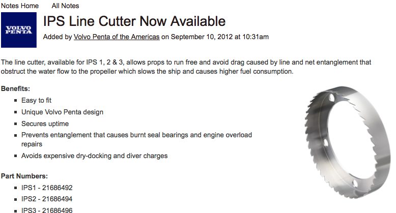

    I'm interested in people's experience with the Volvo IPS and ZF Pod drive systems specifically in comparing their respective vulnerability to fouling. It intuitively seems to me that the forward skeg of the ZF system must make it less prone to fouling compared to the props forward configuration of the IPS.
    Also does anyone know if rope cutters can be fitted with either/both?

    Lastly, Volvo does make a line cutters for the IPS System. It is Part #21686492. I have not used this and cannot comment on its effectiveness.
