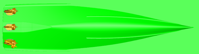

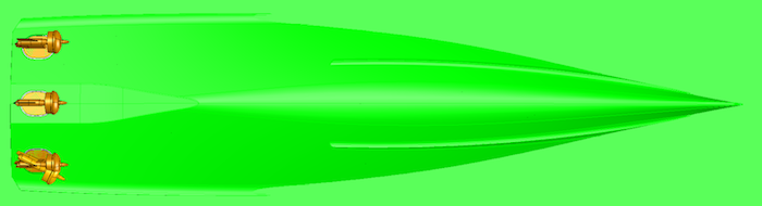

  9. AMG
    5,380
    I don't know exactly what you mean, but here is the waterline at rest on this hull, so it is pretty sharp...
  10. Beau
    Beau Senior Member
    Jan 15, 2010
    2,261
    Beaufort, NC
    I
    You guys are way more advanced than I so my vocabulary is limited. But looking from the side on the video, the bow comes down perpendicular to the water very straight then transitions to the fore to aft portion of the boat (the fore keel?) with a very tight radius. The down-easter's as I now compare them to your the video, have more of that sweeping transition/radius of a traditional sport fisher even if the bow is a little more perpendicular. Ignore my comments because my first comment really have very little relevancy as I see from the video.
