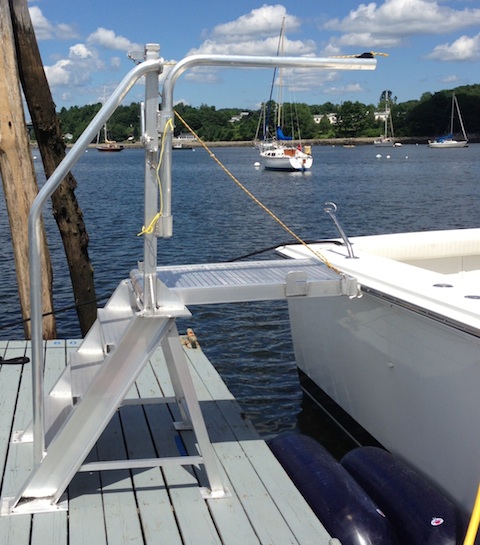

    Just wanted to show off my new Pier Stand. Custom made by John Coker - Advanced Platforms - Stuart FL.
    I let John know what I was trying to accomplish - he had something close - made some modifications to his existing design, crated it and shipped it - $1360 complete. It's fantastic. It's installed on my floating dock in Maine and makes loading/unloading possible for everybody ... easily!
    John is a great guy to work with. He responded quickly with diagrams of what he had planned, crated it nicely and shipped it to my door.
    The 3 foot platform folds up as does the portion of the rail that extends towards the boat. The platform does not rest on the boat ... instead it comes to within 6" of the boat and has a nice rubber bumper on the end.
    It's very stable ... shot a few self tapping screws through the rear legs into the dock - removal would take 5 min with a cordless drill.

    All good till the day that those self tappers have reacted with the alu and salt air and the heads pull off as you step from your boat to the platform.
    If it's your berth and your there long term do the extra mile and through bolt it, or at least use something better ( safer) than self tappers which are not actually wood screws in the first place.

    Yes ... once my landlord approves, I will use a more heavy duty screw for mounting ... but ... the pier stand will be removed at the end of each season and stored until the next.

    :eek: You mught want to get a couple of planks so they'll age with the dock and you'll be prepared to drop them in if you move.
    I agree with K1W1. You need to through bolt. When you put a couple hundred pounds on that platform it's going to put a lot of pressue on those back screws as the unit wants to pivot. Also, I'm not sure about the screw holding properties of that artifical decking. Looks like a nicely done job though.

    I was thinking of bolts, thru the decking, in-between the planks, then thru again a backing board or two. Now you have a pulling load on a couple (or more) of the decking planks. For sure now, your pulling and trusting the original dock decking not to pull up off the frames and braces. Maybe the less damage to the dock this way.
    If you glue the backing plates in place, easy to set up again next time installed.

    You could securely attach the boarding ladder to a piece of plywood of the correct dimension to prevent it from tipping, and have that sit on the dock or attach it with weak screws

    Yes ... this would decrease the tipping leverage and still not be thick enough to trip over when the platform is raised and walking in front of it.

    Or use a an L bolt that would slip through those slats and wing nut em on top, no holes, no damage and temporary. It would be a clamping type setup.

    Thank you ... friends, family and dock neighbors love it. She is already very stable because the 3' platform only extends 2' beyond the feet. She is bolted to the dock and can likely handle a thousand pounds more weight than I will ever put on her.
