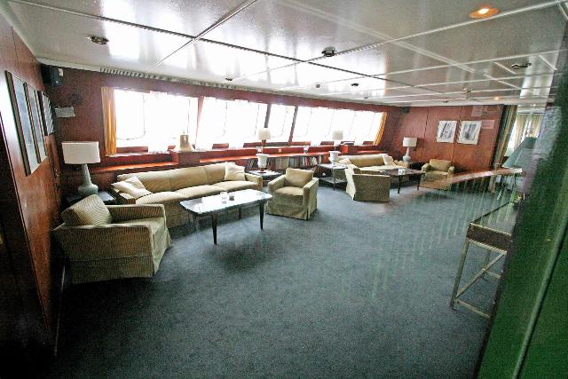

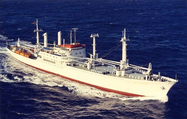

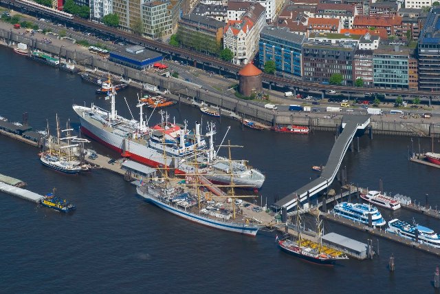

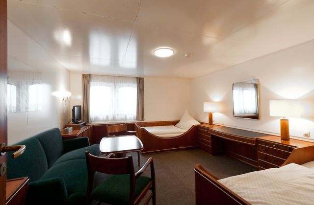

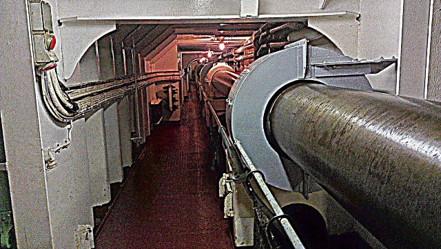

    Finally Marmot, below some nice memories from the good old days:
      101 KB
      2,922
      56.1 KB
      2,868
      31.4 KB
      2,825
      197.5 KB
      2,937
      139.8 KB
      2,878
