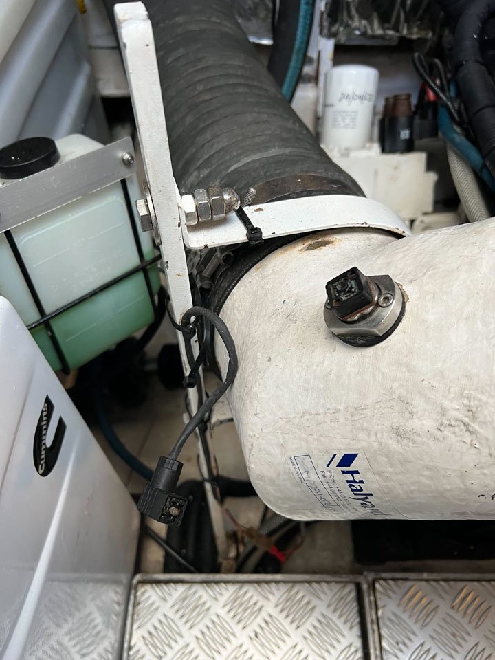

    Hey Nick, I have a similar problem with my 1998 Viking Princess . Port exhaust overheat light on flybridge. Been trying to locate sensor. Have twin Caterpillar 660's. No luck from Princess or Viking.Do you have any info on location? Thank You, Jim

    Hey Nick, Thank you for your information. Been trying to solve this for months now! Do you happen to know where this sensor's located in exhaust system for replacement?? Would you mind sharing the manufacturers link ? Again thank you so much for your help!!! Jim

    Jim,
    See the picture, the sensor is on the exhaust pipe and very easy to locate.
    What happened to ordering from US part store? You will save duty and international shipping charges. The manufacturer is the ABS Halyard Dealer in UK. You can get the sensors from them if you can't get them from the US store.
