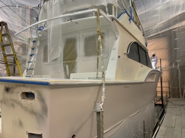

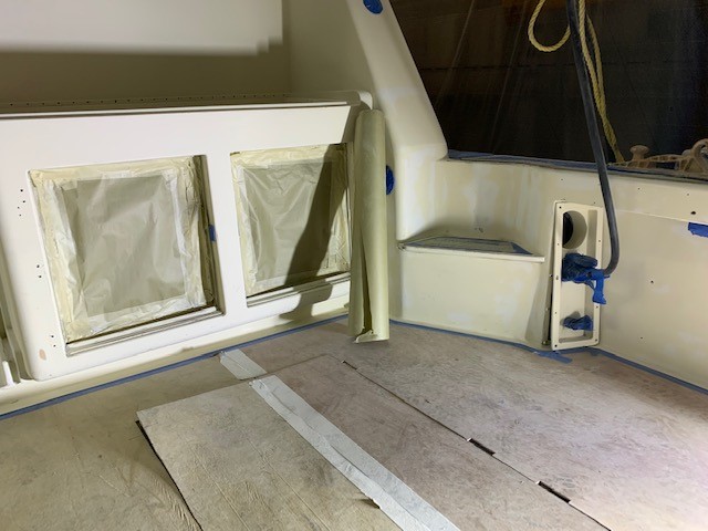

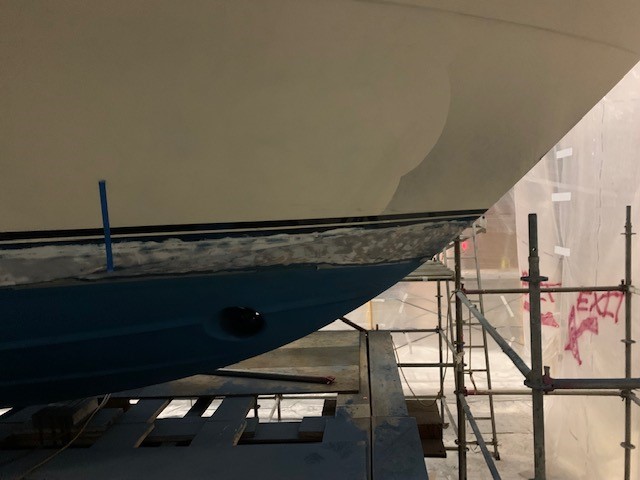

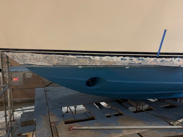

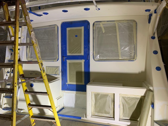

    My big winter project this year is painting the exterior of the boat. Just about everything gets painted except inside the flybridge area as that was recently done. So freeboard of hull, cockpit area, decks, house sides and front, pretty much everything exterior above the waterline. We are also correcting the waterline by lowering it up forward. The waterline was already too high even before I repowered and shed some weight off the boat. So the a/f is being sanded off in these areas in order to paint the freeboard down to a more appropriate place. We marked it before we hauled then shot the new old and new lines in with a laser to establish where it should be. Paint will be AwlCraft. I decided to stay with original colors for ease of maintenance and to minimize any issues from future scratches. The main color is Cream and the mask on the front of the house and around the windows is Flag Blue. I contemplated going more pure white so as not to age the boat but ultimately decided to embrace the vintage reality of my '94 hull and stay true to it. With virtually everything mechanical new, the paint should give me just about the newest '94 out there :):)
    The paint crew I hired showed up last week and they are off and running. These guys don't mess around. They are planning to spray first coats in a few days. They are working from the bottom up and we will build scaffolding for them as they go. This way they have clear walking surfaces but don't have any poles in their way as they work and spray. They expect about 6 weeks total for the job plus the additional time needed as they encounter areas that need more than just sand then paint.
    My other projects are new canvas in most areas, cockpit freezer door gasket upgrade, new dedicated generator starting battery and a few other misc items. Of course, full maintenance and fluid changes on everything is a given.
    Aft Bulkhead Masked.jpg Cockpit Masked.jpg Tackle station.jpg Stbd Waterline Change.jpg Port Waterline Change.jpg

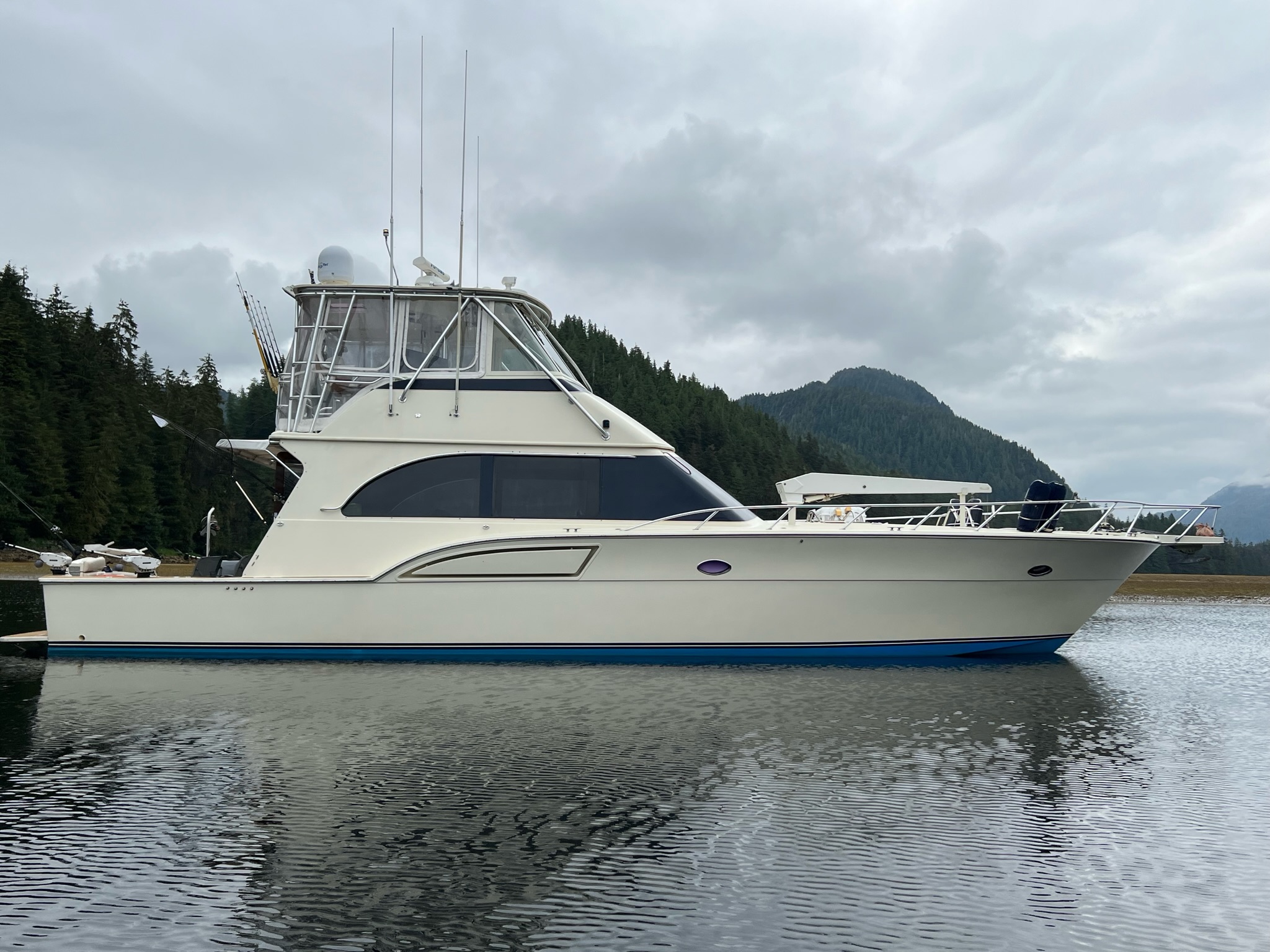

    The waterline change was pretty even down the length. However, the waterline up forward has been too high since I bought the boat. No idea if it came from the factory this way or if somewhere over the years somebody changed it. You can see what I mean in this recent photo:

    The origional waterline is probably correct if someone had a 1000 lbs dinghy up there. Also I would leave it as you're then going to get into the spray rail part of the hull at the bow and you'll be constantly be repainting that area due to debris hitting it at slow speeds. Well, not constantly but every year or two if you use the boat often.

    Holy cow, lol, I thought the job was done in this photo at first...she looks great as is. But I understand it's a photo which hides things in real time.

    I'm with J on this one, adjusting based on no dink on the bow might come back to bite you. I'm assuming you're leaving the crane and dink up there for the future.

    I do carry a dinghy on the bow. I’m in it taking the photo :):). It’s a 14’ RIB with Yamaha 50 hp. I’ve never weighed it, but likely in the 1k# range. I accounted for the weight of the dinghy and marked and measured with it on there. There is almost 12” of A/F above the waterline in the bow at full load. I’m lowering the waterline less than half of that so I should be good.

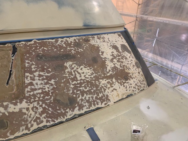

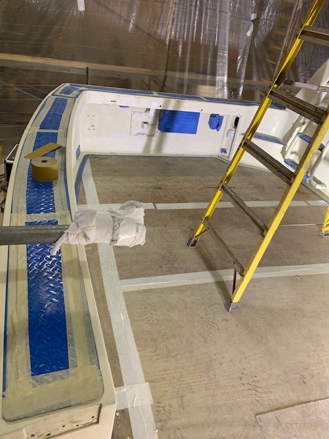

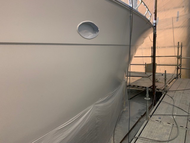

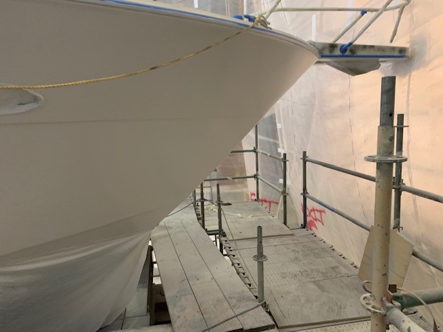

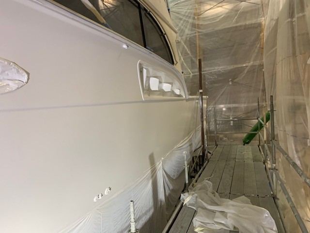

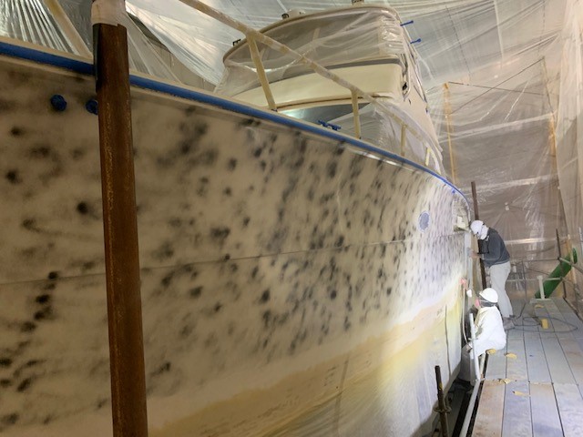

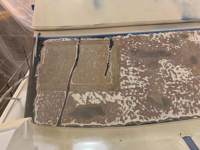

    Progress is moving right along. The process for this is more involved than I was aware. They clean, wipe everything down, sand everything, then an initial guide coat followed by second sanding, then another guide coat and sanding, then 545 primer followed by 320 grit sanding , two coats of color and a final clear coat. Of course, any imperfections are filled and faired at each step along the way.
    The company I hired is World Yacht Refinishing - http://worldyachtrefinishing.com/ So far I have been very impressed by their work.
    As mentioned earlier, the FWD Mask was one of the worst areas on the boat. We decided to take this completely down to bare glass. This will get a whole new layer of glass followed by AwlFair and then into the painting sequence. The concern here was past repairs did not provide solid enough substrate and we needed new glass to ensure there is no future cracking or failures. We found several areas under the mask that had repairs either from previous owners or perhaps they were factory flaws from construction? No way to know what went on here but it will be better than new when we are done.
    FWD Deck Prep.jpg Port Freeboard Guide Coat.jpg STBD Mask Prep.jpg Port Mask Prep.jpg

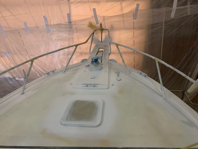

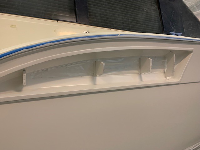

    Most of the hull freeboard areas are in the 545 primer now and almost ready for color coats:
