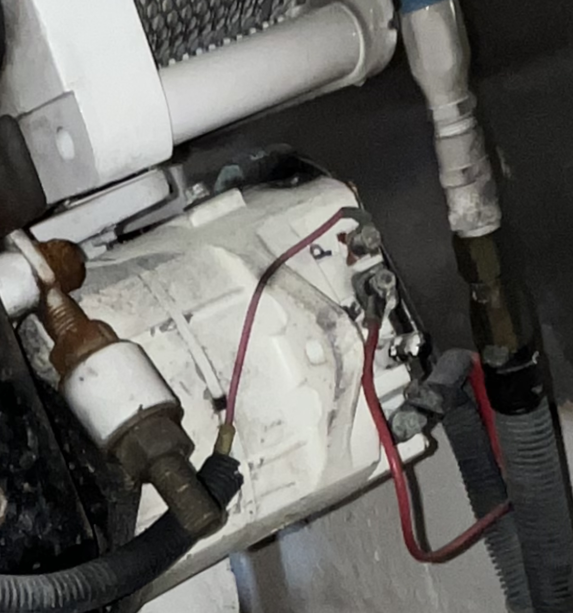

    My STBD Delco-Remy 35SI alternator on a Series 60 seems to be overcharging. Goes up to 15.4 volts and likely higher if I continued to increase RPM.
    This is how it looks:
    The top wire runs up to the the Flybridge and goes to the momentary start switch or ignition. The next wire down goes to the battery switch AFD position.

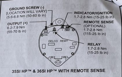

    The instructions that came with the replacement alternator make me think this alternator has the field exciting wire and battery sensor wires reversed.
    The Port alternator is wired the same as the STBD.
    Normally I would wire the new one same as the old. However, the diagram and a sticker on the alternator make it clear that battery sense is the top lug.
    Making myself crazy. Had to dismantle the cable master to access to STBD alternator. Trying to get this right the first time.

    Battery sense from the ignition switch is not to smart. A wires goes to the helm, then back the the alternator. Lots of voltage drop in those wires and as age comes on, more resistance.
    Soon your alternator is screaming to get that sense level up. Then, over charges the batteries.
    If you are NOT using a diode battery isolation, wire the sense rite to the battery out put.
    If you are using diode battery isolation, wire the sense to the starter battery side of the isolation diode.
    If you feel you must turn the sense off by key switch, Wire in a relay as I have done on my boat. Connects battery to the sense lead, controlled by the key switch.

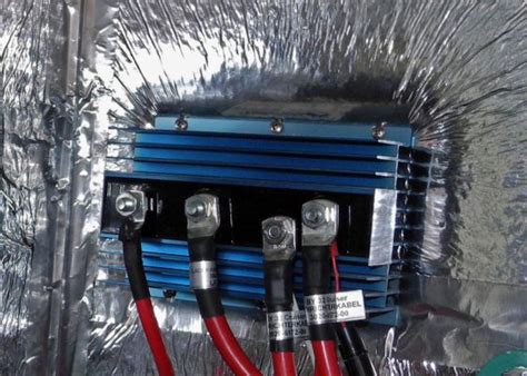

    How can I check to see if there is diode battery isolation?
  4. Capt Ralph
    13,270
    Where does the alternator B+ lead go?
    Straight the the battery post on the starter?
    Straight to the battery?
    Or, to some weird looking gizmo with similar sized wire/cabled connected to it.

    No diode battery isolation. Alternator positive battery terminal is connected directly to bus on the battery bank. I’m planning to wire the sense line directly to the battery bank. It’s about a 4’ run. Should it go to a battery or the bus bar?

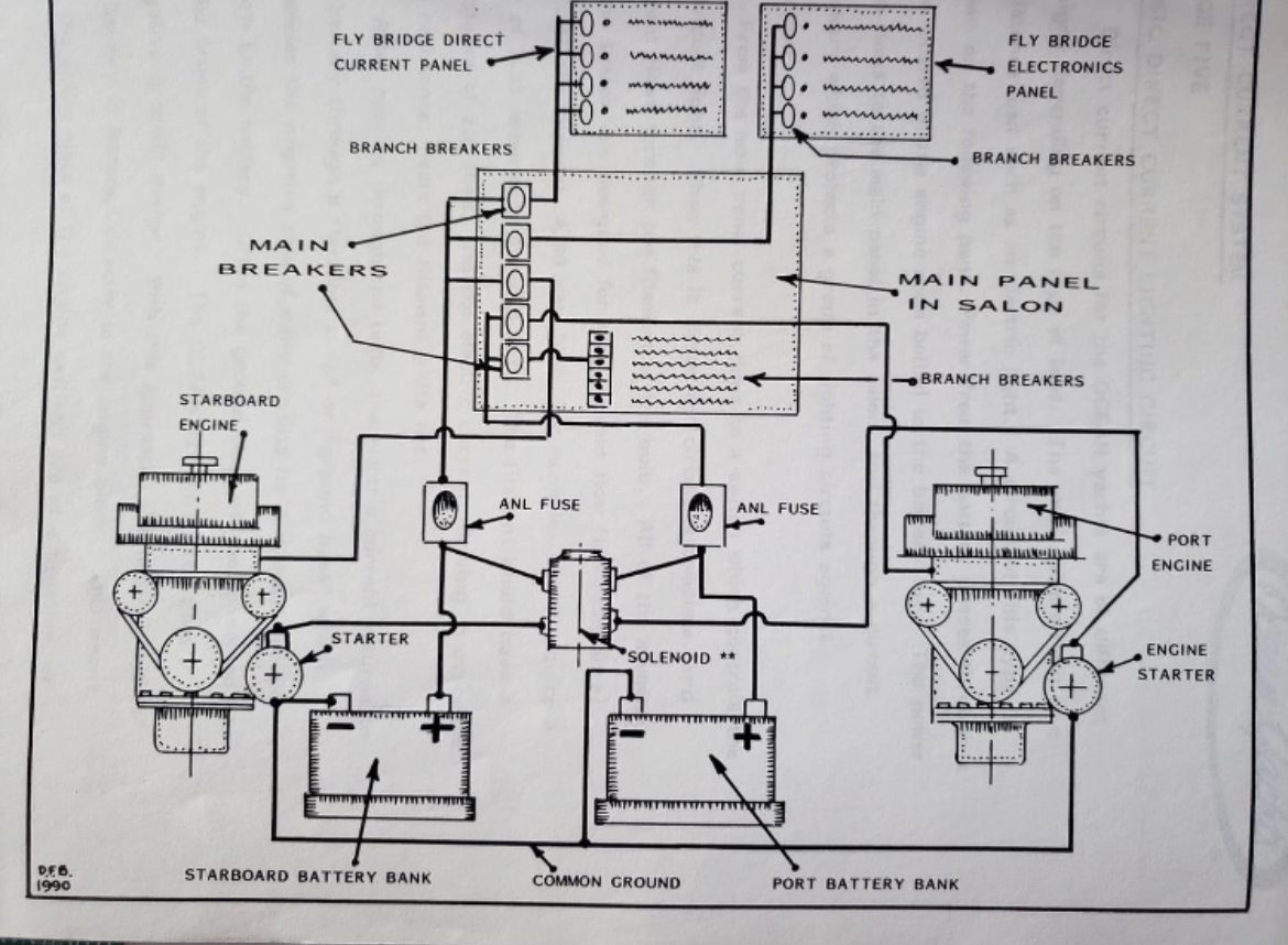

    Relatively new, on our 5th year with it. Boat did not come with any manuals. Wish I had detailed electrical plans like my former Pursuit. Made many things easier. Picture below came from another earlier Ocean. It represents what I have, but not a lot of detail.
    The starters are 12v. The solenoid does not seem fancy a basic NAPA part. The only diodes I have found are on either side of the battery parallel solenoid to avoid the starting of one engine crossing the solenoid to start the other. I replaced these a couple of years ago.

    Installed the alternator. Started the engine alternator was charging correctly. Went to shut engine down and it would not turn off. Had to cut the wire running from the alternator ignition terminal to the engine to shut it off.
    I think the alternator was putting power to ignition run circuit as opposed to the start circuit.
    Thinking to put connections back to the way it was with the ignition wire for battery sense and excitation wire direct from the battery.
