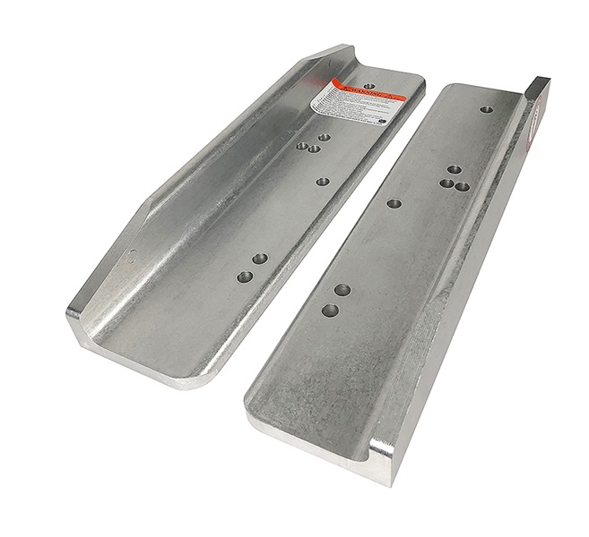

    Last year I picked up a lil 2002 Mako 171. It came with a 2003 Merc 20” tall, 125HP 2+2 (idles on two carbs, runs out on 4 carbs). I never liked the way it ran. Just figured out it was way (WAY) over pitched. Came with a 21” pitch, finally just broke down and purchased a 17”. Runs lots better now. Also, this engine is mounted one hole to high on the transom. Even if I keep it, this has to come down a peg.
    In the meantime, Found a 2003 25”, 135HP OptiMax. 1 month later, it is still in my van.
    I’ve had these big (new) conversion brackets in my shop for about 10 years. Just for bolting on a 25” to a 20” transom. Ready to give this a try,,,,, I Think…
    Other specs; The 125 is a 112.8 cubic inch, in line 4 lunger. Shares the same power head with the 115hp engine. 4 ¼” lower case. 2.07:1 lower ratio. On the power head oil reservoir. Weighs 348 lbs.
    The 135 is a 153 cubic inch, 60° V-6. Direct fuel injection. Shares the same power head with the 150HP engine. 4 ¾” lower case. 2.00:1 lower ratio. Remote oil reservoir. Weighs 452 lbs. With brackets I can imagine 470 lbs back there.
    The Mako is the inland model CC with a T top. Not a real V at the transom as the 172 coastal. I don’t think the extra weight will hurt it that much. When I stand on stern, the hull drops slightly. Pretty stable hull. Lenco trim tabs. The transom seems really solid. I had to drill thru it to install a swim-out platform, bone dry and solid.
    I gave my engine hoist aweigh a couple of years ago. Trying to borrow it back. Probably going to SunBelt and rent one a few days.
    So, brothers and sisters, my questions; Anybody delt with these engine brackets before? Going to bend over the transom? Looks like anodized aluminum, need primer and paint? Trim motor would not be in the water with this install.
    Anybody dealt with this OptiMax stuff before? Worth a change or just lower what I have and keep it simple?

    I have a Skeeter 20' Bay boat with an adjustable jack plate and never had a problem with it. It raises the motor 3" above the transom and aft of the transom 8''.

    If I can ever get a good feeling about raising it on these big angle brackets, It does have some benefits over the 20" install.
    Mercury hardware, more of the bracket & trim motor is out/aweigh of the water.
    Never liked the idea of these trim motors in the water.
    Also, can build a better dike to keep following water out of the boat.
    Just wish I can get a better feeling over these brackets.

    Apologies but can't give any direct experience with aluminium angle brackets as shown, carrying full thrust and manoeuvring loading from the engine, cantilevered up from an existing transom. Perhaps jack plates rated for your installation would be the best ready-fit solution.

    Jack plates, extension plates, riser plates,,,, they all change the angle of applied pressure on the low transom.Hense my concerns.
