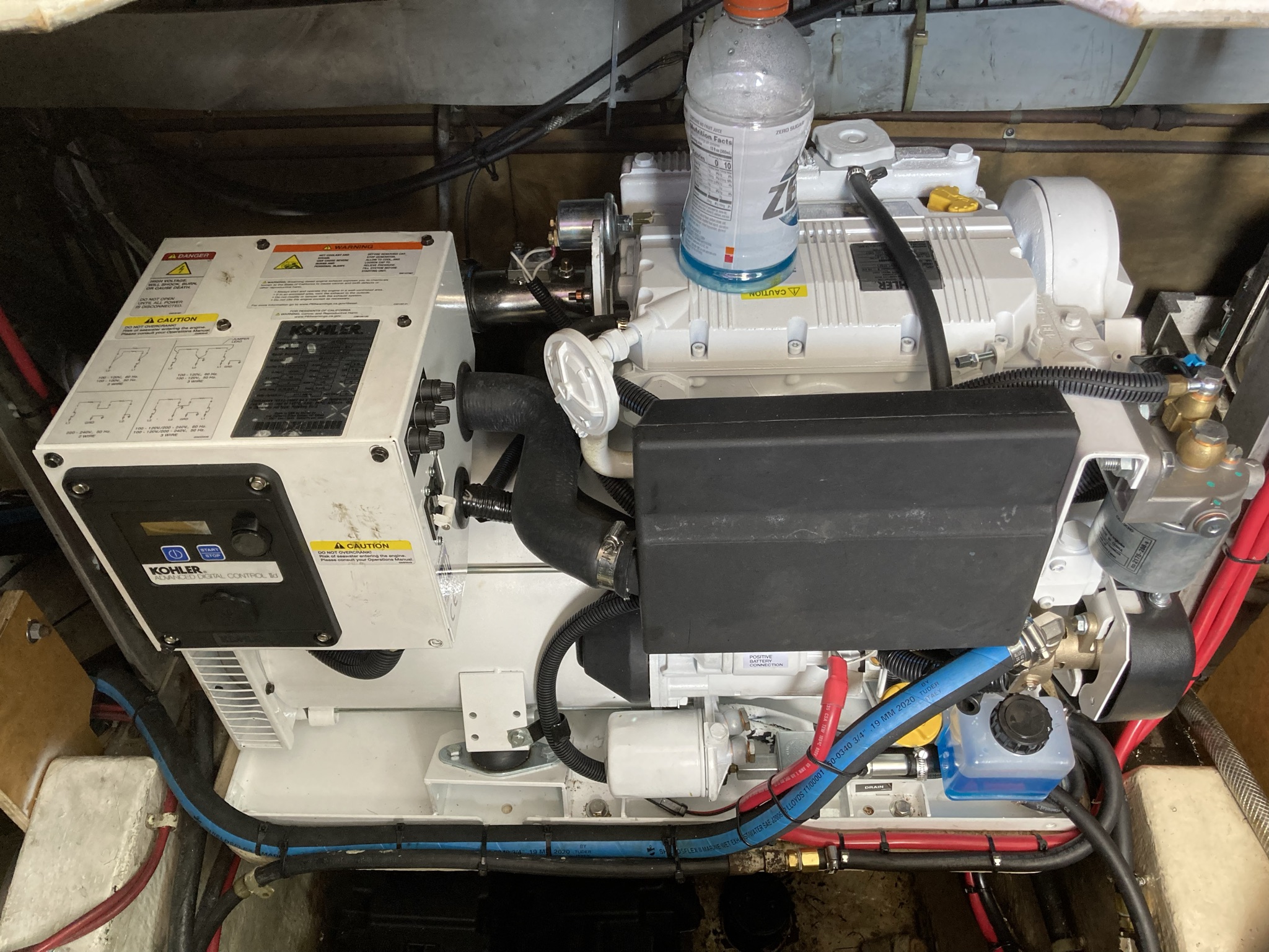

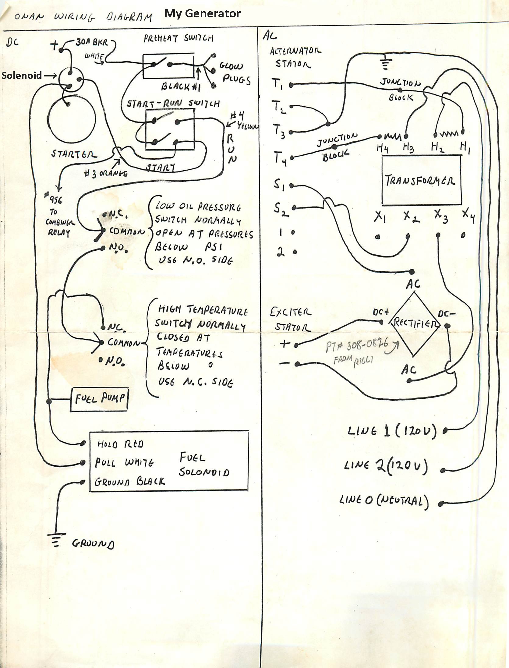

    It's a Kubota engine so parts should be available outside of the crooks at Onan. Before boat was sold I used to get parts at a local Phasor distributer for a LOT less. Buddy sailing around the world reported his 8kw was starting to get tired at 50,000. hours before selling the boat. He had rewired the control box getting rid of the solid state circuit board.

    I remembered once getting this revised wiring diagram when buddy eliminated the circuit board in his 8kw. She had been a hurricane Andrew total.
