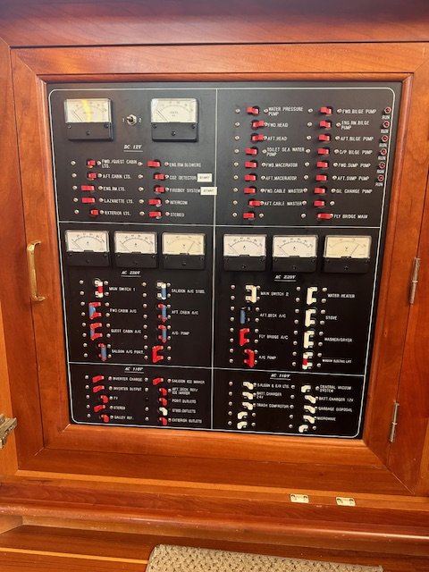

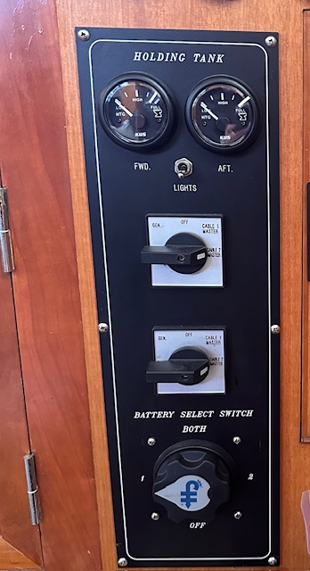

    The gen-set had always delivered 220Vac until recently. The ships panel has two sides powered by two selector switches. One switch for panel 1, and one switch for panel 2. Each panel side has two Amp meters and one Vac meter. There are no 110Vac meters.
    Both Techs used a hand held multi-meter to check the supply from the gen-set and the meter showed the gen-set was producing 239Vac. The second Tech checked the system using all four sources of incoming shore power and gen-set. The three shore power cords energized the panel with 220 Vac and all electrical components worked. The gen-set power switch did not display any 220Vac and would only produce 119Vac and 117Vac respectively at the main breakers. The second Tech then conducted a by-pass of the gen-set switch and received the same readings.

    Here are photos of the electrical panel and switches. The switch handle blocks the shore power chore setting at the 9 o'clock position.

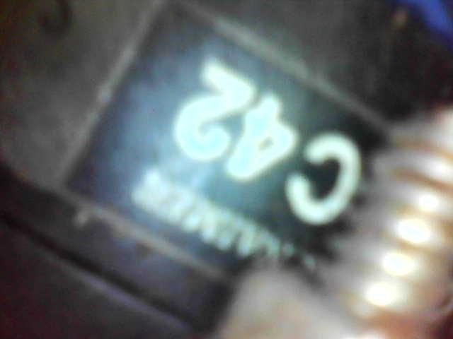

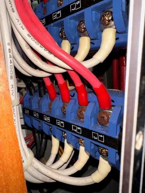

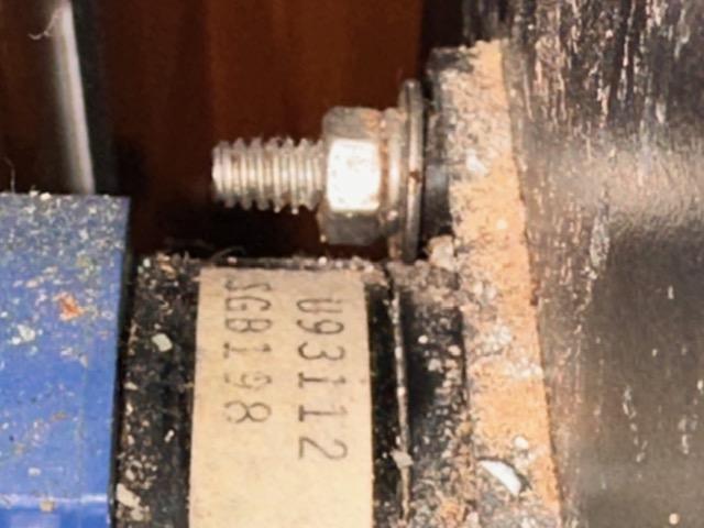

    I'm not certain what make the switches are. The numbers on the switches are; C42 / U93112 / SGB198.
    Hope these photos help Identify the switches. The C42 plate has a make/name above the number and it looks like it ends with the letters "MIMER".
    I will be going back to the boat this weekend and I will try to get a better angle to read the full name above the C42.

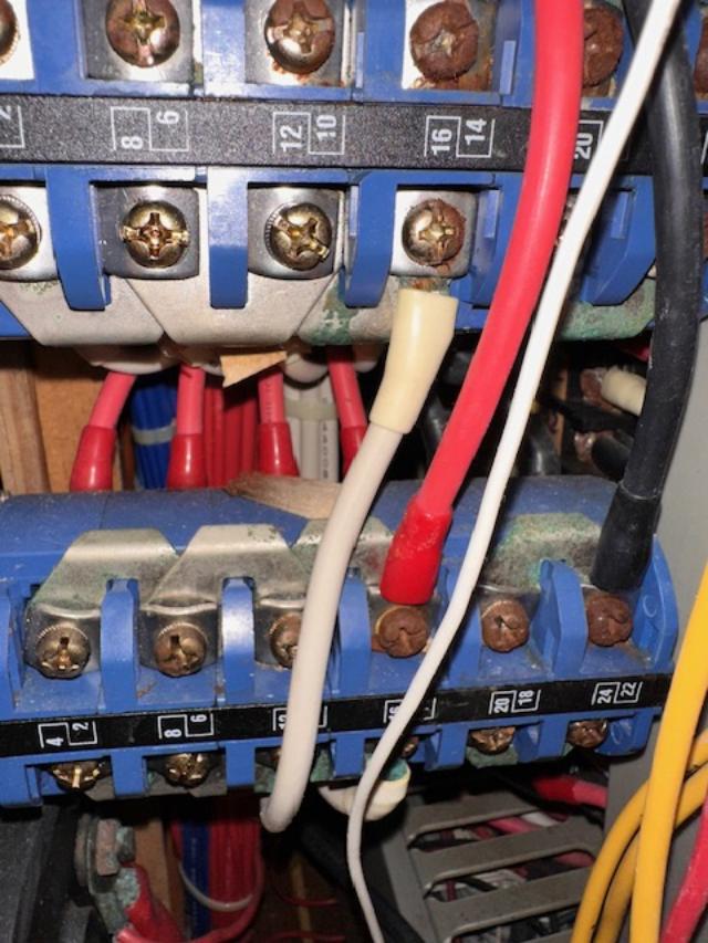

    Those are Kraus-Naimer switches. They are smaller than mine.
    In your pictures you can see that contact stations are added to the switch and then jumpered in parallel. This makes the switch much longer.
    This offers more contractors to share the current handled by the switch. Further encouraging not an internal switch issue.
    There is enough green in there for a salad. In my opinion (IMO), those connections and cable ends are not to be trusted and very well may be your issue.

    I've looked further into the wiring and found a separate terminal block that had a corroded connection. The connection involved two positive leads from the generator to the terminal block then to the rotary switches. I removed them, cut back the insulation to clean wire and connected the wires directly to the switch. This resolved the issue. As you indicted you felt there was a wire issue and it turned out it was. The terminal block will be replaced and the wire insulation cut back to clean wire and re-connected. I will also remove the terminals on the switches, cut the insulation back and re-connect them as well. Thank you for providing me with your knowledge.
