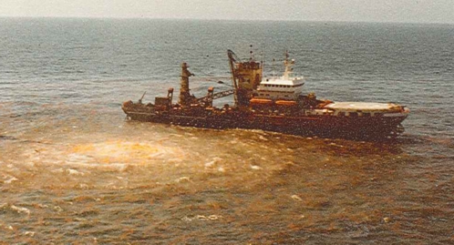

    I can state unequivocally that even if the slick makes it around to Florida's east coast, you will have absolutely no problems.
    I spent 2 months four-point moored next to the IXTOC blowout, literally close enough to throw an apple into the flames, surrounded by the same crude oil and we had zero problems besides being tired of the smell and mess.
    Don't ever forget in events like this that there is a great deal of money to be made by those who promote fear of the sky falling, the earth imploding, and engines self destructing at the sight of a tarball. If you motored under the 17th St bridge last week you were probably exposed to more petroleum products than the boats working in the Gulf right now.
