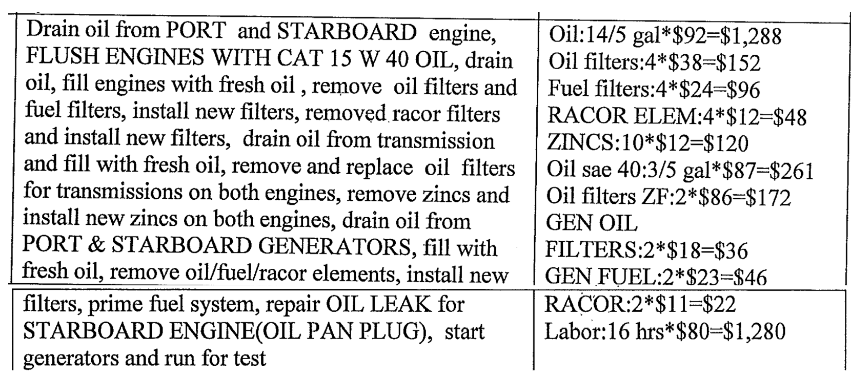

    I'm looking through the receipts that I inherited with our new-to-us boat and found this service from last year, performed by N&G in Hollywood, FL:
    Is there a legitimate reason to do a complete flush (i.e. drain, fill, run the engine, drain, fill)? I suppose you would get a more complete oil change out of it, but it seems like a lot of extra work. $3521 for the two mains (Cat 3412Es) and two Onan generators, so the total cost isn't that outrageous.

    (Sorry for the too-large picture -- I'm trying to figure out how to fix it but can't seem to find an "edit post" button...)
  3. NYCAP123
    11,208
    Possibly the previous oil analysis showed contaminants?

    I've done that type of flush when I've done engine work, like valves and head work. to make sure all the "dropped" debris is removed, But its unusual IMO for a regular oil change.

    Good idea. I just checked on this and the previous samples (from 2017) from each engine show all green.

    The other work done that same visit was to drain the coolant (from only the port engine) and replace a leaking raw water cooling pump. Perhaps they were concerned about that, somehow. In any case, it's good to know that this isn't the "norm". Thanks!

    N+G engineering is an excellent Cat repair shop. If you call them, speak to Gabriel and he'll remember the boat and tell you why. I could see doing a flush IF somehow water got into the oil (aftercoolers leaking etc.), after major work, or if there's bad oil samples. The total cost is very reasonable.

    I really can’t think of a reason to do an oil flush unless something happened like water ingestion. Even a minor amount of coolant or raw water getting in the oil during maintenance should not be enough to do a flush.
