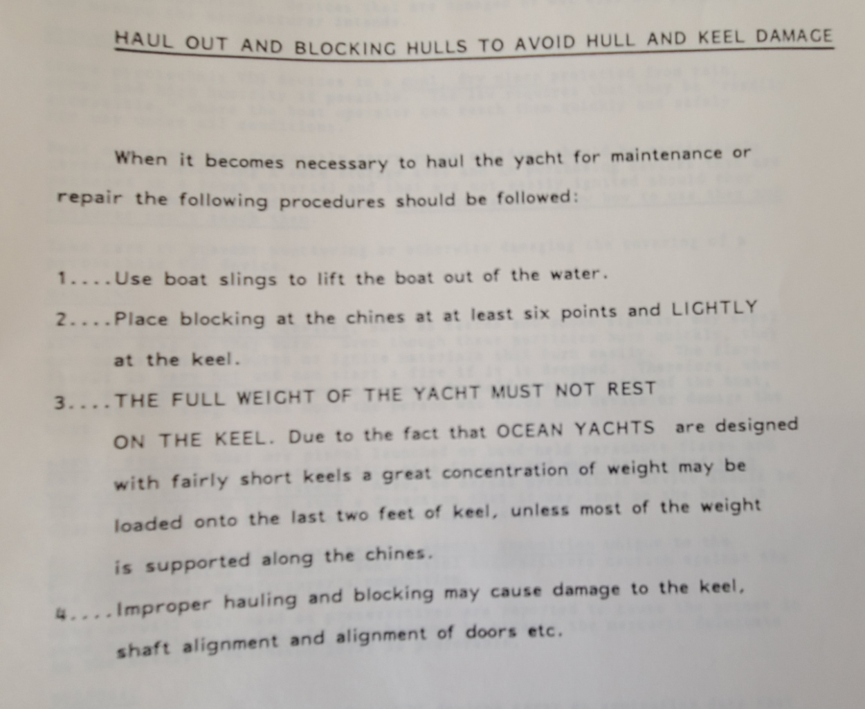

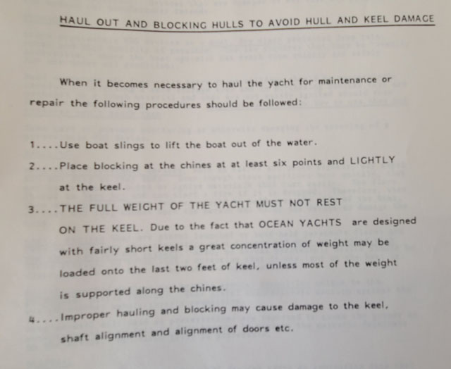

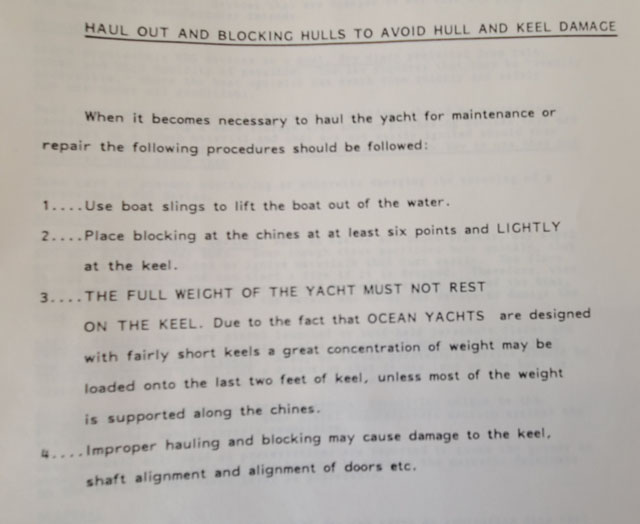

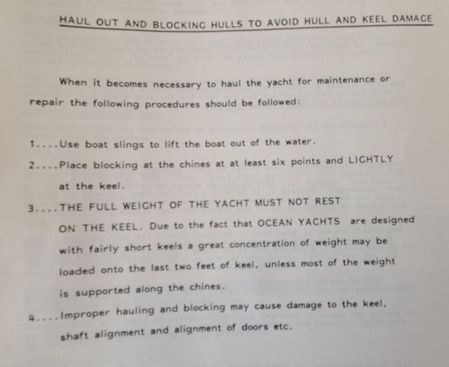

    Here's another thing I learned about Ocean Yachts; According to the original manual, it says not to put full weight on the keel when blocking (see attached, hopefully it's readable), but what they always do. So when I had it hauled last week there was 2 cracks on the keel draining water and with some growth. Looks like it would be right where it would be blocked. I'm having it re-glassed.

    Sounds like the boat must have lived in a no discharge zone and instead of adding a gray water tank they plumbed it into your holding tank. That'll pretty much guaranty backed up toilets. Check the showers and other sinks as well. Yes go overboard (easiest) or add a gray water tank (with vent and pump out). Water drained from the keel? That sounds serious. Go over the hull and keel with a moisture meter.
    Those blocking instructions sound scary but right and pretty standard. In fact I'd probably recommend 8 points. (2 on each chine, 2 on the keel, 2 on the bow). Bring the jack stands tight to the chine then just bring the keel stands up to it, then lower the straps.
    Btw, the best cradle for any boat is the water. If a boat spends too much time on jack stands (or lifts for smaller boats) they sag and it can be death to the boat.
