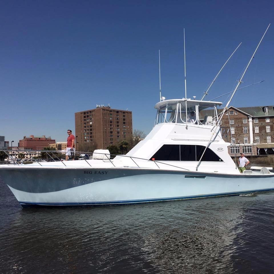

    Well, it official...bought a 1984 Ocean yachts 46 ft....thank you for all the help and information
  11. chesapeake46
    chesapeake46 Senior Member
    Jul 26, 2009
    1,829
    Congratulations
  12. Capt Ralph
    13,443
    Well now. A nice looker..

    Congratulations, looks great!
  17. Trinimax
    Trinimax Senior Member
    Jan 18, 2010
    245
    Congrats. Great hull colour. I take it she has the 671’s
