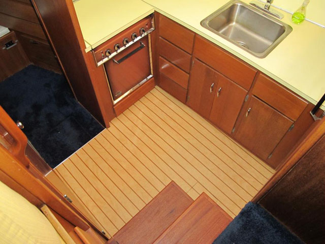

    Lonseal offers a color correct plastic/vinyl trim for the hatch edges. I have never used it. We try to cut the hatch opening close enough that the seam is just a small line with no trim. Your hatches have to fit tight (and not shift) for that to work. On installs where that isn't possible, we trim out the openings with 1/8" or 3/16" strips of real teak on edge. It makes a nice appearance but its a little labor intensive. Not likely a DIY by other than a very skilled owner.
    In the photo there is a no trim hatch just to the right of the steps. This is maple/mahogany Lonseal.
