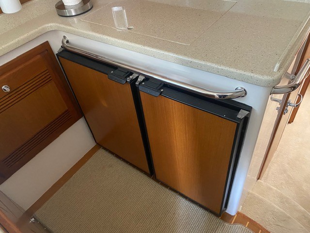

    I'm considering swapping out my side by side fridge/freezer for a over/under fridge freezer. I have seen newer Cabo 40's that have the over/under drawer type. My Cabo is a 2005. Anyone have any info on what units Cabo used on the newer models? My ACDC control module is not working properly so I have to pull the units anyhow and my wife has been asking for the drawer type units for a while now.

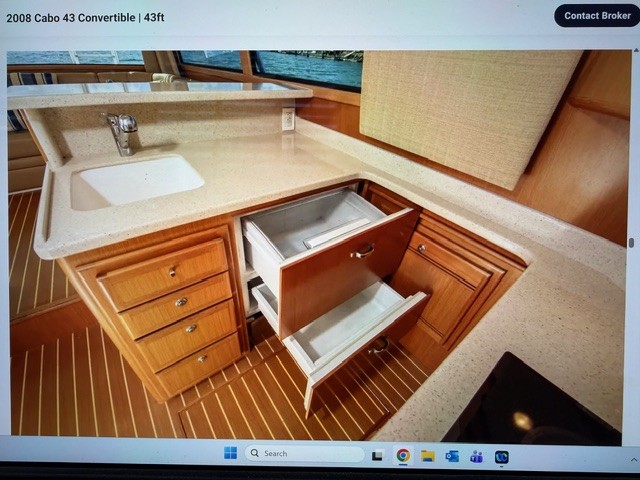

    Sub zero drawers were used on the newer ones.

    Thanks for the feedback. Bottom line is I have some choices and since its winter I have some time to figure out which option to go with. This is what we are looking for and this is on a 43 Cabo convertible.

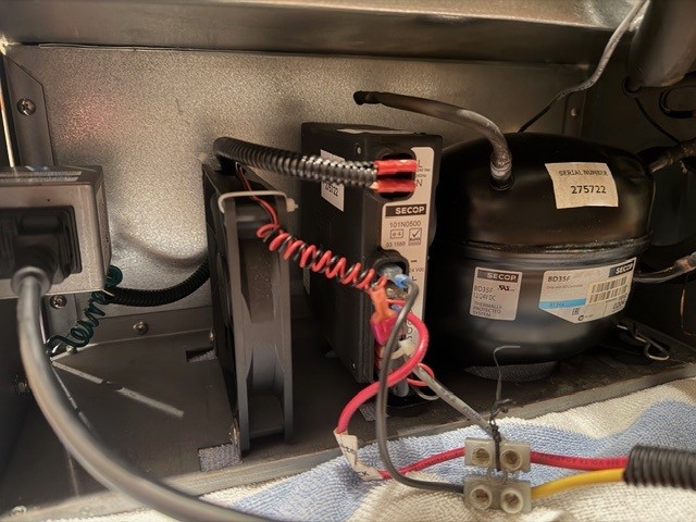

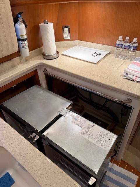

    Crappy weather today so I decided to remove the NovaKool refrigerator/freezer. Looks like the original one was replaced as this one has a 2015 factory sticker on it.
    Going to get some info on the ACDC control unit tomorrow.
  8. Capt Ralph
    14,201
    Pending what your issues are, there may be a fuse in that controller box.
    I recall those were DannFoss DCv compressors. The ACv was just crudely converted down.
    AND, That fan has to run or over temp all out.

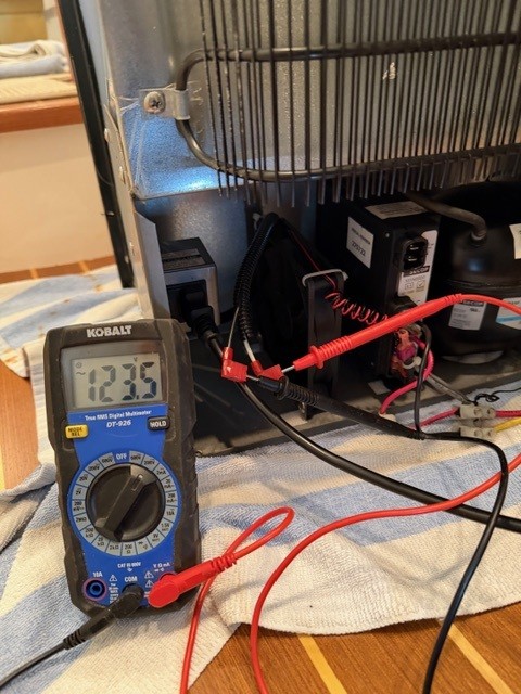

    Looks like it is the ACDC control module as I have have AC voltage through the fuse/control box into the module.
  10. Capt Ralph
    14,201
    So, Still assuming you dont work on ACv but DCv good?
    Yank that box and crack it open. Check for fuses.

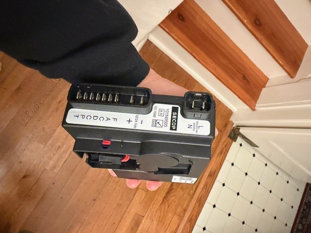

    Fuse was good on the AC side. The ACDC module quit working. Time to repair that or replace with a new module.
