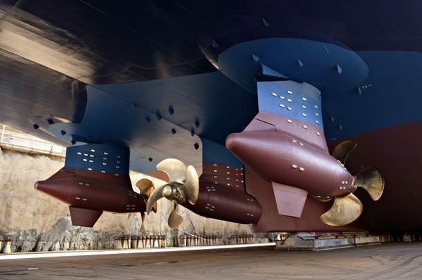

    The inventors of the Azipod thought about it.
  8. Capt J
    14,530
    The IPS and some Zues exhaust through the propellor hubs. Some all of that exhaust on the foward pods would definately create cavitation on the rear pods. The picture Marmot posted, the pods are staggered, but looks like the propellors are pretty much in line.
  9. Capt Ralph
    13,440
    Using you picture, I was thinking that center pod (rotatable also) even more forward. Forming a triangle of traction.
    Not quite a multi point DP system with pods broadcast about the hull.
    I'm no engineer, My mind was just wondering last night about pods and hulls with no thrusters. How big boats used pods with no thrusters and improving the leverage to twist a hull by staggering a pod forward.
