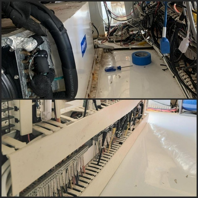

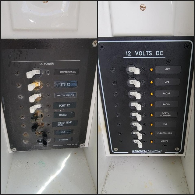

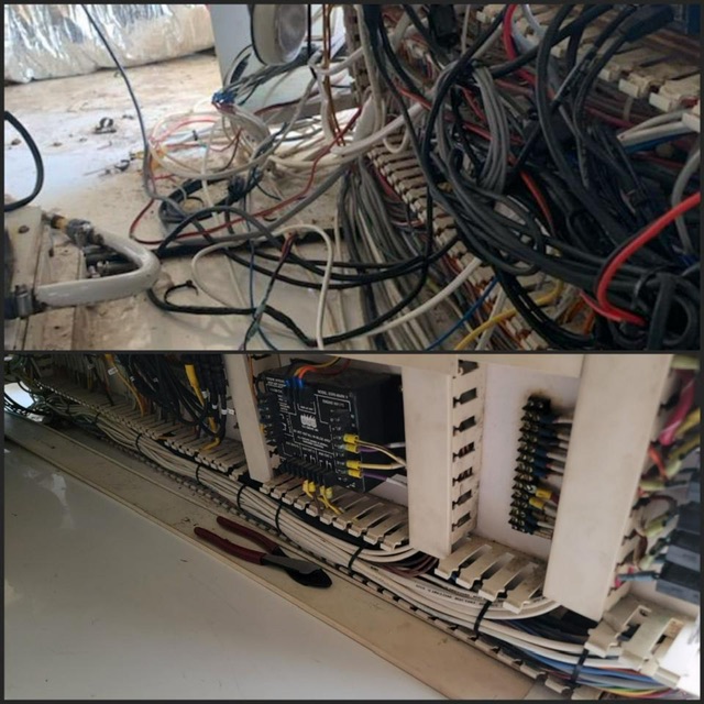

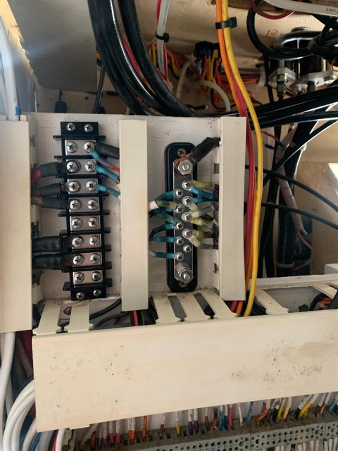

    Adding autopilot, a chart plotter, and star link. I really like the electronics company and had them go all through my helm wiring and clean everything up. We pulled all unnecessary wiring all the way back to the engine room or where have you. Pulled out a large trash bag of unneeded wiring. Cleaned and labeled wiring and replaced flybridge breaker panel and some old bus bars. Very glad to get this done.

    It’s amazing how much old, unused wiring collects on a boat. Looks like a big improvement. Please let us know how you like the STARLINK. I’m getting ready to order mine soon.

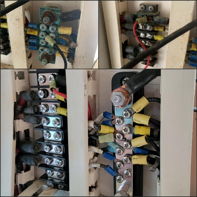

    For your next upgrade I would suggest getting rid of those cheap crimp connectors you have on a bunch of that wiring. They are prone to issues. Replace with marine grade heat shrink connectors. The marine grade has heat activated adhesive in them.

    I only use heat shrink connectors even in dry locations

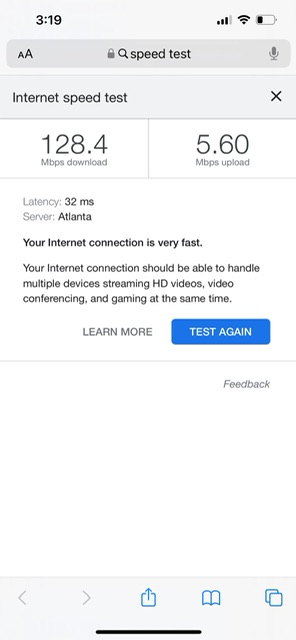

    All, I did notice the prevalence of those crimp connectors. I will see about that for during the next hurricane season when I am laid up. I have not had a chance to use the star link yet. Heading to the boat at the end of March. I got the in motion version. the yard were the boat is has terrible cell and the electronics guy used my starlink to call me from the yard and no drops. Thanks for the feedback.

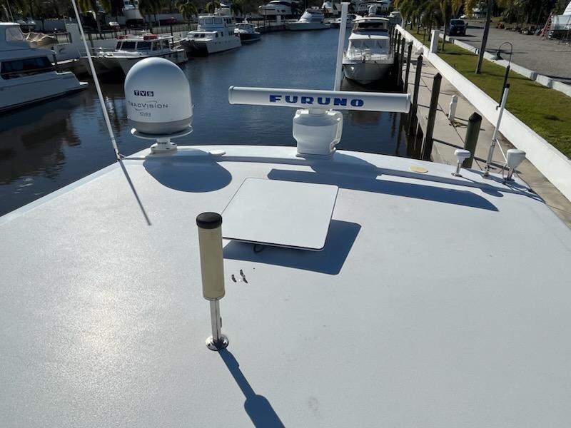

    With having STARLINK now will you get rid of the Tracvison or whatever system you have under that dome?

    I often thought about gutting a dome and installing GPS antennas in there.
    Imagine in that pic (Post #4), all of that stuff on the for/stb corner of the hard top hidden in that dome.

    There's a number of people that are gutting the domes and putting the Starlink inside. The bigger ones will accept the standard SL base,

    I did exactly this. I have two small domes. I use one with GPS antenna inside.

    The new SL in motion antenna is low profile so pretty much invisible on the roof.

    I removed our TV dishes and put a Starlink Panel in each dome. We also have the power supplies and SL equipment in the domes. We've been in the southern Caribbean all winter, and haven't seen any heat issues.

    Electrician had time to change out some of the crimp connectors. The crimps were from Viking so this was overdue. I think i had a ticking time bomb between the crimps and corroded buss bars and fuse panel.

    Ah, so much cleaner, less greener.

    Yuck. That was nasty. Much better.
    a few years ago I opened the 1970 vintage panel on my boat with the ER lights off. I could see little sparks where wires were moving. That’s when I realized it was time to build new panels!

    Nice, I've done the same on most boats we've owned. Never like seeing dead-end wires that are just cut and left in place, especially wiring bundles not properly wrapped and routed. Being an ex- AF aircraft electrician that is just too sloppy for any electrical work.
