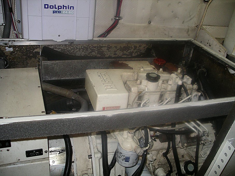

    Here's a photo. Current plan is to pay a visit to the local Phaser distributer after the weekend and learn if it has a Kubota engine. With only 3800 hrs. showing extremely disappointed in this Lugger.

    Ah, another Shibaura block. Between the models I was thinking of.
    That is usually a good block.
    If you replace it; May we deal over this old one? :D I'll wash your car..:)

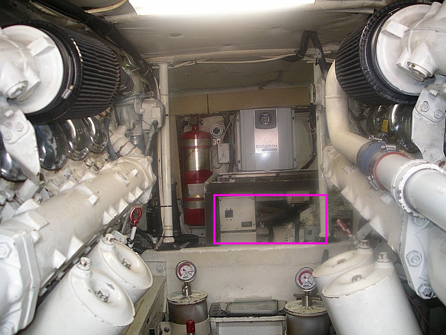

    Problem with trying to slid is it's located in the forward area of a bulkhead that's about 2 ft. tall (see photo below) and needs to go aft, up the cockpit access hatch. Looks like repair is the name of the game. Suspect blown head gasket mostly due to the 16 lb. coolant pressure cap. This AM installed new oil & filter & ran about 5 min. with the coolant cap off. Sounds normal. Seeking a shop manual or diagrams showing cooling.

  14. Capt Ralph
    13,986
    Run it a lil more under a load and send an oil sample out to a lab.
    If you don't have a coolant recovery bottle, use a 2l coke bottle full of water and put your coolant vent hose in it. Under load, watch for bubbles.
