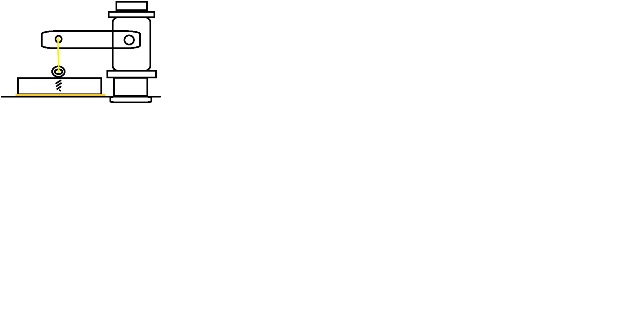

    I am planning to comply with the no discharge regulations (I always pump out anyway) by closing the discharge seacock from each head at the hull. Much easier to get to than the Y valves which are a bit confusing themselves. I am wondering how to secure it though. They say a wire tie or padlock, but I have Groco Seacocks and when closed the handle is at a right angle to the hose. I guess I could epoxy a wooden block to the hull and add an eye and use that to secure the handle in the closed position. Or, take off the handle which seems to be another way to comply, but I am sure later if I need them, I will be looking for them. Any suggestions?

    On my boat, I sank a 1/2" eyebolt into a 4" long piece of 1"x4". I used 3M 5200 to adhere it to the hull. Then you can run a zip tie through the bolt and the handle.
