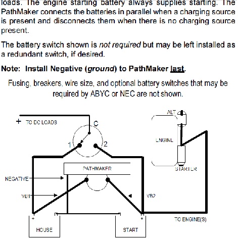

    In trying to remove the charger in the engine room, behind the main cutoff switches for engines, gen and house I found a Xantrex Pathmaker 250/2 24v item. It has a green, yellow and red light on it. The light is in the yellow mode and when I try to reset it will go to green until I release the switch and it goes back to yellow. Not sure what this device is connected to or whether it has anything to do with the Newmar battery charger? Anyone shed any light on this product and what it does?

    Okay what does a battery combiner do? Does it have any impact on the battery charger? I started the engines and gen and noticed that there were now two lights on the combiner. Red was flashing and yellow stead.
    Yes that is it. Pathmaker 250
  11. K1W1
    7,427
    Read the manuals provided by the posted links then if there are further questions post away. Right now no one knows if what has been offered in the links is what you actually have.

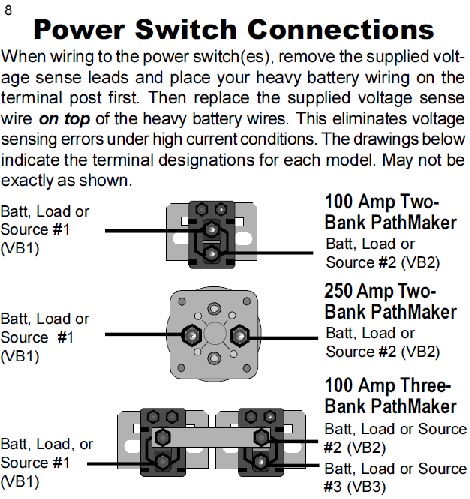

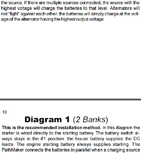

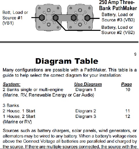

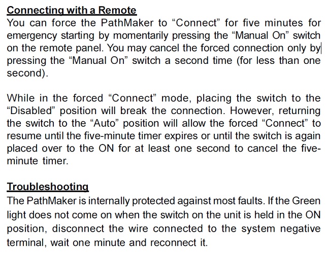

  13. Old Phart
    Old Phart Senior Member
    Mar 14, 2011
    1,329
    I dunno
    Just in case you are not able to download the PDF, here's some listed troubleshooting.
    Oops. Just noticed you were able to read the PDF.
    Maybe this will save some back and forth time.
