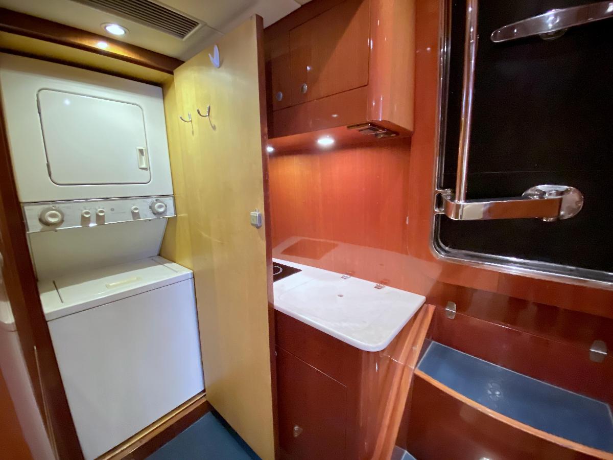

    We have a 24" over/under washer/dryer that's 20 years old. It still works, but is showing the years and I'd like to replace with new.
    There is no 24" wide access door to this location, so I'll have chop up the old one (not a big deal) but then also carefully and partially disassemble the new one to bring it in. Does anyone have experience with a particular brand / model that had to do something like this?

  2. Capt Ralph
    13,439
    That looks like your transom door?
    The enclosing cabinet has to come apart. New bungs and re-finish to put it back together.
    The aft door has to come off with the hinges.
    You want a bunch of young skinny strong stupid yard kids to move the equipment.
    What brand boat and have you talked with the factory yet?

    Yes, that's the transom door and it's well less than 24" wide. Removing the door/hinges will help, though, good tip.
    What do you mean by "new bungs" and is the re-finishing because I'm drilling out spot welds?
    Boat is Horizon. I hadn't thought about calling them because there's just no access and I really didn't expect a solution from them. They must have built the boat around the washer/dryer...
  4. Capt Ralph
    13,439
    Bungs on repairing the wood enclosing cabinet. You wont see any screw heads with wood bungs finished over them.
    With the transom door off, the unit tilted long ways on it's side, should fit out between the transom door hinge eyes.
    The cost of the new equipment is real cheap vs the cost of removal / re-install..
    Ya sure you want a new washer?
    Eager to hear what the factory says.
    On a Hatteras, from low mid-ship, we had to wrap in moving blankets, wearing hip & shoulder slings, kept it perfectly vertical to make the spiral stair case, then laid down & out thru the wheel house, galley, saloon, rear saloon door, over the cockpit & over the transom.
    It's in the owners hobby garage now.
    New Bosch equipment (2 pieces) went back in after a new closet was made for them.

    Back on the boat... the transom door is 23" wide if the door hardware is removed. However, the appliance itself is 24" and it's not going through there in one piece. There's simply no way to get a new 24" wide appliance into the boat in once piece.
    So back to my original question, does anyone have experience with disassembling a new washer and/or dryer and then reassembling them? I'm curious if one brand tends to lend itself better to this process...

  7. Capt J
    14,530
    The Whirpool apartment sized old school stackable comes apart pretty easy. What about looking into new front loaders, most of them will stack with a stacking kit and they make counter depth ones. That being said, you might be better off pulling a windshield and getting it out that way.

    Why are you planning to go to all this trouble given you said the existing machine still works? It doesn't look too bad from your photo. You can get appliance touch-up paint if needed. Your 20 year old machine will probably still outlast the new junk they build today. Besides, you can't hardly buy a washer/dryer today without waiting months to get it. You may wait even longer if you are particular about what make/model you want. I would spend my time and money elsewhere myself.

    I assume you are talking about inside the dryer drum. If it's real bad, you can take it apart and remove the drum. The drum can be either replaced or repainted with the baked on finish by a shop. You would be taking apart a new one anyways.

    I had similar constraints. Old one piece unit with out via sawzall. Bosch 300 Series in two pieces came back to replace. The 300 has a 23.5" dimension.
