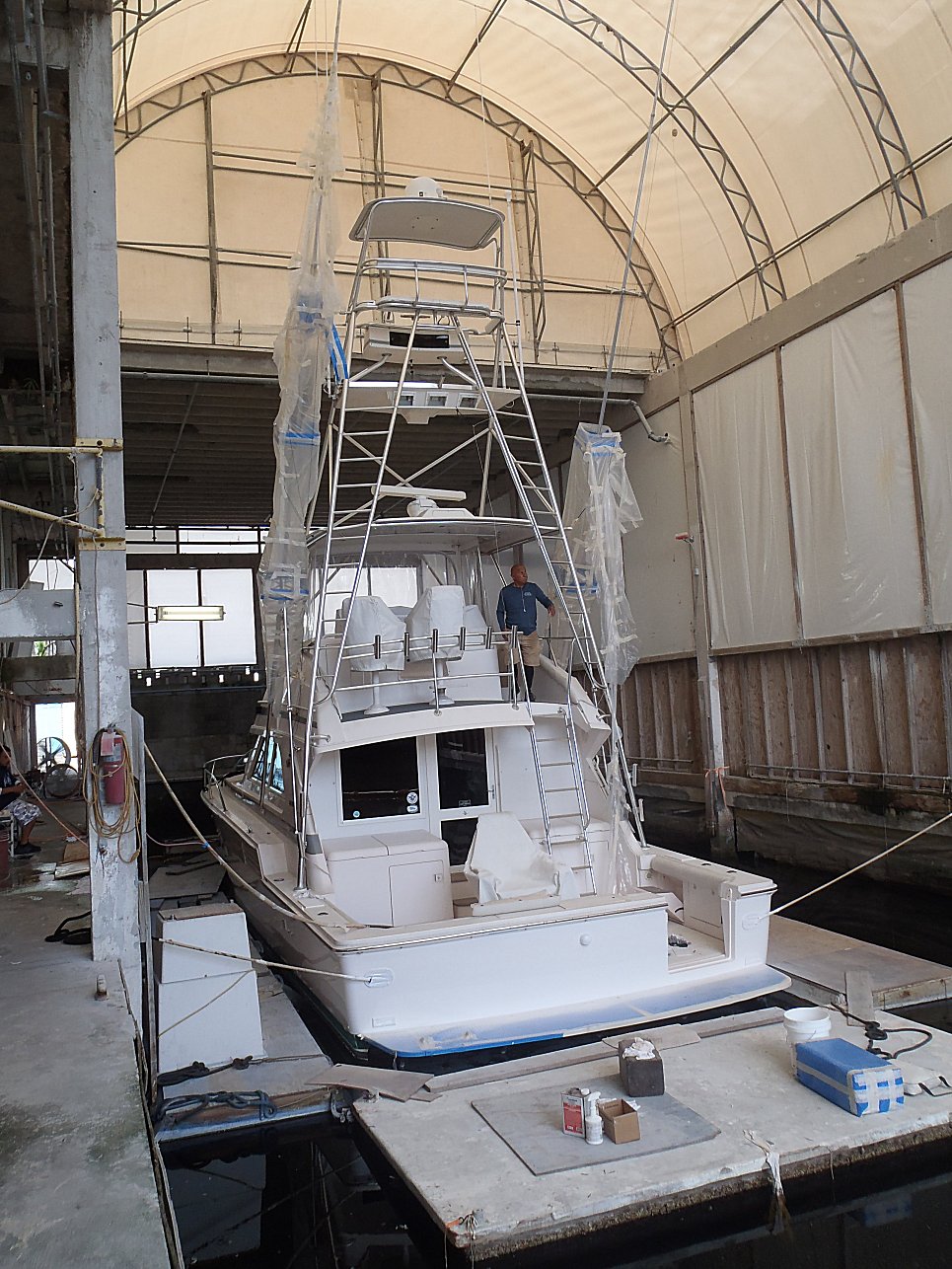

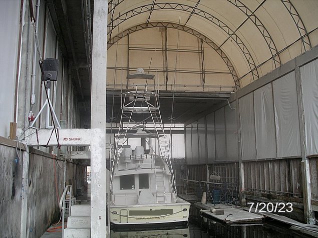

    Finally in the shed for white paint but concerned fenders will mess with it when back at my dock. Suggestions ??

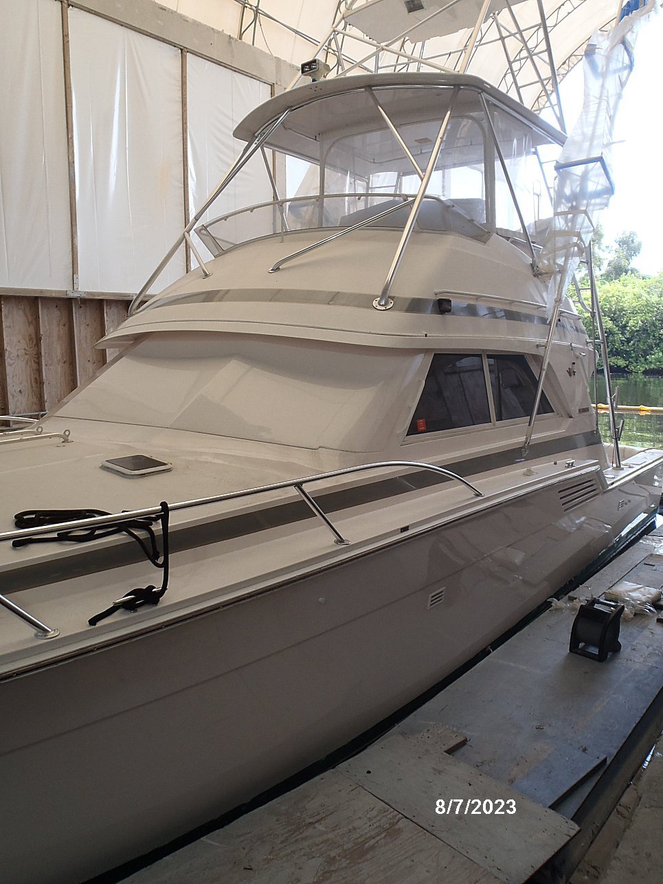

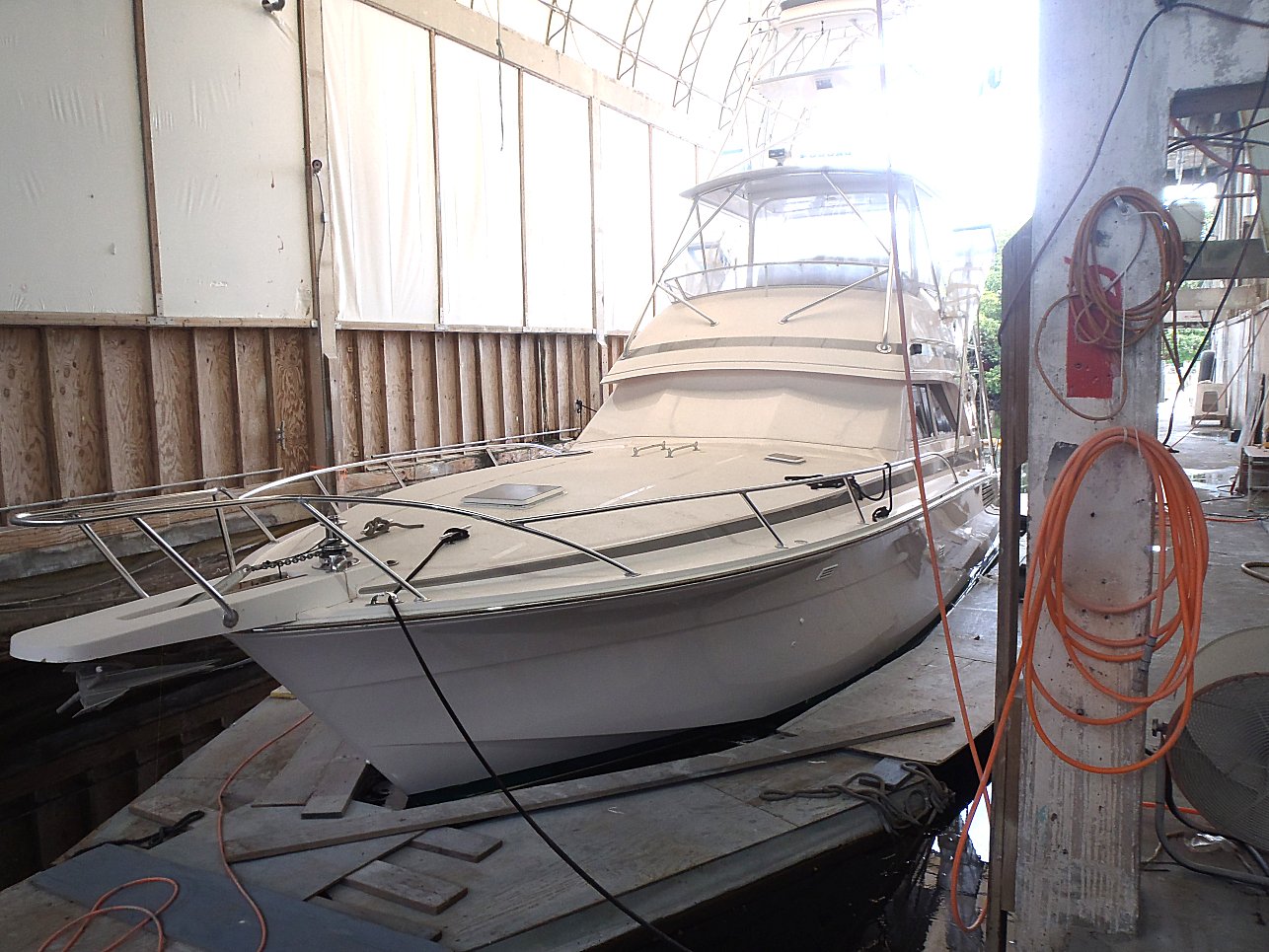

    Any pics? Ask them who sprayed your boat. My guess Freddy.
  15. SplashFl
    SplashFl Active Member
    Feb 2, 2021
    515
    S. Florida _ Bertram 46
    I believe so. I took a few photos when they were taking all the plastic off but as you know not the best light in the shed. Will get more tomorrow after they haul out probably today.
