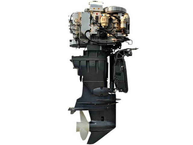

    THAT is very cool, it weighs about 100lbs more than the comparable 200hp Yamaha but the added torque and that 220amp alternator.... nice.

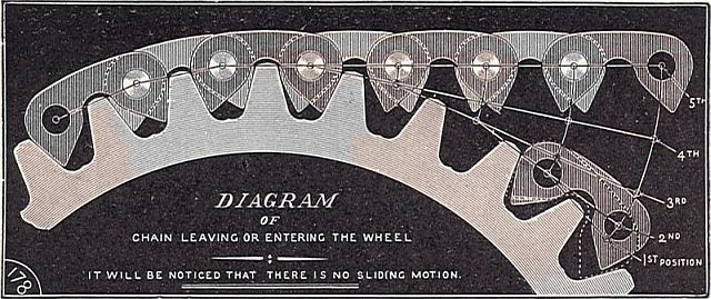

    I also wonder about their choice of the fiber belt, particular considering the length of that 'shaft belt' down to the prop, and the need to operate in both directions. At one point in the past I looked intently at the subject of belt and/or chain drives, and came away with the opinion that the 'silent chain' was the way to go. There was a subject thread on this forum that contained a number of postings I had made on this subject, but it got lost when the forum changed operating software.
    There is more discussion of this 'belt drive' subject over on this other forum, and I have tried to suggest to those participants that the 'silent chain' is likely the better choice:

    year 2011 At one time I was doing quite a bit of study of this subject in anticipation of producing some units...maybe over in Asia. But the boat market is less than well at the moment, so I'm not pursuing that subject at the moment.
    I started out favoring the idea of toothed belts over chain. But over a period of time I came to the realization that the silent chain approach made much more sense, and would be easier to implement. This is particularly true when you start talking of HP greater than 20-30.
    If you start looking thru the tables of pulley diameters (minimum dia) recommended by the belt manufacturers for specified powers transmitted you will find the diameters of the pulleys getting quite big which might require thicker struts, and all of this interfering with the prop...etc...etc
    ...or more complicated dbl struts and split housings, etc.
    http://www.ramseychain.com/faq.asp?id=9
    How does Ramsey Silent Chain compare with belts?
    Silent chain drives compared with belts:
    Higher speed and power capacity
    Detachable and therefore more easily installed
    Greater efficiency
    Larger drive ratios possible
    No slippage
    Higher drive ratios at short center distances
    Less affected by temperature or humidity
    Lower bearing loads
    Less affected by oil or grease

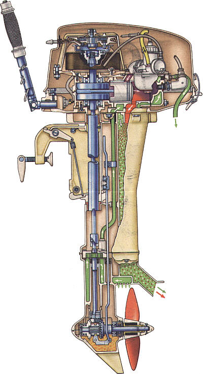

    Below the mechanical principle of a simple outboard engine as known by most of us.
    One angular gear on the prop shaft which also does the shifting.
    The the solution is very clear and easy. Horizontal engine with belt or chain drive (if long lasting and reliable) or a light and small vertical diesel engine with shaft drive.

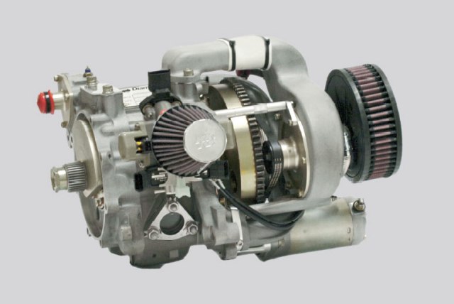

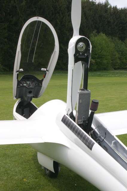

    This normal aspirated 50 HP engine is so small and low weight, that I am able to unsrew the whole propulsion system from my Glider in less than 5 minutes and carry it away with one hand (including beltdrive and propeller tower). Even if the weight of the engine would double with the diesel principle, it would still be a very small and light outboard motor.
    But if somebody would give me the appropriate battery, I would only use one of those electrical outboard engines in the future :). SF I Know.
    Will say, the Oxe diesel outboard engine depends crucially upon the performance and reliability of the belt drive system.
    Just my 2 (Euro) Cents

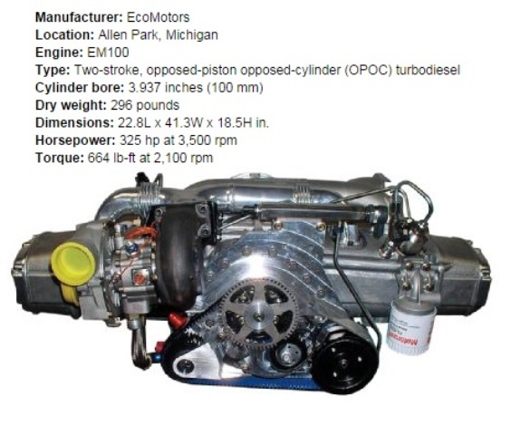

    OPOC means opposite piston, opposite cylinders and is the newer development of the old German pre WW II Junkers aircraft double piston diesel engine (Junkers Ju 86 and Stuka). The OPOC version, which has only one crankshaft, was developed by Volkswagen and as far as I know, is in a stage of protype testbed runs. And it is developed in a petrol and in a diesel version. Pretty complicated thermodynamics from what I have been told.
  17. HTMO9
    HTMO9 Senior Member
    Jan 13, 2009
    1,682
    Found this about the present state of delopement of this OPOC diesel engine. The project moved to the US. Looks like it is hitting the market with these investors behind.
    www.ecomotors.com
    Smaller and bigger versions are under developement. Looks like a nice engine for light aircraft. May be the 2-stroke engine is back and alive.

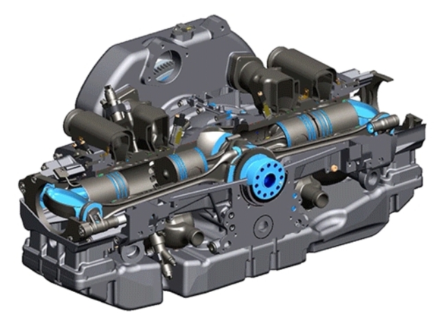

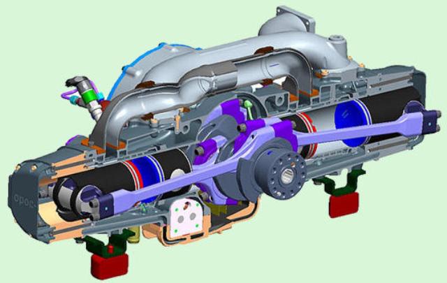

    I thought these characteristics were interesting:
    http://www.ecomotors.com/opposed-piston-opposed-cylinder-engine
    Opposed Pistons (op) – Piston Speed & Size
    There is a practical limit to piston speed, above which engine performance begins to suffer from things such as increasing friction. Piston speed is related to the distance the piston must travel. In an opposed piston (op) engine, each piston travels about half the distance of a piston in a conventional engine, and travels at about half the speed. It is desirable to design an engine to operate near the piston speed limit. So, when an opposed piston engine is designed with the same piston speed as a conventional engine of the same specified power a very good thing happens – the size of the engine can get dramatically smaller (as measured by the required volume displacement of the engine).
    Opposed Cylinders (oc) – Friction & Efficiency
    By orienting two identical cylinders, each containing two opposed pistons, symmetrically around a central crank shaft, the forces generated during engine operation are almost entirely balanced. One result of this opposed cylinder (oc) architecture is very low bearing loads, which leads to less friction when compared to conventional engines that do not run in such a balanced fashion.
    The long outer connecting rods of the opposed cylinder architecture contribute significantly to lowering outer piston side loads. The lower the piston side loads the less the pistons tend to rub against the walls of the cylinder, and thus the lower the friction in the system.
    When friction goes down, fuel efficiency goes up.

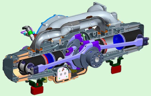

    Wonder if that engine could be operated in a 'vertical fashion',...that is with the crankshaft in a vertical stance??
    (I've just written them a email asking this question)
