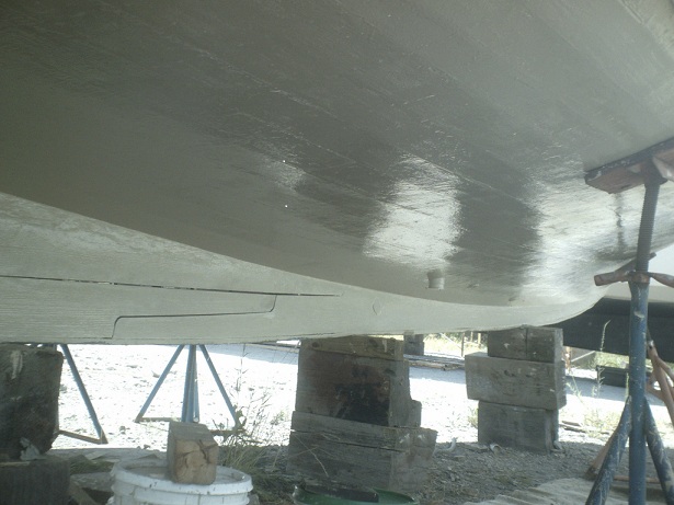

    Water Based Antifoul Paints
    Since the fall of '07, this writer and her husband's boat has been part of a bottom paint study to test the efficacy of the biocide Econea, an eco-friendly product produced by Janssen Pharmaceutica and sold to different paint companies. Three paints were applied to the bottom of our Crealock 37 — one control paint containing 67% copper, one solvent-based test paint and one water-based test paint. After a year, the water-based paint, in our opinion as boat owners, was not only the best among the three, but the best paint we'd ever used. There was zero hard growth on all three — which made them equally 'successful' in the eye of study coordinator Jack Hickey, as that is the study's primary focus — but the water-based paint had very little slime or grass. The other two were mini-ecosystems unto their own

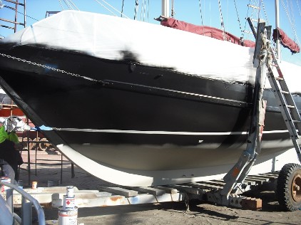

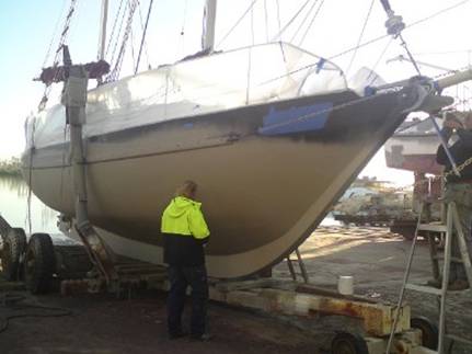

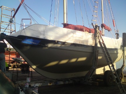

    Unhappy Steel Boat Application
    Ran across this unhappy application
    NOTE: I have written the Sani-Tred company an email and asked for an explaintion.

    I got an answer, and a pretty complete one at that. Here is what I ask of them:
    Sani-Tred Technician's Reply
    I was able to pull up the customer’s info. The web page/blog you referred me to had the name “Kerry & Claudia South Australia” on it so I searched for those names and cross referenced to that location (Australia).
    We show one order for Kerry and that is all.
    I was able to find the customer’s email address in our records so I searched our previous correspondence. I found several emails from this customer regarding their application and the source of their problem. They stated that they sand blasted the steel, deliberately let it sit for days to form a powdery rust film then began applying the PermaFlex over top of the powdery rust. THAT is precisely why they had delamination issues over the majority of the hull. Sani-Tred products come with application instructions and the customer deliberately chose to NOT follow them. The customer even specifically asked us about the sand blasting and we sent them a step-by-step tutorial. What they did was follow some other written specification from another company that recommends applying over top of a powdery rust film. Our customer did NOT contact us to ask if this is recommended or what would happen if they prepared their substrate in the manor that they chose (which contradicts with the tutorial and application instructions we supplied.
    When we explained to the customer what they did wrong and why they are experiencing this delamination they became very upset. They became bitter, slanderous and their blog is in no way accurate.
    Based on what their own blog states, and I quote, “We contacted the manufacturers and, according to their instructions and specifications, cleaned the hull and recoated”. They used the words “manufacturers” meaning plural. They were still in contact with the other company that supplied them with the information regarding the method of preparation that caused their problem to begin with (not us)! We can only assume that this other company supplied them with info regarding HOW to reapply. We have absolutely NO correspondence with our customer regarding any ‘reapplication’. Keep in mind that they only placed ONE order and that order was NOT for twice the amount that they originally needed. In their blog they claim that their ‘reapplication’ delaminated as well. We have never received a single complaint, photo, email, letter or any contact regarding a reapplication.
    Just for fun I’ll assume that a ‘reapplication’ was performed. Where did they purchase the materials? What materials did they use? How was the reapplication performed? How did they prepare the substrate for the reapplication? I have a theory about that … and keep in mind that this is just a theory based on what I see in their photos. I bet that they sprayed the PermaFlex on the hull for their original application. Notice how the boat was masked in the photos in the blog. They used sheet plastic and it appears to have been sprayed. I do not see any brush or roller marks, I just see overspray
    If they sprayed the PermaFlex, it is highly likely that they sprayed ‘airless’. We spray ‘air assist’ and have abandoned spraying airless many years ago. When spraying PermaFlex using most common airless units it is typically necessary to thin the PermaFlex to a very low viscosity or you cannot obtain a spray pattern. When any material is of very low viscosity that material WILL lack vertical cling. In other words the material will be very runny and lose its ability to be applied at the proper rate to a vertical or inverted surface in a single application. Additional coats MUST be applied in order to compensate for the lack of vertical cling. If this is in fact the case then this is another mistake they made during the application and by spraying PermaFlex in this manor it would stand to reason that they would have lots of PermaFlex leftover (by being applied way too thin and not at the proper rate/thickness) in order to have enough material on hand for a reapplication. If they reapplied by spraying it in the same manner as the first time then this could very well explain the problem they had with their alleged ‘reapplication’.
    If a customer does not call and ask questions before the application and assumes something other than what the application instructions state to do will work, we cannot assume responsibility for what he does and how the application turns out.

    UPDATE:
    Question:
    Sdowney, can you give us an update on how the permaflex is preforming as an antifouling paint?
    Reply:
    Sure, It is not an effective antifoul coating If you dont brush them off when small.
    I have lots of barnacles. The coating is undamaged, barnacles dont affect it.
    I think it has been a couple of years now.
    This was a test and the boat mostly sits.
    At first the barnacles were small easily removed simply with my hand, meaning no sticking. Easily brush everything off using my hands.
    I just left everything alone to see what hapens and now some barnacles are about an inch and stuck on but can be scraped off with some effort. I was thinking of getting in when the water warms up and use a WOOD scraper made from oak to clean the hull and see what happens. what ever you use to clean with cant be sharp metal or you likely would cut the permaflex rubber.
    Permaflex is acid proof so If I haul the boat, I will power wash, scrape, then spray HCL muriatic acid to dissolve anything left.
    A sheet piece of permaflex I had in the water as a test grew some barnacles.
    When they got to about a half inch I pulled the sheet and when I rolled it they popped off completely intact. Sort of peeled them off. So the barnacle's bottom was there and it is slightly concave. I think these things are sticking to the surface like a suction cup, but they dont harm the coating.
    So If you were prepared to get in the water and scrub the boat once a month this would work ok. The bottom is basically dirty. This coating would require someone to periodically expend some effort to keep the surface clean.
    some pictures showing intact peeled off barnacles etc
