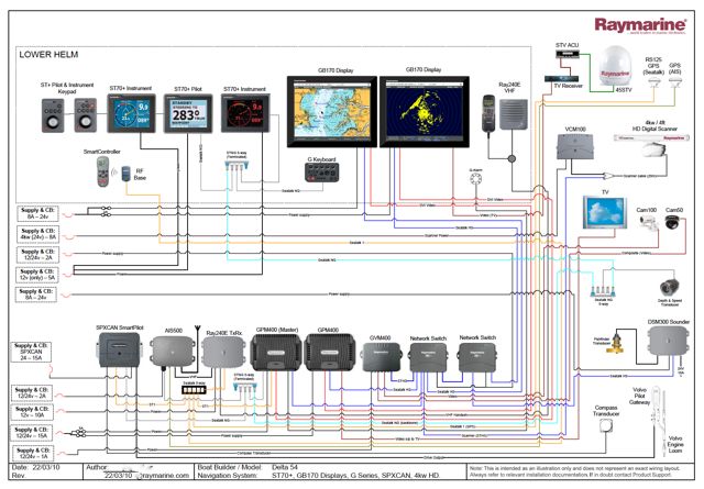

    We have used Raymarine in most of our boats for years and is now installing it in the new D54. This system has two Glass Bridge 17" monitors and a lot of "boxes" connecting all of it. We will soon see if it works...

    it's the "lot of black boxes" which scares me... I'm sure there are failsafes and hopefully one failure will not bring down the entire system but i still dont like having all my eggs in the same basket.
    and with increasingly complex systems, software bugs become a concern as well...
    on smaller boats with limited helm space, integrating all the data on one display make sense otherwise I prefer having different independent systems. for instance, why would you want the sounder data to be displayed on teh same screen as your GPS or radar data?
    I think the "cool factor" is often too important in the decision process.
