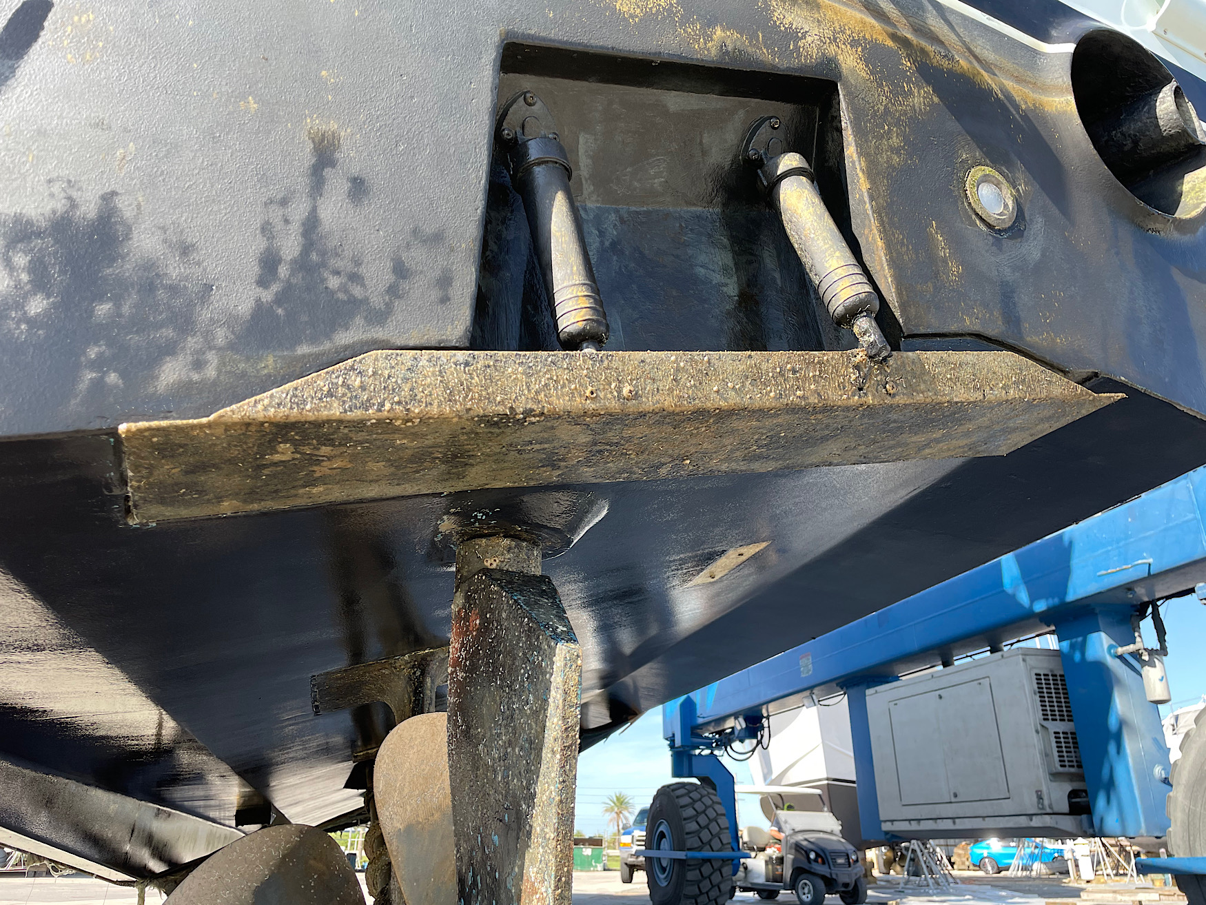

    The tab actuator arms are slightly recessed into a pocket in the transom, but the tabs themselves are mounted flat on the hull. The net effect is that there is slightly less wetted surface on the side with the missing tab - maybe 20” x 1”-2” (pic attached)
    I suppose it’s possible that there is some sort of instability created by this, but it seems quite small in relation to the overall wetted surface.

    I’m 99% sure it was the missing trim tab on the stbd side creating an instability in lift at the back of the boat while on plane. Took 6 mo to get it replaced (thanks Bennett) - splashing the boat in about a week and will be able to verify.

    Verified - the problem was the missing trim tab all along. With both tabs installed again, the boat runs beautifully, autopilot holds course as it should, no weird squirrelyness
