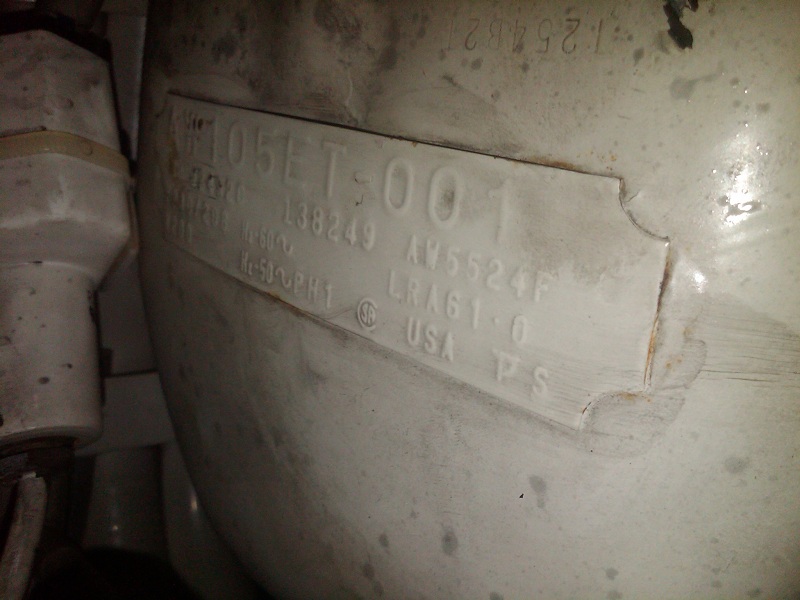

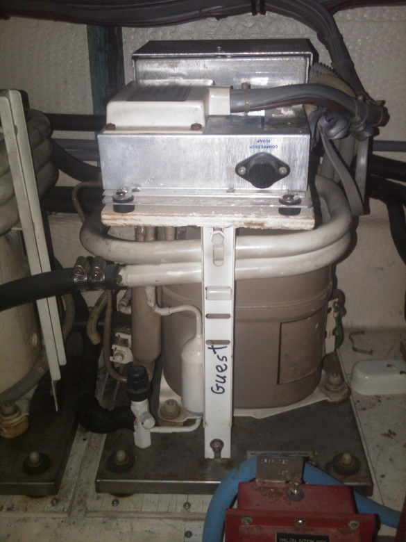

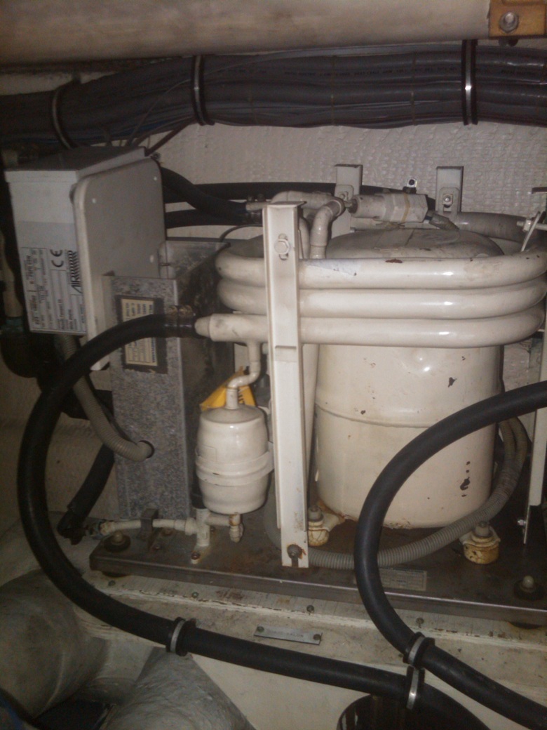

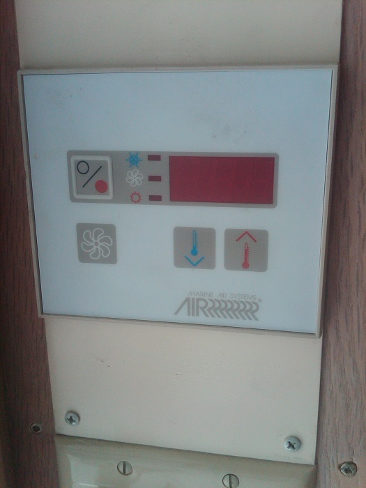

  18. CTdave
    CTdave Senior Member
    Mar 21, 2004
    876
    Greenwich CT/ Stuart FL
    I'll post all of the numbers in a moment

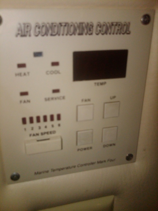

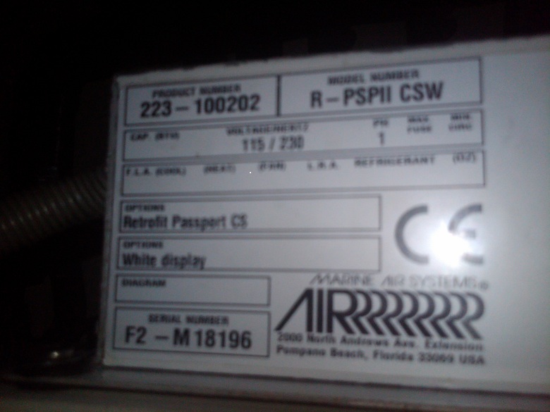

    Control for 12,000 btu salon
      79.9 KB
      460
  20. K1W1
    7,427
    I wouldn't worry about that last photo.
    We are using a black version of that that doesn't have the Marineair Symbol on it for the ECR AC on a boat less than 12 months old.
