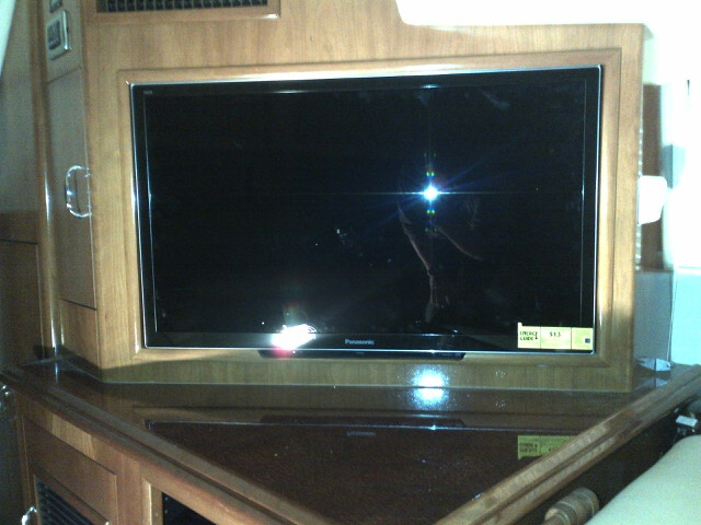

    I wanted a bit bigger TV in the salon of my 466. It came with a 30" lcd, but my vision isn't what it used to be. We watch movies in the early and late part of the year, and sometimes when on a long trip and we're just too tired to do anything else.
    I looked around for a TV that would fit into the spot, and found a Panasonic 37" that just about fits. It needed some customized mounting, and the frame needed a bit of trimming to make it work, but the result is fantastic.
    This new TV looks more factory installed than the original!
