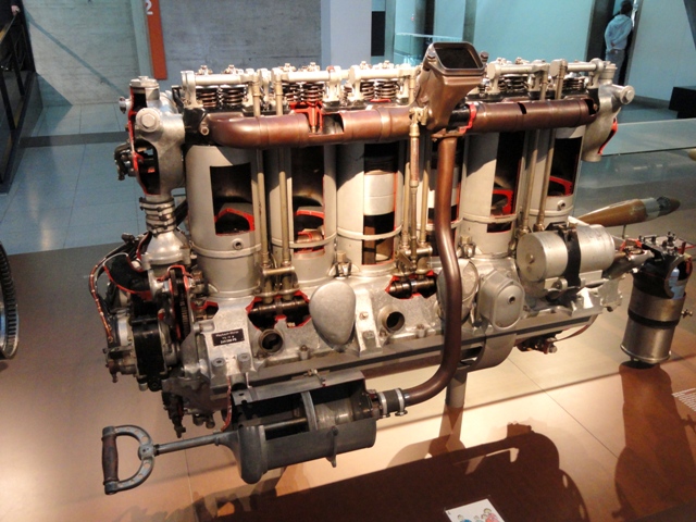

    Blimb motor
    Hi, Caro,
    I believe the MTU (even the old S60) engines have evolved a little bit since her blimb age. Not much but a little bit. I am not sure about Lugger :D.
    And I do not believe MTU is guilty for the S60. If I remember correctly, they found this engine in store, when they took over Detroit Diesel (This great engine was one of the reasons, they bought that company).
    The great thing on that engine for marine use is, that you can buy it in an left hand and right hand version (turned heads), in order to have the service sides, in a twin engine installation, to the most convenient side.
    Below a real blimb engine from 1915, when they were still called Maybach.
