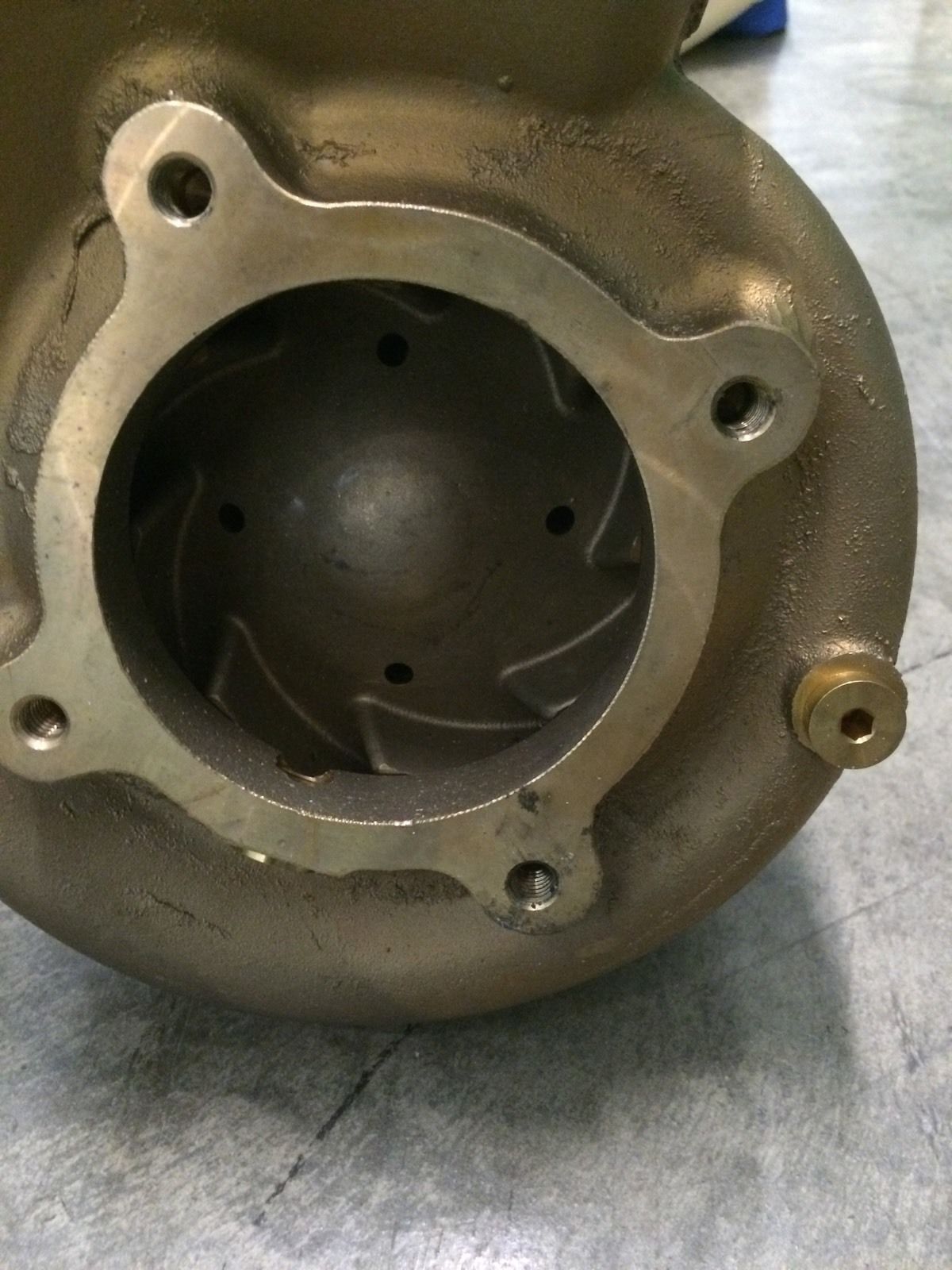

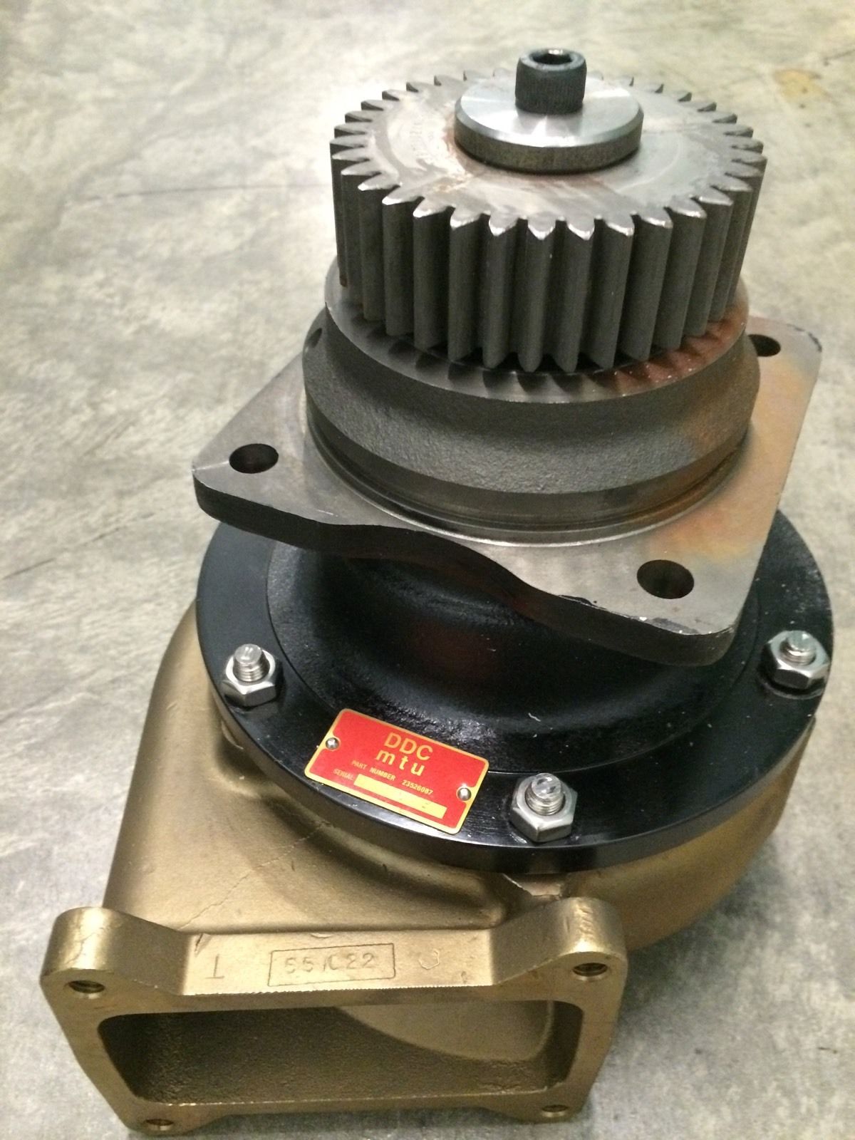

    The part number from Mtu is 23526087. Detroit/Mtu parts department says they only available as a complete unit at a cost of $5500. I have one that just started leaking raw water and the other one has been leaking oil slightly. Its crazy that these pump are considered disposable.
    Mtu 12v2000
    s/n 5352002207

    13,427
    Interesting. Same pictures from several old e-bay listings.

    All I can find that show what they look like clearly.
