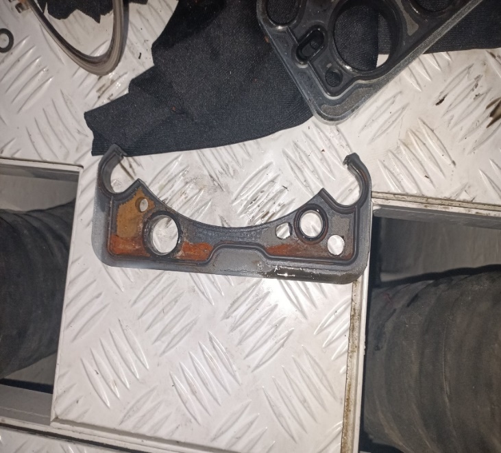

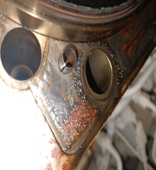

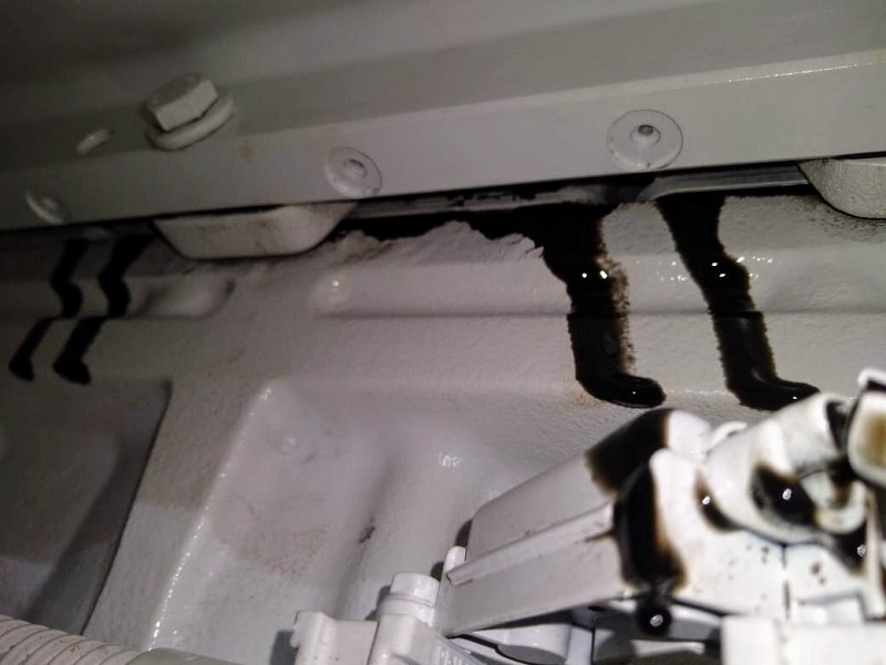

    Gentlemen .... good evening,
    Three cylinder head gaskets in the same cylinder bank on a 2016 MTU 12V 2000 M94 engine failed which led to a severe oil leak as seen in the image below. The engine has 800 operating hours. The engine diagnostic data which was read by the local MTU dealer showed no engine overheating and no engine overload which are usually the reasons behind the failure of cylinder head gaskets. The local dealer is unable to explain the cause of the failure.
    The cylinder head was dismantled and traces of mild corrosion were seen on the cylinder head gaskets and on the surface of the engine block as seen in the attached images.
    I would appreciate hearing from anyone who has experienced or heard of a similar failure and can explain to me the cause of such an unusual failure.
    Thank you.
    SL86-656 Cylinder Head Oil Leak (1).jpg SL86-656 Cylinder Head Oil Leak (2).jpg SL86-656 Cylinder Head Oil Leak (3).jpg
  2. NYCAP123
    11,205
    My guess would be not torqueing down the bolts properly.

    It would make absolute sense given the circumstances. In fact it would make sense for everyone to do but I've never heard of it happening. I doubt there's any claim to be made on this, but it should serve as a lesson to all to not just live with oil leaks. Had the gasket been changed when the leak first developed that probably would have been the extent of the damage.

    Check the deck of the block and make sure it’s straight. It sure seeems like that ring area in the second photo is raised higher than the rest of the block. Could the engine have gotten really cold at some point in time?

    Capt. J, what do you mean with an engine "getting cold"? If you a referring to freezing temperatures, in our part of the world it is never cold. Even winter temperatures are relatively high. Night time winter temperatures are never less than 60 degF.
