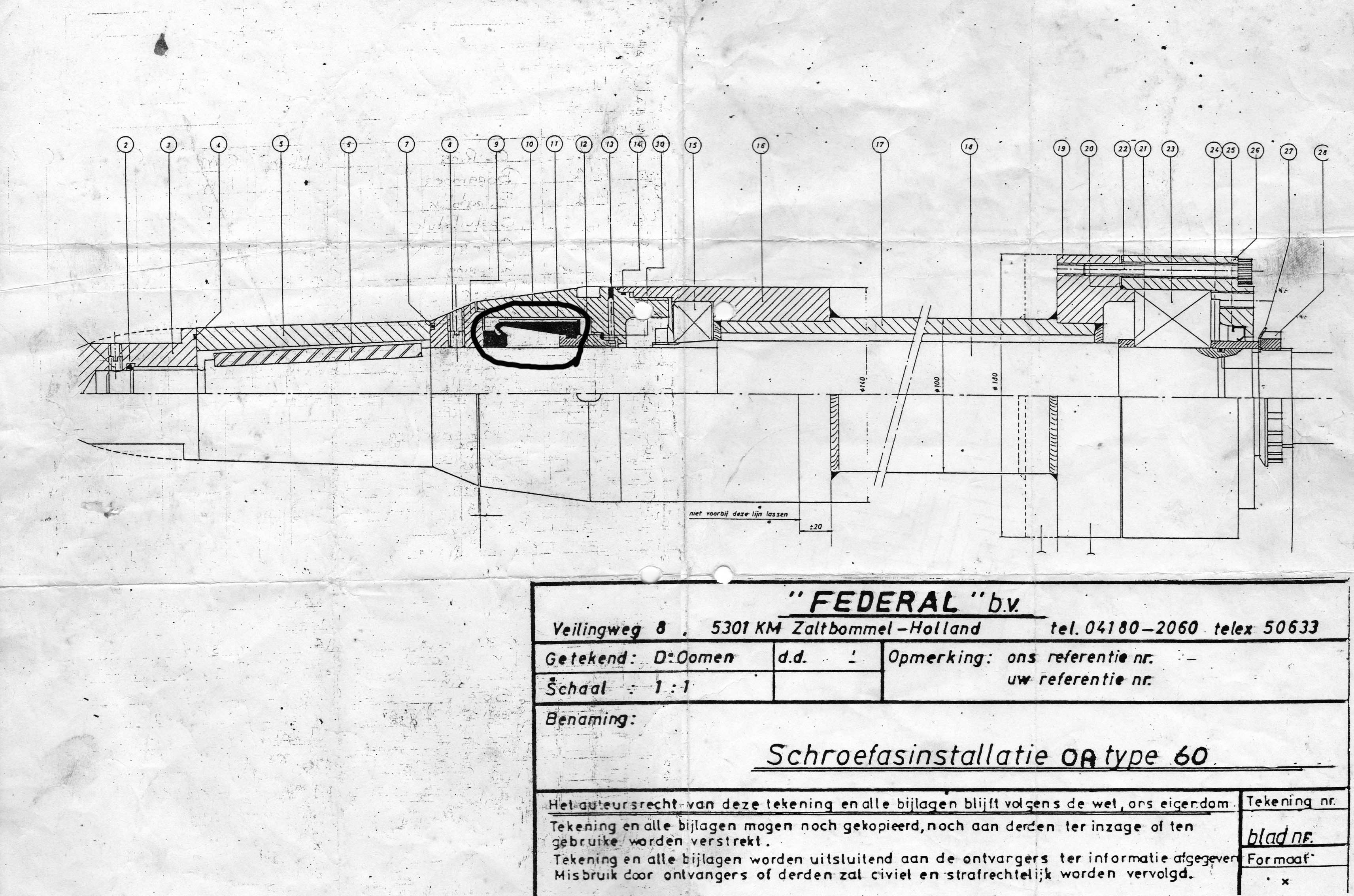

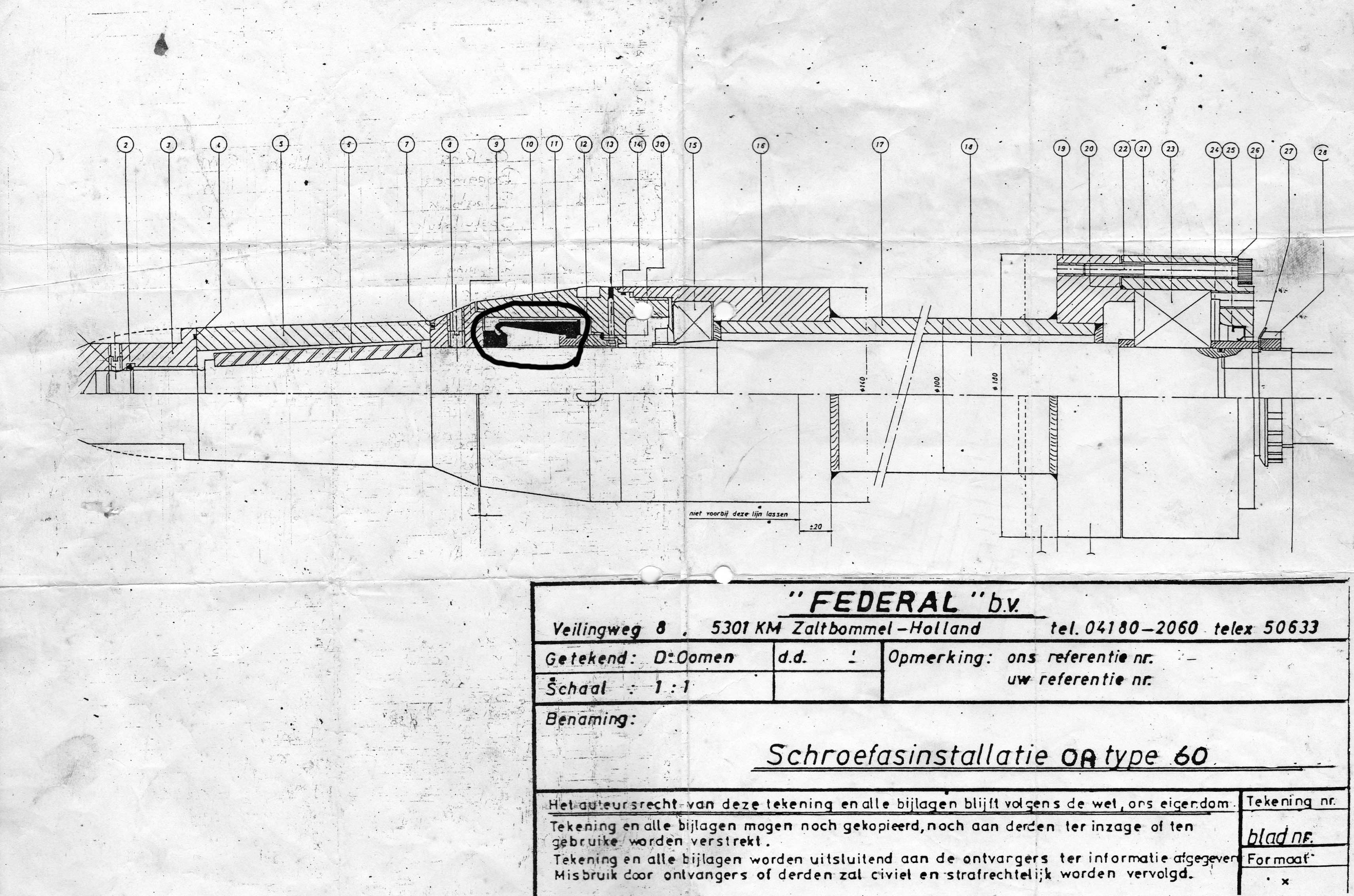

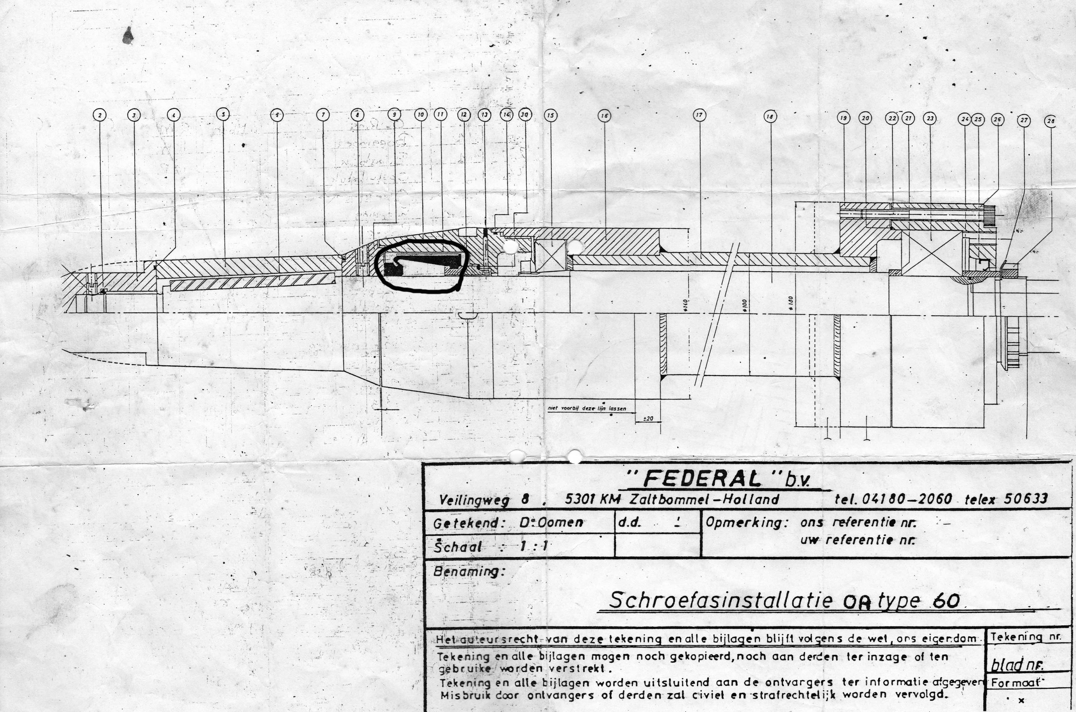

    I wonder if there is anyone who has an experience/advice regarding refurbishing of the aft seal of stern tube. The technical drawing is attached and the seal marked. Thank you in advance, Pit
  2. K1W1
    7,427
    The seal on an oil filled stern tube is easy enough, getting the hub nut off is going to be the tricky bit

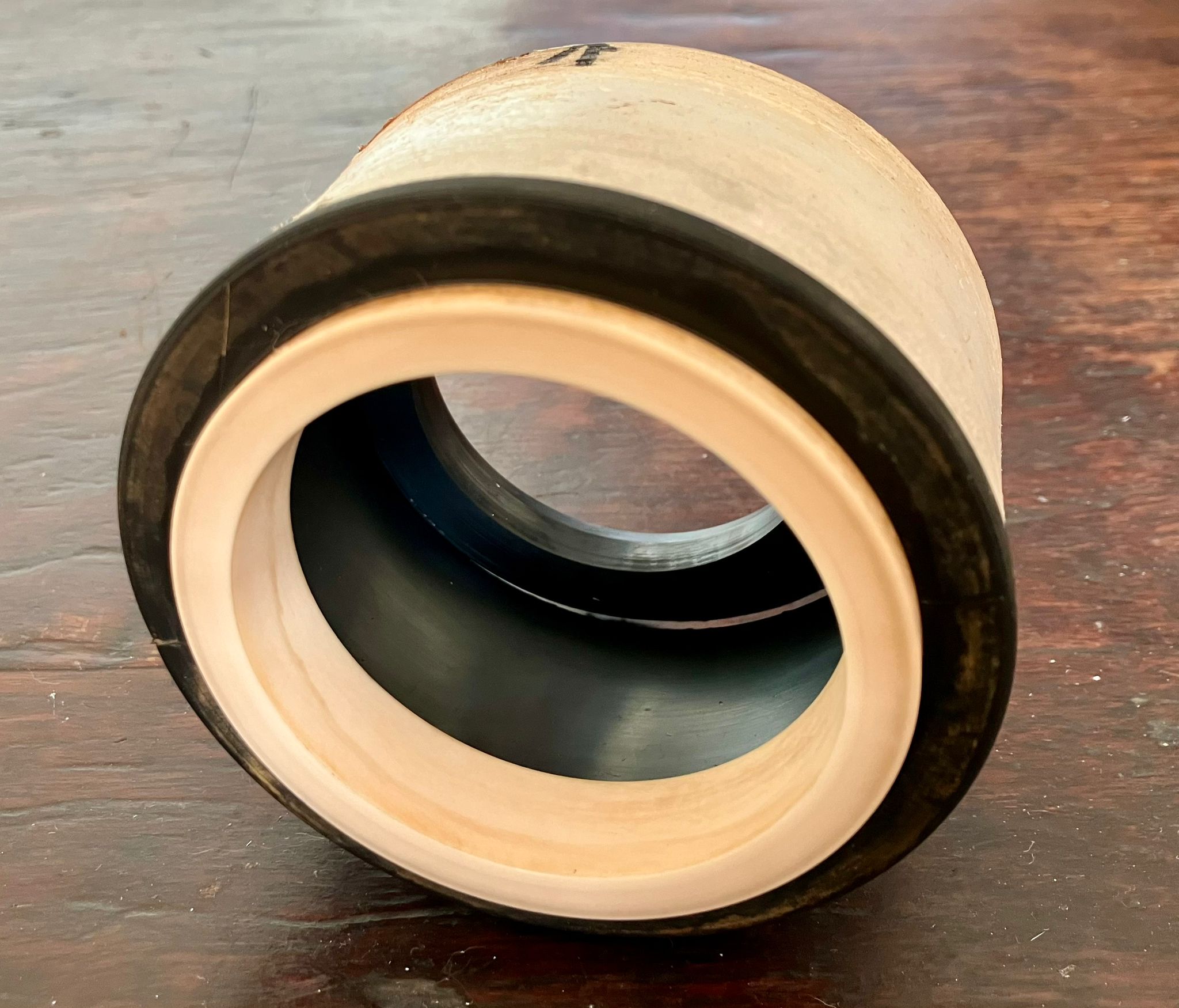

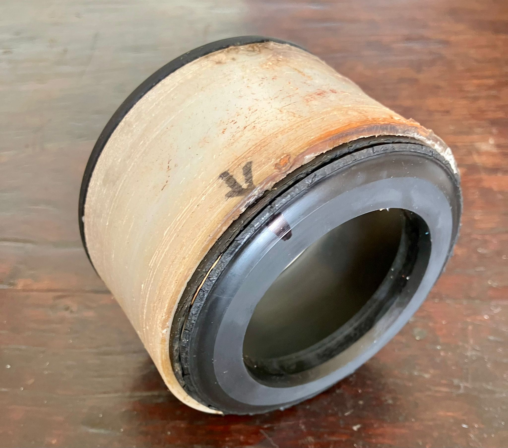

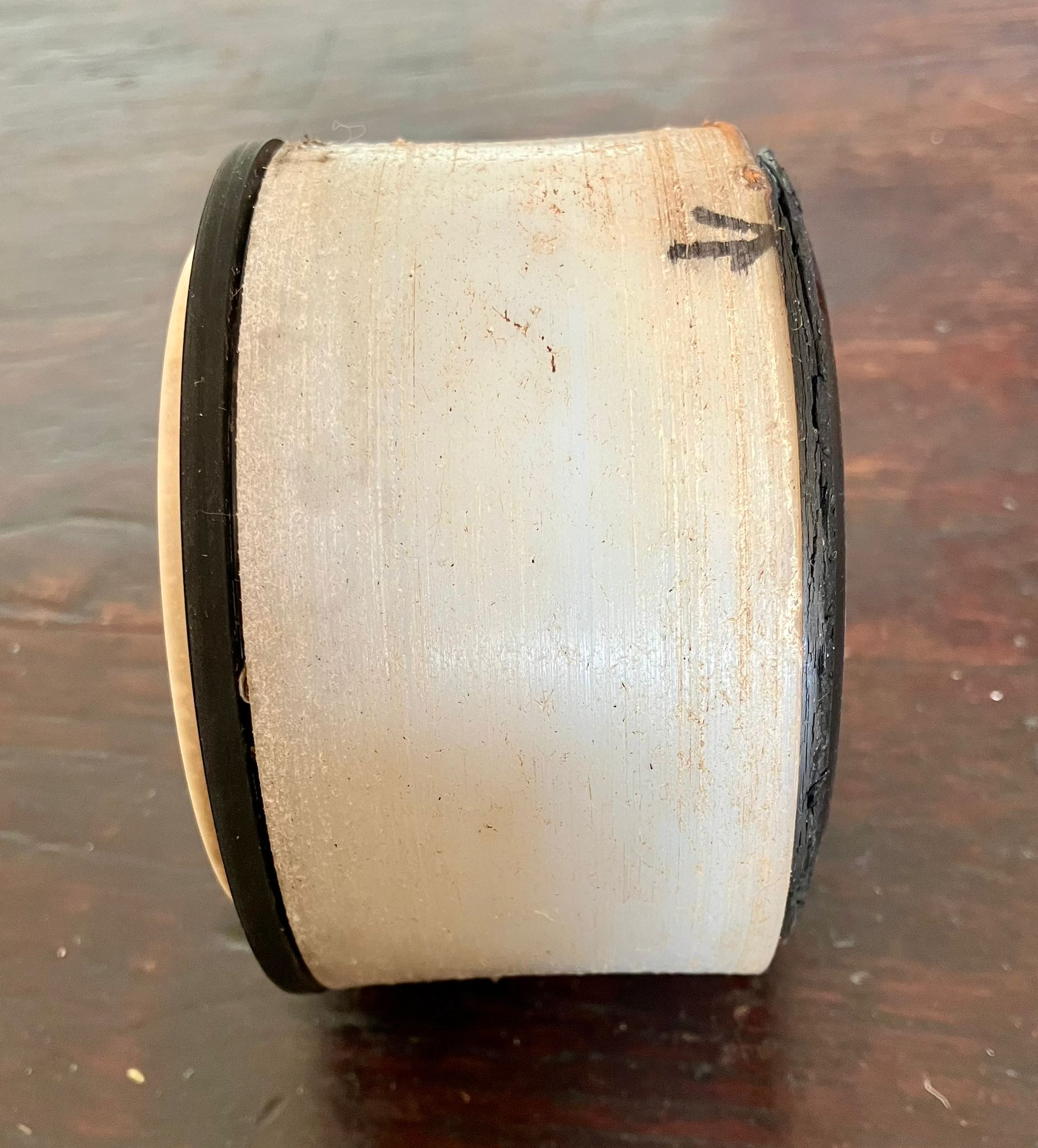

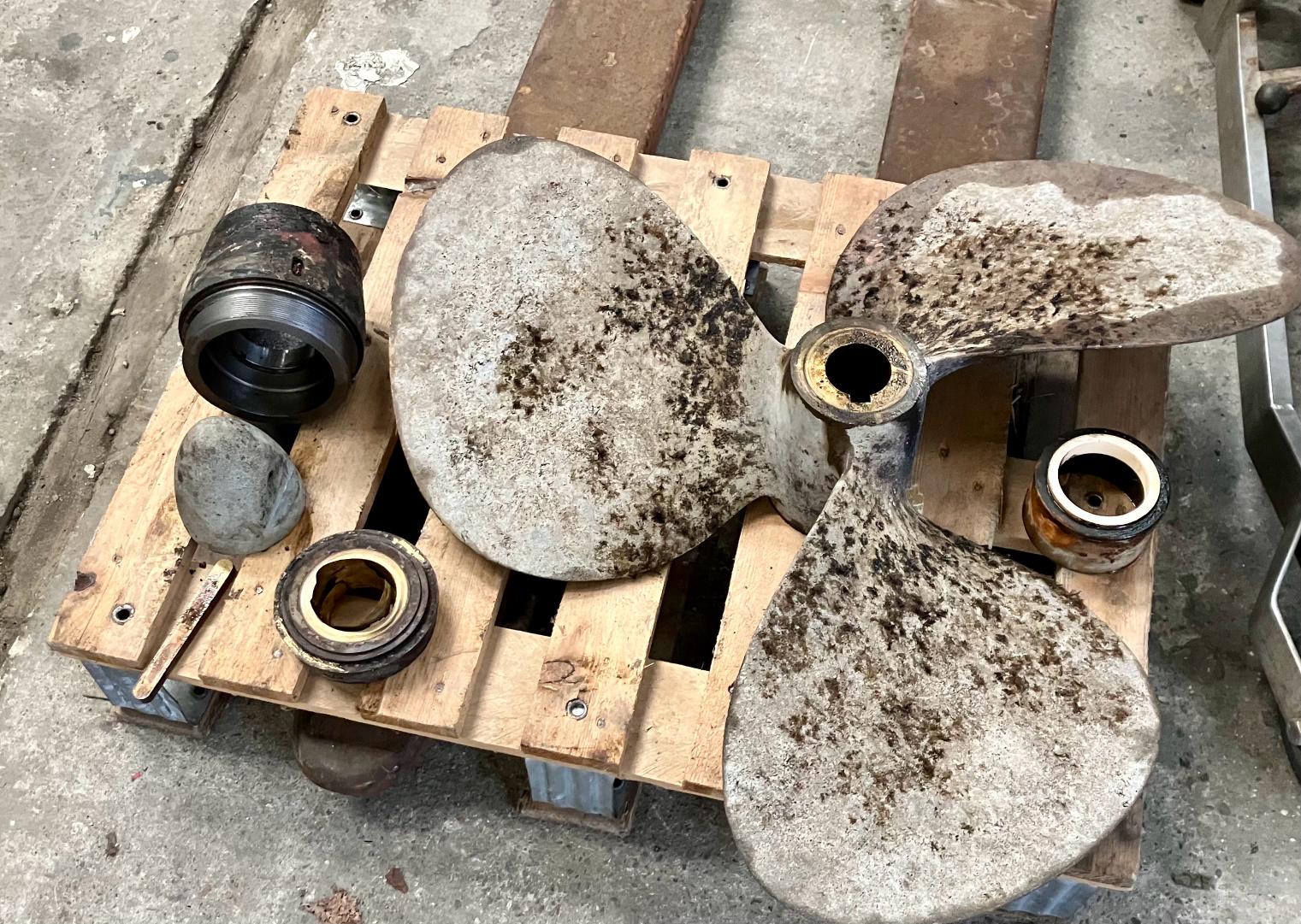

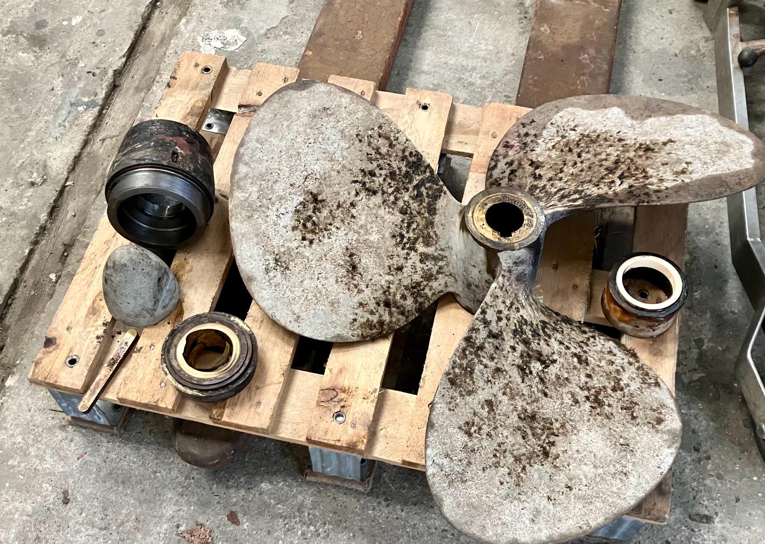

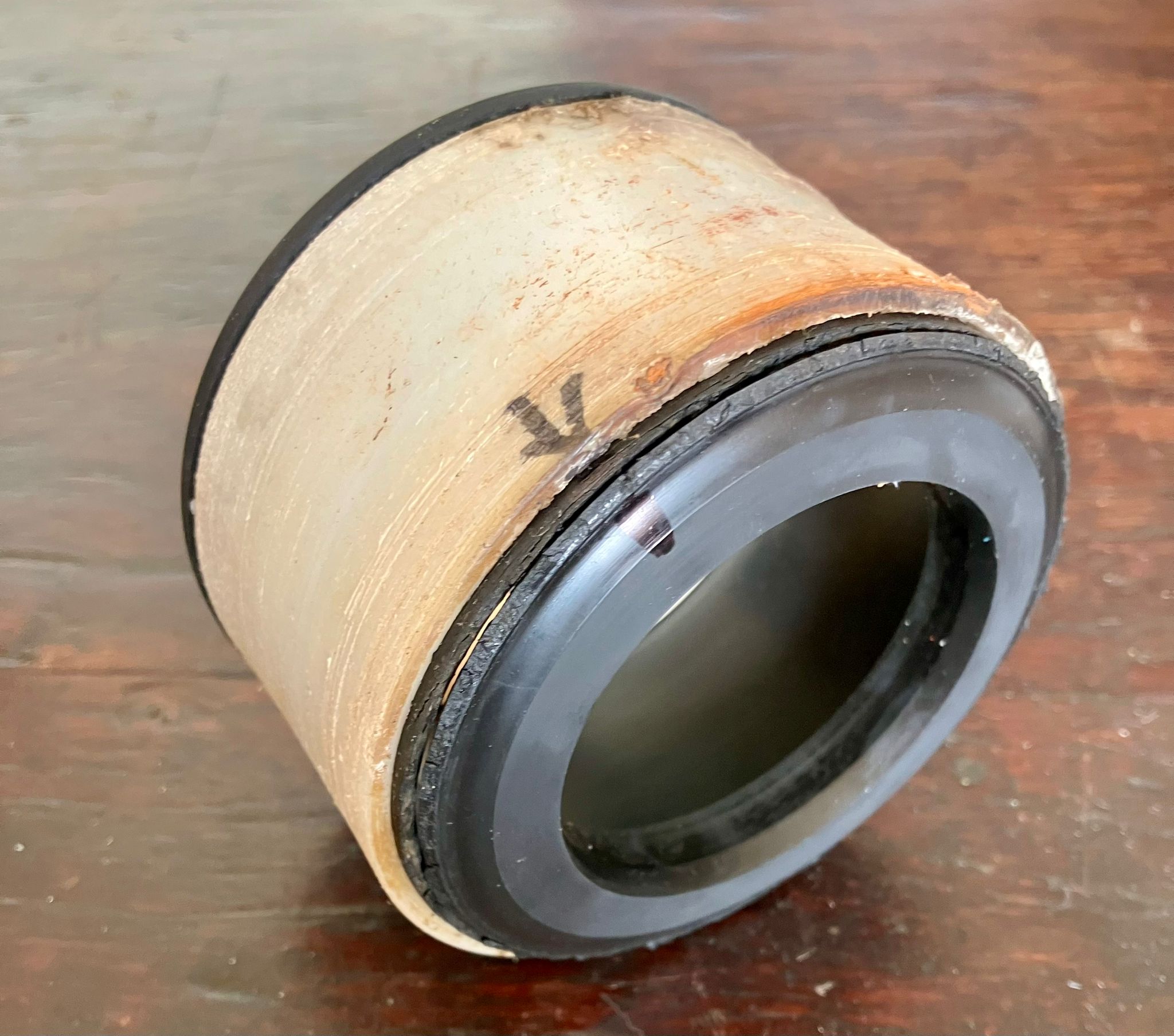

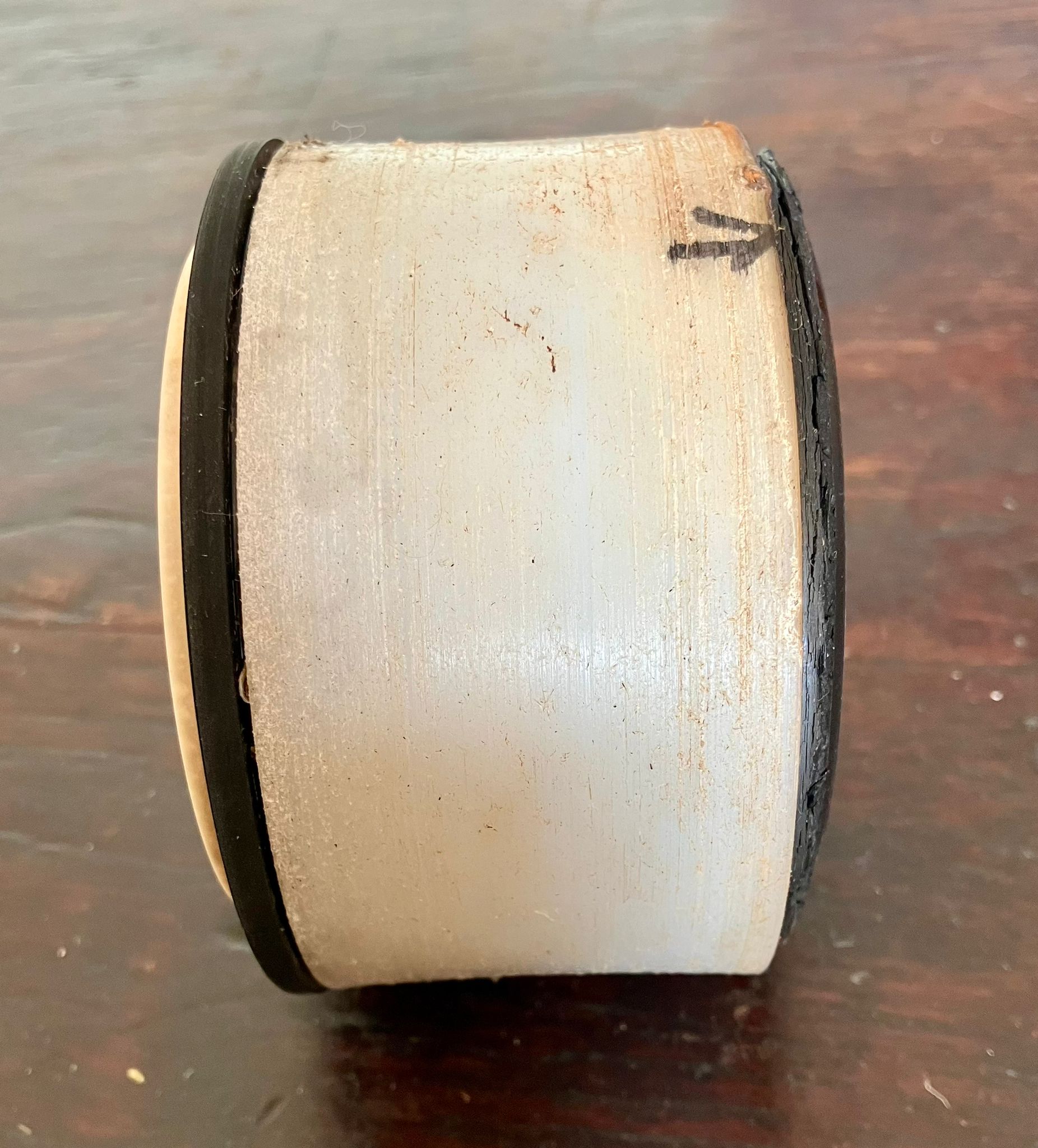

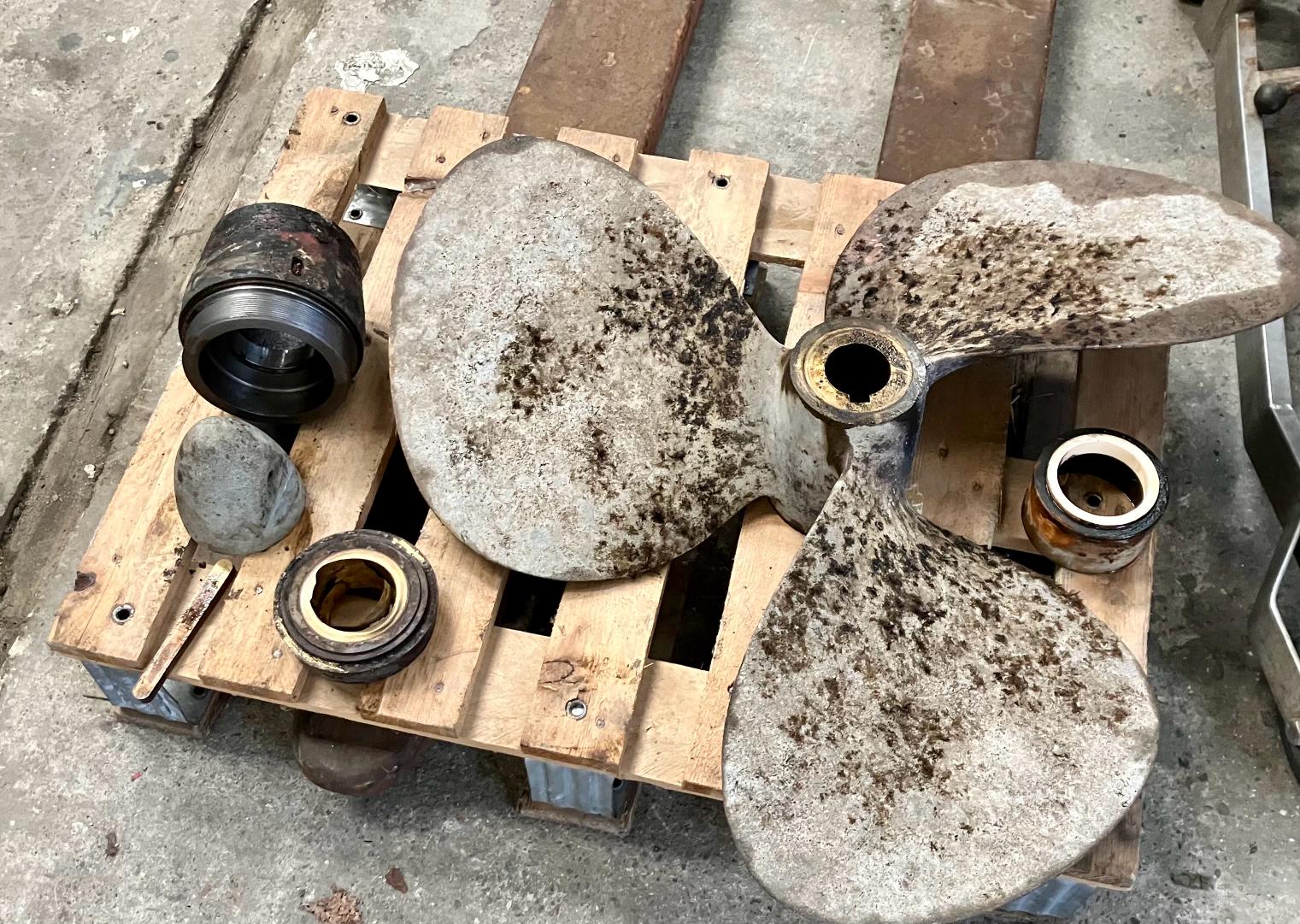

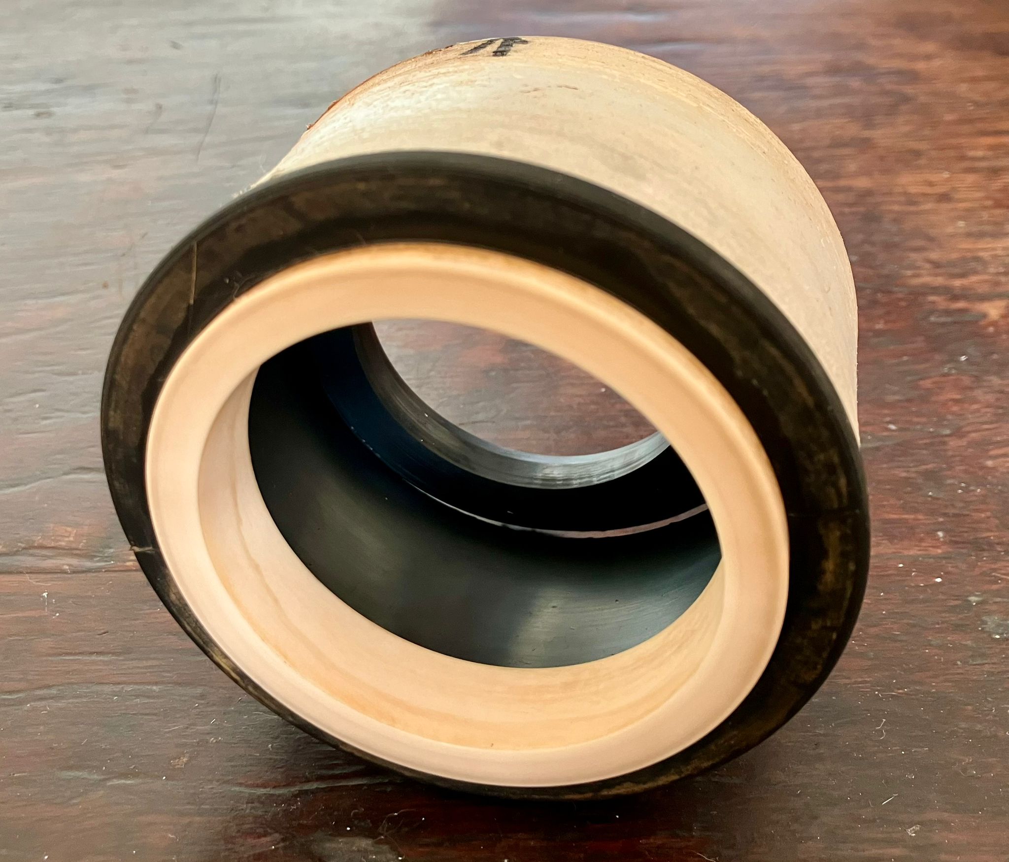

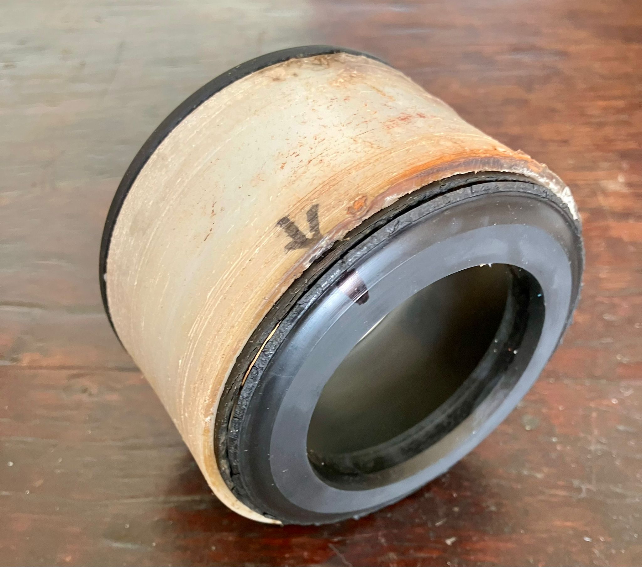

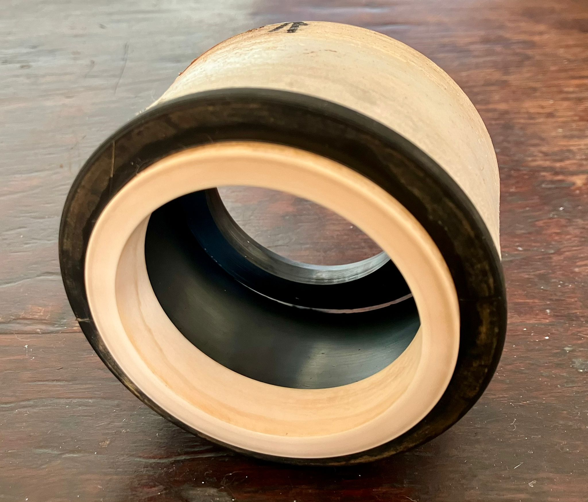

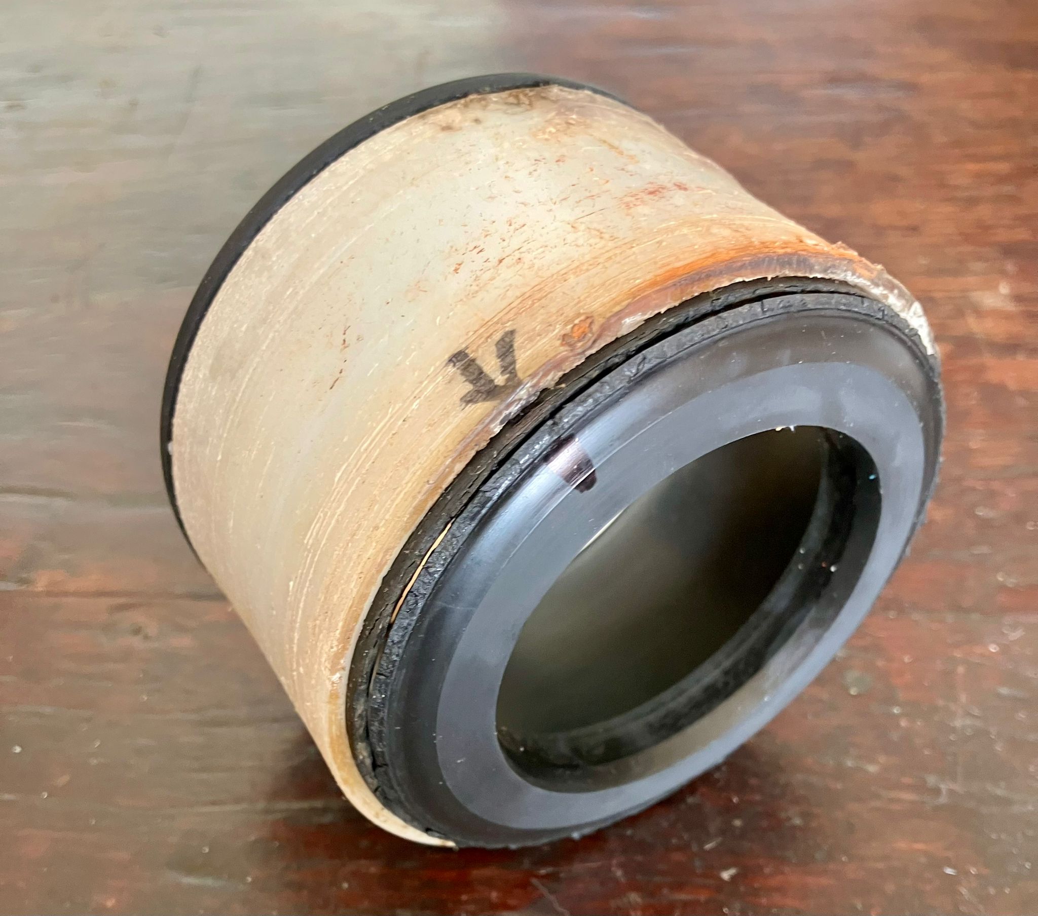

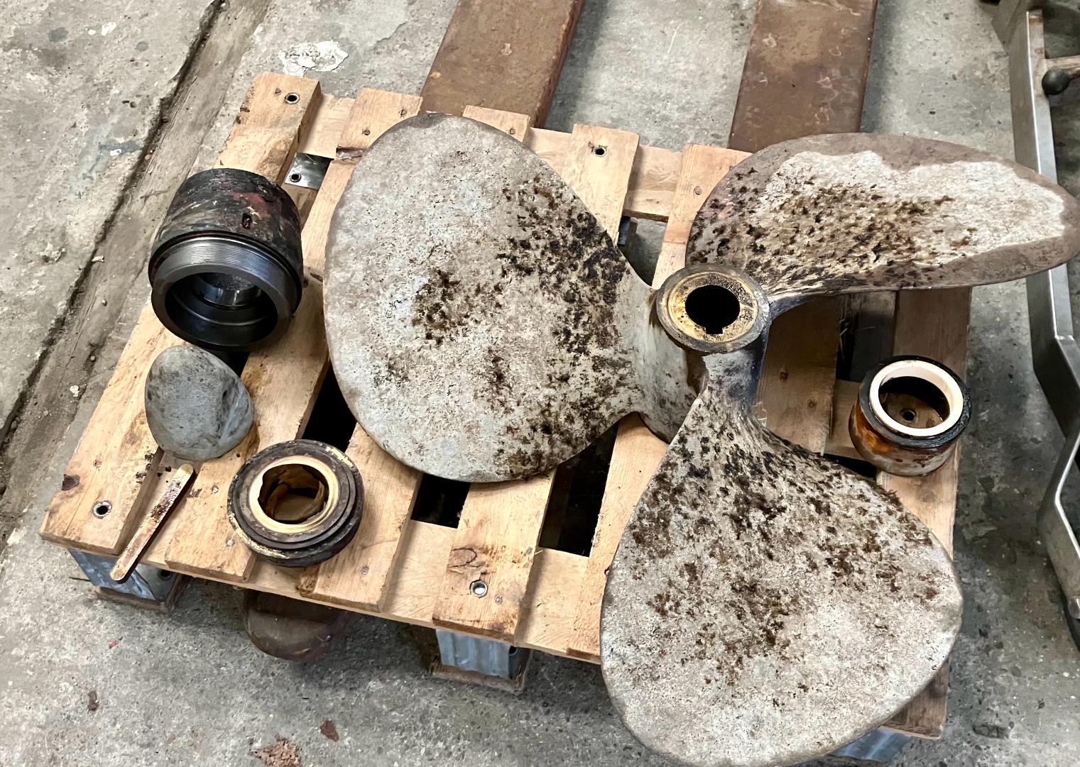

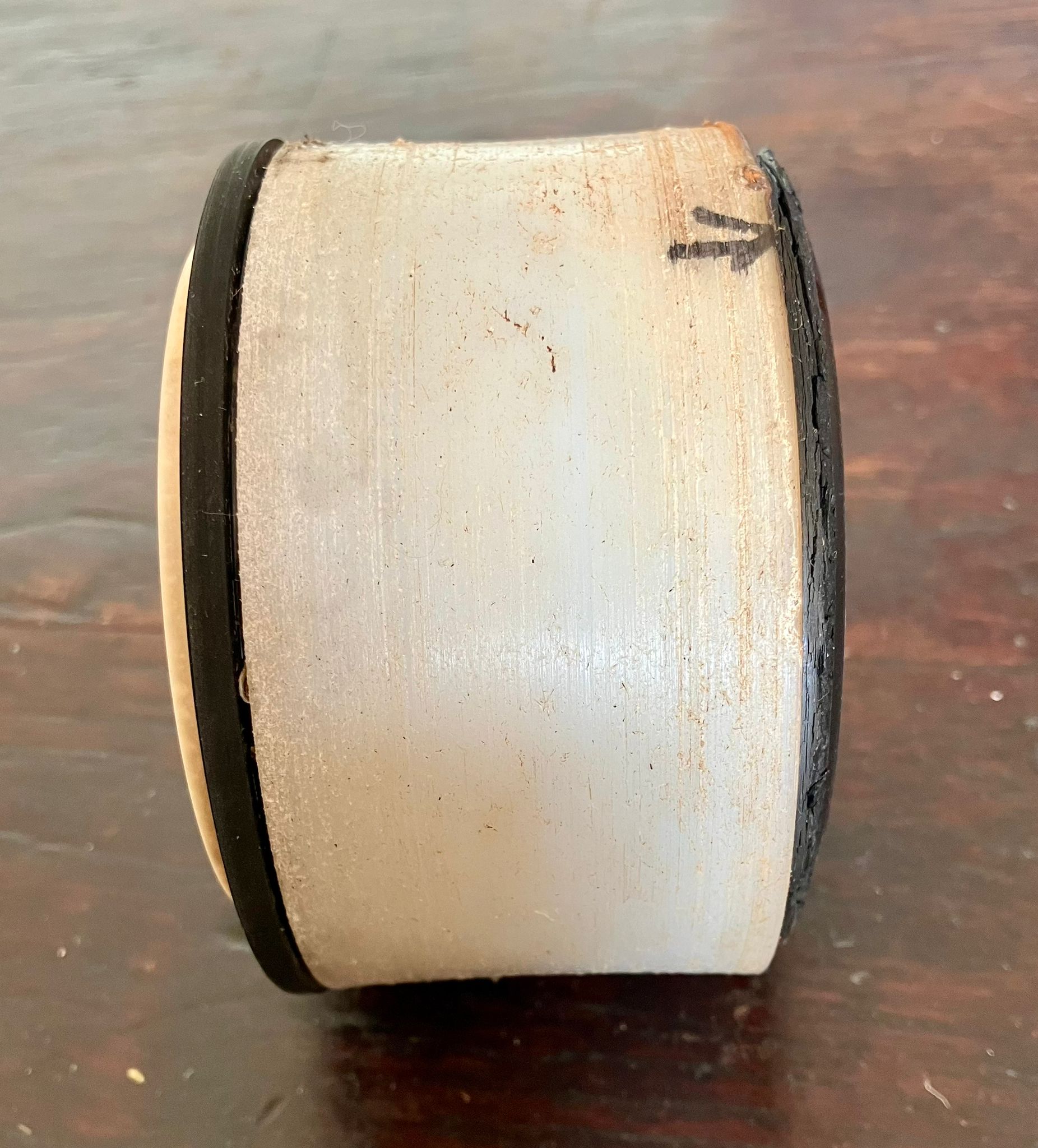

    thank you, exactly as you said, after 40 years in service, disassembly was not easy. The seal itself is fixed within plastic tube and secured by another plastic ring. Up to now I was not able to find any similar so I assume it will end up with some modification to accomodate a contemporary seal.

    Contact Akerboom in Holland, they used to make all the stern tubes and seals for De Vries
    Akerboom Yacht Equipment
    Hoge Morsweg 113a
    2332 HJ Leiden
    Netherlands
    +31 71 576 1600
