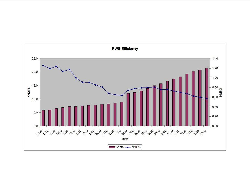

    I have a 42 with 454's and had the same question. The guy I bought the boat off of quoted 12 gph at cruise (14k). Who knows....
    I do know if you open your secondaries (4 bbls) your boat will get REAL hungary. I will try and post a graph I found for 454's on this subject I found to be what I think is an accurate guide. Hope this helps.
