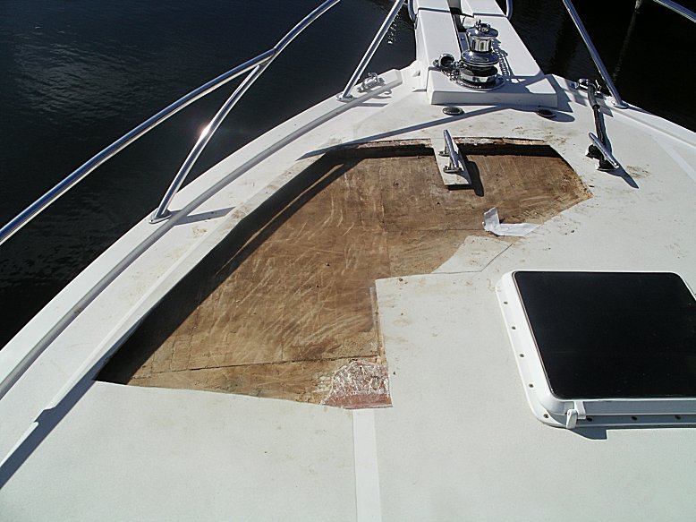

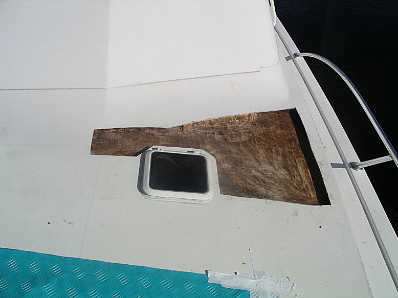

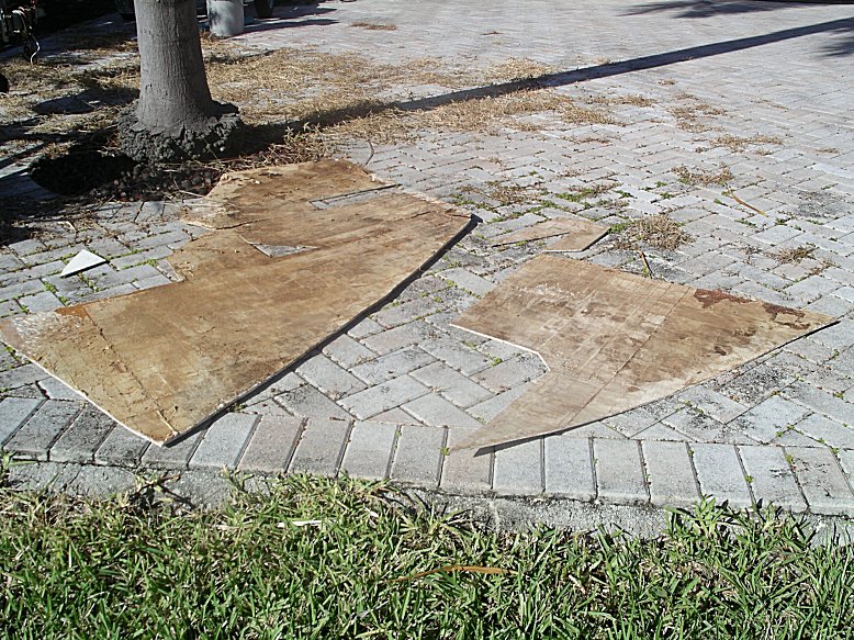

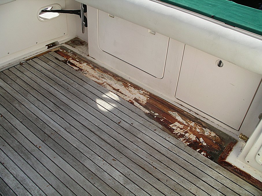

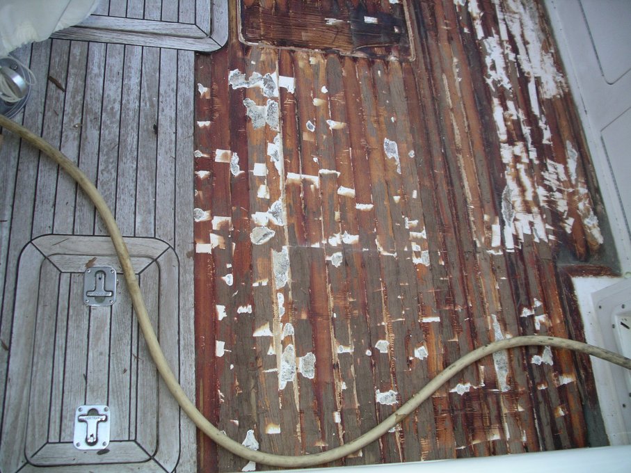

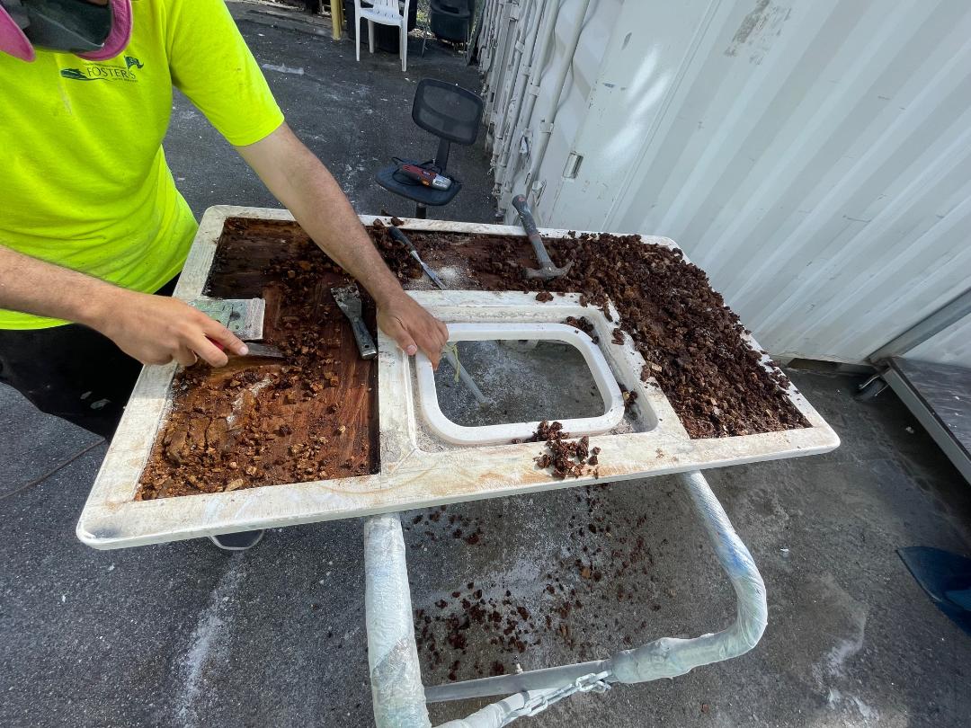

    After removing teak cockpit deck found the main hatch was wet so it was opened up, dried out, and rebuilt. Pre purchase survey showed two wet areas on the front deck which they cut open and cleaned out today. Apparently they need to remove a section of headliner as the 4 bolts holding the port cleat are loose but just spin so suspect there's an aluminum backing plate with locking nuts. No idea how it got wet in there.

    Cherry Hill, NJ
    Wow ! , Spooky stuff to me. I think you have some one doing the work for you? Or are you doing it? Anyway keep us posted with more photos as it goes along if you can. Do they save the old cut out fiberglass sections and reuse them on the install ? Or is it all new glass? What do you install for the deck filler ? New wood or foam?
  14. SplashFl
    SplashFl Active Member
    Feb 2, 2021
    515
    S. Florida _ Bertram 46

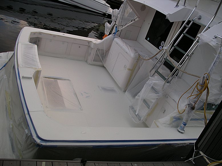

    I have local company doing the work at my dock working stern to bow started with removal of the old teak on deck & gunnels, refinishing the fiberglass that was under it with new Awlgrip with combo of fine and course non skid added. No idea what filler they used in the hatch as that had been taken back to their shop but will see what they use on the front deck. I believe they will use the original glass all cleaned up in my yard.
    Getting all the brown glue up was best with use of a heat gun but in some areas it also took up gelcoat creating more work.
    Ten years of teak maintenance on the last boat convinced me no more exterior wood.

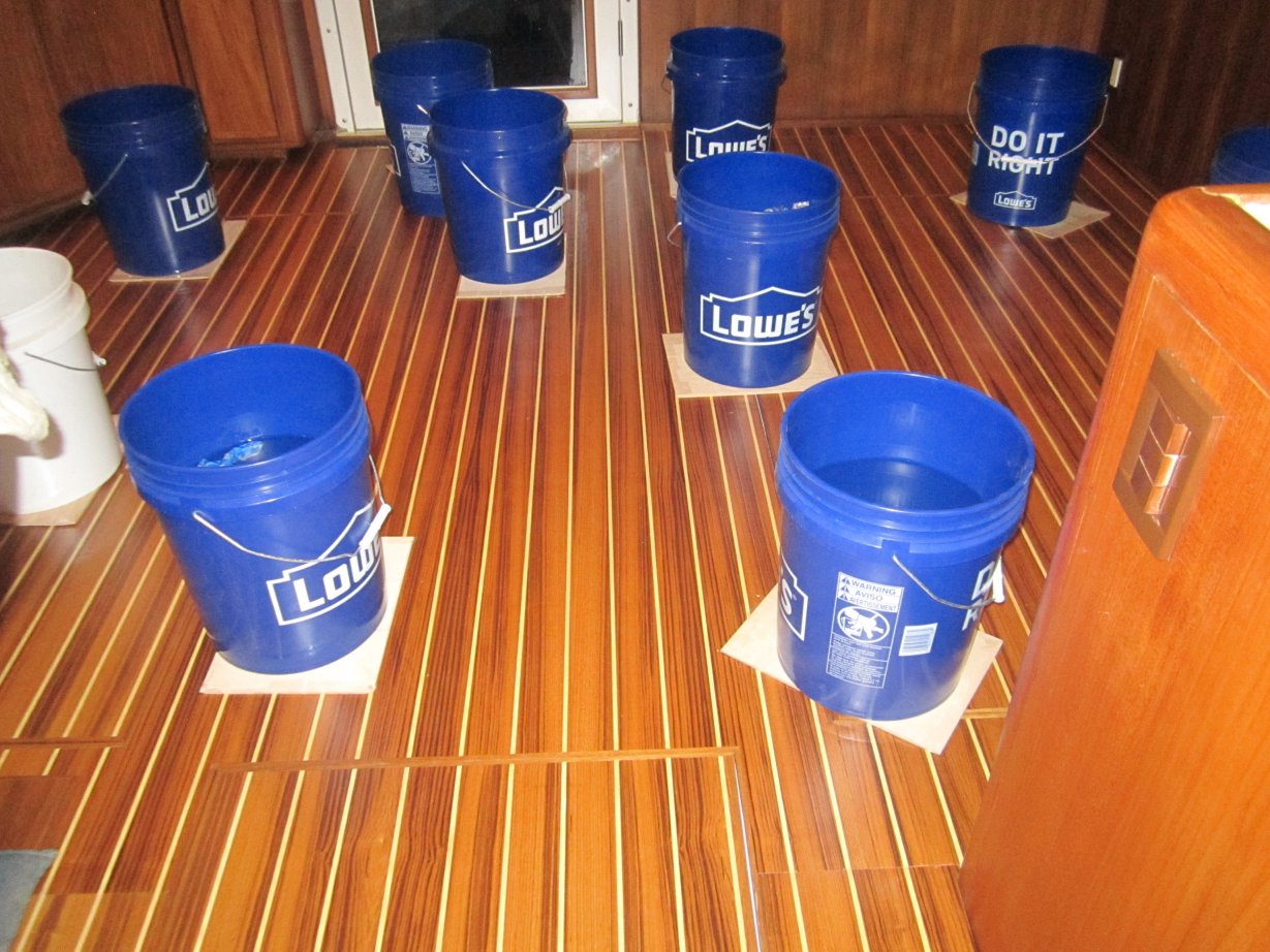

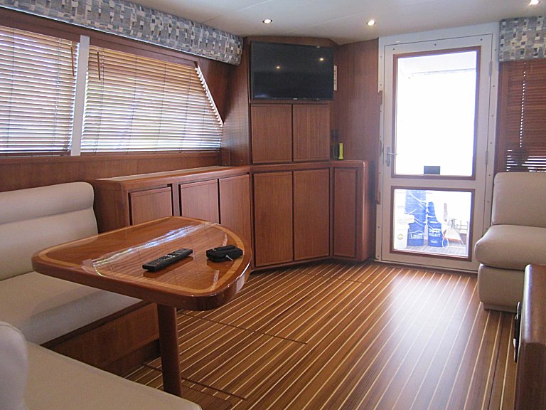

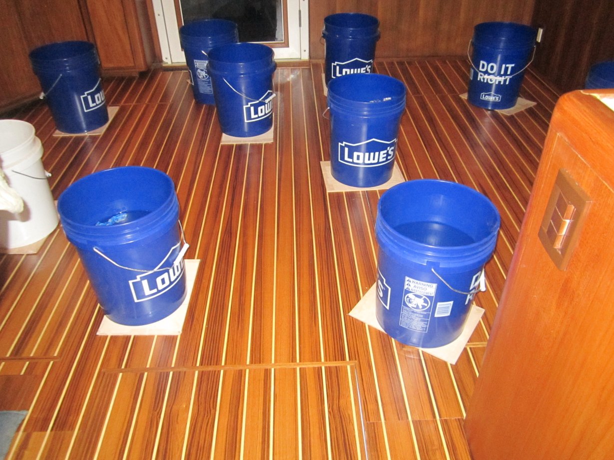

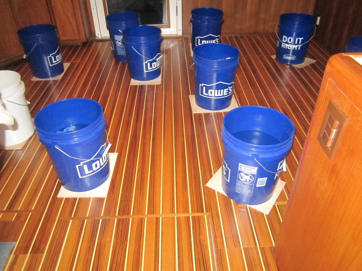

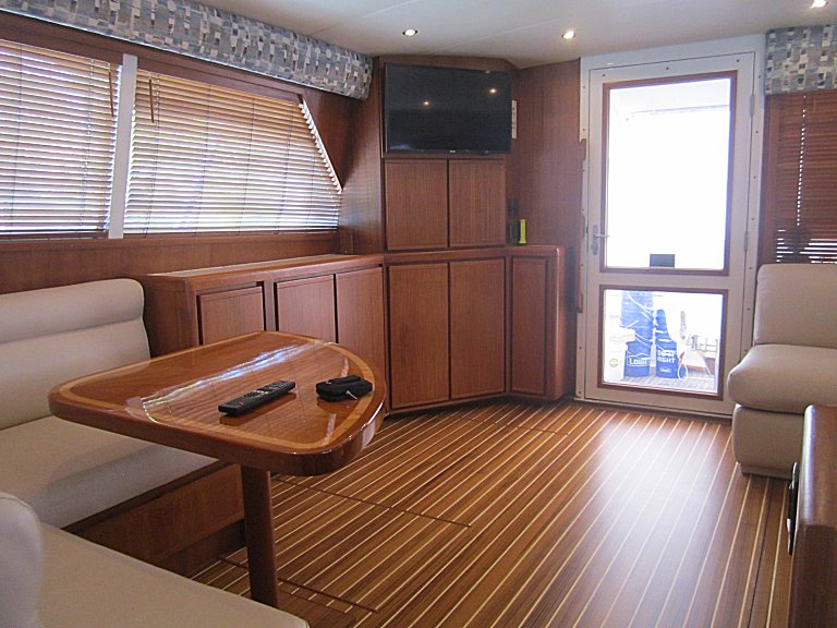

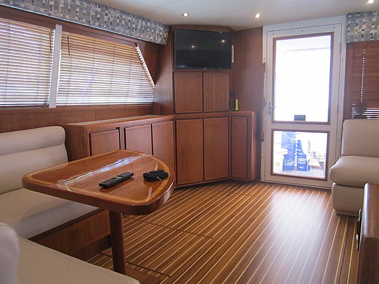

    While removing the exterior teak, interior carpet replaced with teak & holly.
    Weighted buckets of water while cement dried.

    That looks great! That being said , I like wood and prefer the natural teak cockpit deck you had. I’m a little nutty, I enjoy the upkeep of wood.
    But all of your work looks real good.
