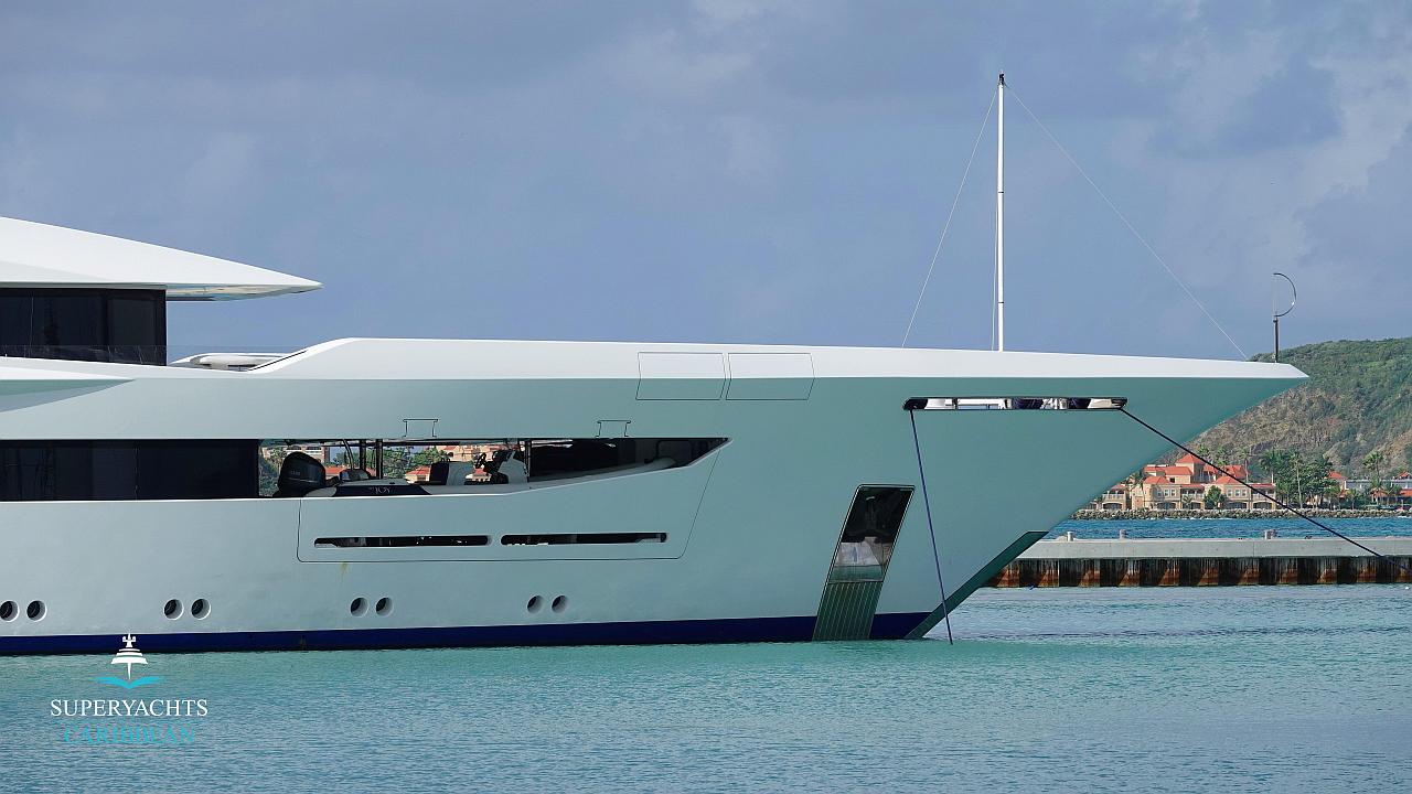

    The other day I was taking some photos of the 70m Feadship built JOY on her arrival in St. Maarten after completing her transatlantic voyage. The yacht was docked in the commercial port in Philipsburg and the crew was busy with carrying out some repairs, washing her down and pumping sludge.
    I did notice the space on the main deck between the bow and her superstructure. Enormously sized windows were wide open providing a nice airy spot. But then I also looked at the limited freeboard.
    In my further research about her and her designers I also came across these photos in an online publication: https://www.yachtcharterfleet.com/luxury-charter-yacht-48165/joy-photos.htm
    When I looked at photo no. 7 and photo no. 15 of 39 and saw these glass sliding panels I was wondering how this solution is going to meet safety standards under the Intl. Ship Construction Cert / SOLAS or similar?
    The overall lofty design is very elegant. But was thinking how it might feel onboard when sailing the Atlantic with Bft 7 or more.
    Can somebody comment?

    I use to think the same, but I am sure the glass is laminated and strong enough to take any wave...
    On my old 100 m design with panoramic windows forward, I had a protection in front of them;

    I can assure you that every aspect of safety and water-tight integrity has been studied and scrutinized by both the designers and by Lloyd's Class. If she were built by some on-off yard, I would also be skeptical. But this is a Feadship.

    Big windows are the trend in yacht deaign. So ISO has developed a standard for that. Check
    ISO 11336-2:2020
    Large yachts
    Strength, weathertightness and watertightness of glazed openings

    I've worked with large 'structural' windows several times and the previous responses re: strength & testing and class approval are spot on.
    Also, location is rather important. Not just fore & aft (yes, the bow area is designed for higher slamming pressures) but vertically. If the windows are above the bulkhead deck, the vessel might pass stability req'ts with that space considered free flooding.

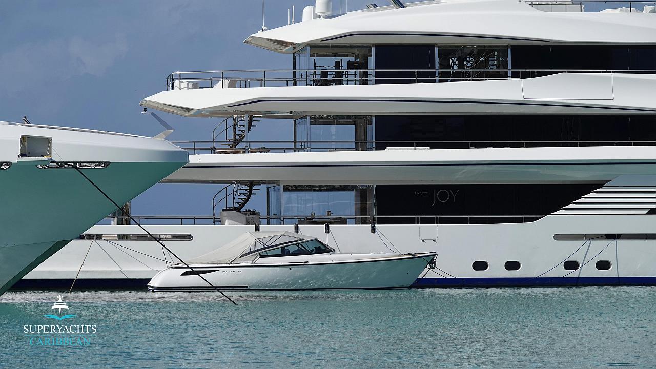

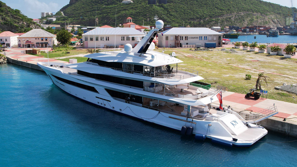

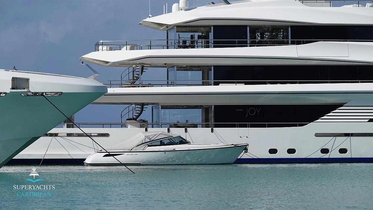

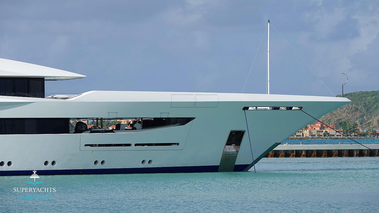

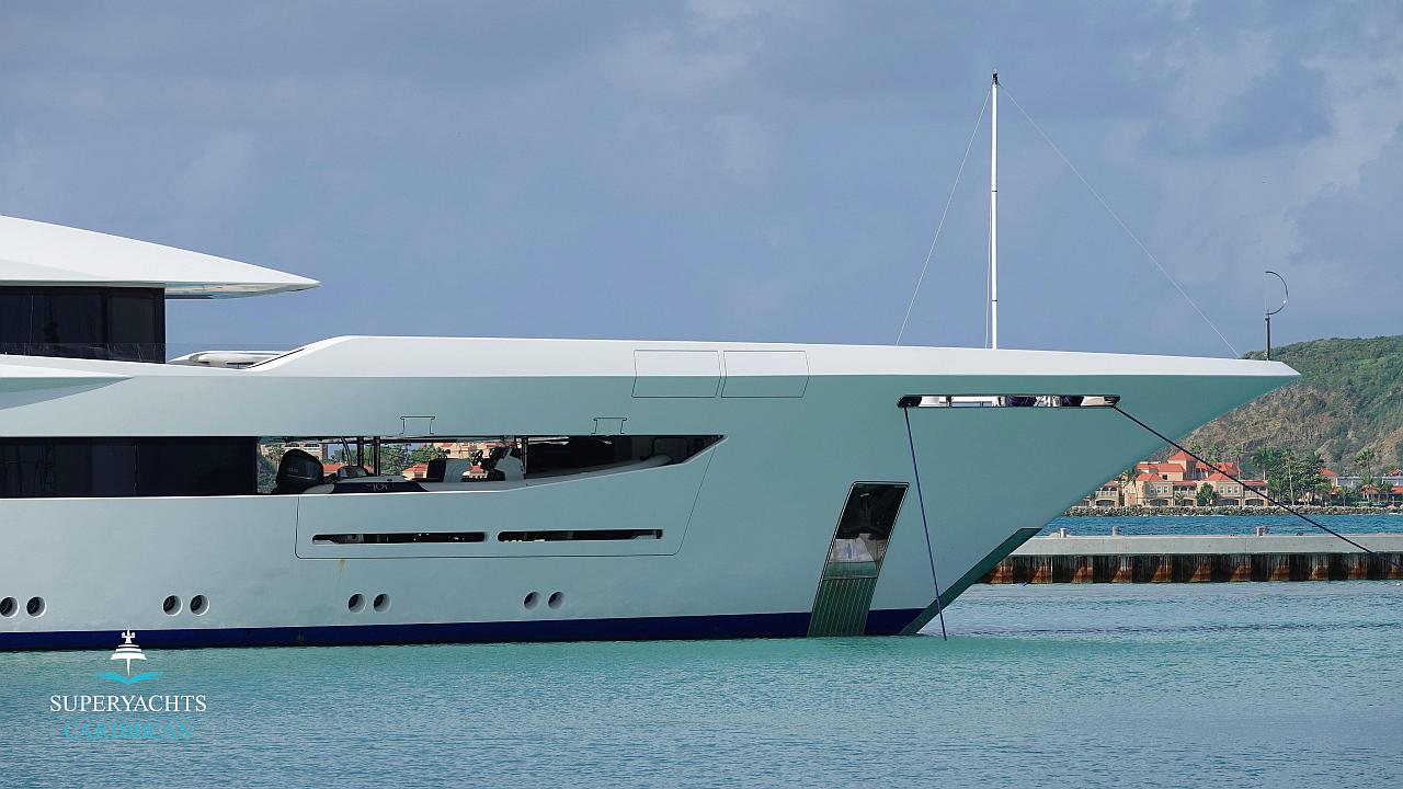

    Coming back to JOY. I attach hereto some better pics displaying the situation with the glass panels.
    @Ken Bracewell: yes, I fully agree with you in terms of Feadship as builders and having LR as classification society involved during the construction. However, if you compare her design with for instance with Hakvoort’s TOP FIVE II which also have lots of glass then this seems to me somewhat “more promising”.

    I would imagine that area in the bow that serves as the tender garage would have been specifically designed for...in the event of taking on water. While it maybe relatively protected from straight-on seas....a wave coming up beamward would definitely result in water ingress in that area. Which explains the freeing ports integrated into the base of the garage door.
