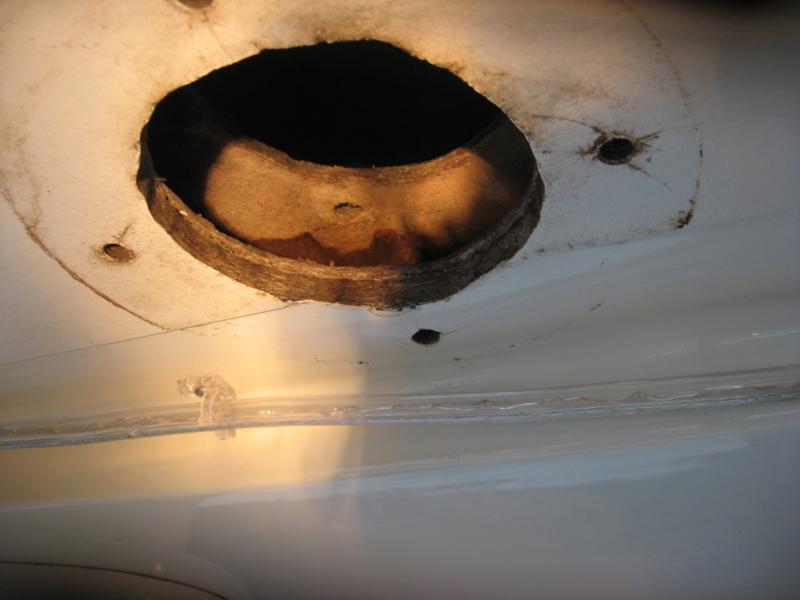

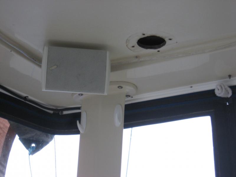

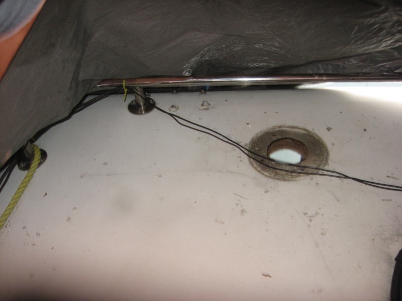

    OK, the pole davit opening in the sundeck roof that is pictured is 3in. in diam. the top and bottom surfaces look to be a fiber impregnated fiberglass. Very solid ! The top is about 1/4 in. and the bottom is about 1/2 in. thick, they both ( top & Bottom) are sound, not wet or damaged in any way that I can tell. The wood inside between them is bad out to about 3-4 inches. It was pretty soft and wet. I dug that out and was told from a all around structural strength stand point I could just fill the void with a spray-foam and call it good. I was wondering what you all thought? is there a spray-foam out there that would work, I see the local online marine supply dealers have "Evercoat" but I was hoping I could find some kind of maybe an epoxy type or something that would be strong and waterproof. your suggestions are much appreciated. I will need to cut out the material, whatever it is to put the pole back down through it.

    Since it's a small structural area I would fill the void around the hole with solid mahogany. Caulk any voids. This will give you a core that will hold up well to the davit post and flange. The result will be a superior davit structure than with the original end grain balsa. You can get some mahogany shorts cheap and cut pieces to fit tight. Easy.

    So do I understand correctly to cut pieces of the mahogany so I can work them in and than try to fill the voids around them using what? I'm not sure how easy it will be to fill the voids ? Hum
  4. Capt Ralph
    13,439
    I was thinking at least Polly board. On smaller Jobs, I have had great results with West epoxy and 406 Colloidal Silica Filler;
    Make a peanut butter with some slow hardener at first, just start pushing it in against the coring. After you get some way in there, tape off the bottom of the hole, and start applying more peanut butter epoxy from the top with slow hardener. That is a thick chunk of epoxy and you do not want it to flash fast and get hot. If the epoxy runs, it's not thick enough. A job this size is going to take several small batches and over an hour. Don't rush or answer the cell phone. The next morning you may be able to remove the tape and shape the hole from the bottom, The epoxy will not be completely hard so avoid getting back on the top for another day. The second day, sand, file and drill as needed. Bed & Bolt. Never worry about it again.
    You will want to use the better gloves from West or heavy mechanics gloves. the thin/cheap ones will tear in a few seconds.
  5. Pascal
    8,546
    Forget foam or cheap bondo like resin, stick with epoxy which adheres better to existing stuff.
    If you are sure that you have removed all the wet rotted wood, and if the void isn't too deep, you can fill it with thickened epoxy. I like west system thickened with their high density filler. Easiest way would be to temporarily seal the bottom of the hole (duct tape on the ceiling) and force the thickened epoxy in the gap. A few voids will not be a problem...
    If the volume to fill is too big then you have to replace the core. Mahogany is an option as it is a hard wood and resistant to rot but it is pretty heavy therefore not ideal for large surface.
    The best core to use would be divinycel but it can be hard to find just a small piece. You could cut in pie slices and push them in one at a time after coating both sides with thickened epoxy. If you can't find any modern form core, you could use some marine plywood. Make sure the edge is recessed by about 1/4" and fill that up with epoxy so that water water can't get back in
  6. Capt Ralph
    13,439
    From the pictures, it looked like foam core. Just back a tad in one direction and a ways in another direction. Scrape out some of that foam around the thru bolts a ways also. The 406 filler holds up to compression very well. Just take your time and use the slow (206?) hardener.
    Even if that is wood, clean it out and do the same, Fill er in..

    Pascal, I was just looking at the west system stuff and am thinking that's the way to go. thanks again
  8. firedreamer
    firedreamer New Member
    Sep 20, 2010
    26
    Puget Sound, for now
    rcrapps, it is a wood, balsa im thinking and i will use the filler ,thanks
  9. Pascal
    8,546
    Definitely balsa core... Let it go to long and you will see core juice leaking on the edges....
    Being in Oregon.... The slow hardener may not work because it s cold up there... You may need to stick to the fast 205 even with the volume.
    Basically if the diameter of the hole is not larger than the void, I would use thickened epoxy. If the void is bigger than the hole, then you ll have to use core. The good thing about using down is that it is a little flexible so you should be able to gets it in whereas wood will not bend enough.
