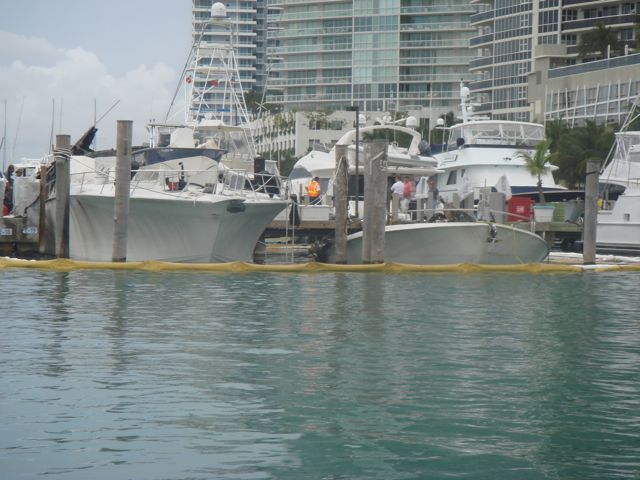

  11. Loren Schweizer
    Apr 20, 2004
    1,352
    Coral Gables/Ft. Laud., FL
    Looks like the Viking 74 SF in the vids?

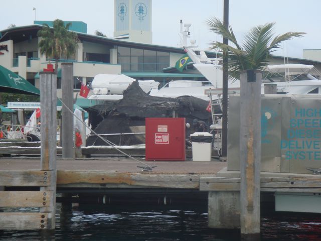

  12. azureazimut
    azureazimut New Member
    Apr 28, 2007
    31
    JC
    It's both of them... here is the aftermath:

  14. gsuburban
    gsuburban New Member
    Apr 1, 2008
    4
    CA
    Aftermath
    There must be better photos out there. I hope someone has them and will post hi-res formats of them.
