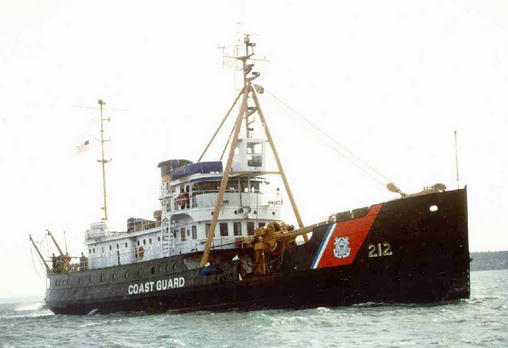

    I believe we're talking about the Fir, retired about 1990. Lighthouse tender and buoy tender active in the PNW.
