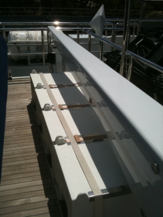

    Well, I don't store tenders below deck so I didn't have that issue to deal with. What I came up with for fuel storage was this. They're 4 212 liter tanks stowed under the crane with petrol vented caps and such. Under the white hood is a pump, and below that is a box with the hoses. I built the tanks so I can fit two of them at a time in the tender and run them ashore to get refilled. Lloyds was quite pleased with the setup, so I'd imagine MCA would approve as well. As for the fuel in the tenders, that is a weird one. Maybe if you had a two way pum and a wand at the end of the hose that you could suck the fuel out of the jet skiis? The tender would be rather simple, just put a Y-valve in the fuel line between an electric feed pump and the engine. Put the tender up, hook it up to a transfer tank and flip the switch. It makes no sense really, because as you say, there is more hazard in a nearly empty tank than one pressed full. The only thing you eliminate is the potential for a liquid fuel leak of a large enough proportion to create an explosive environment inside the mother vessel which I guess is their concern. I personally think they are creating a larger hazard with the fuel transfer operations than they are eliminating from certified petrol storage tanks, the static generated by doing the extra fuel transfers are the greatest hazard I see in the whole operation.
