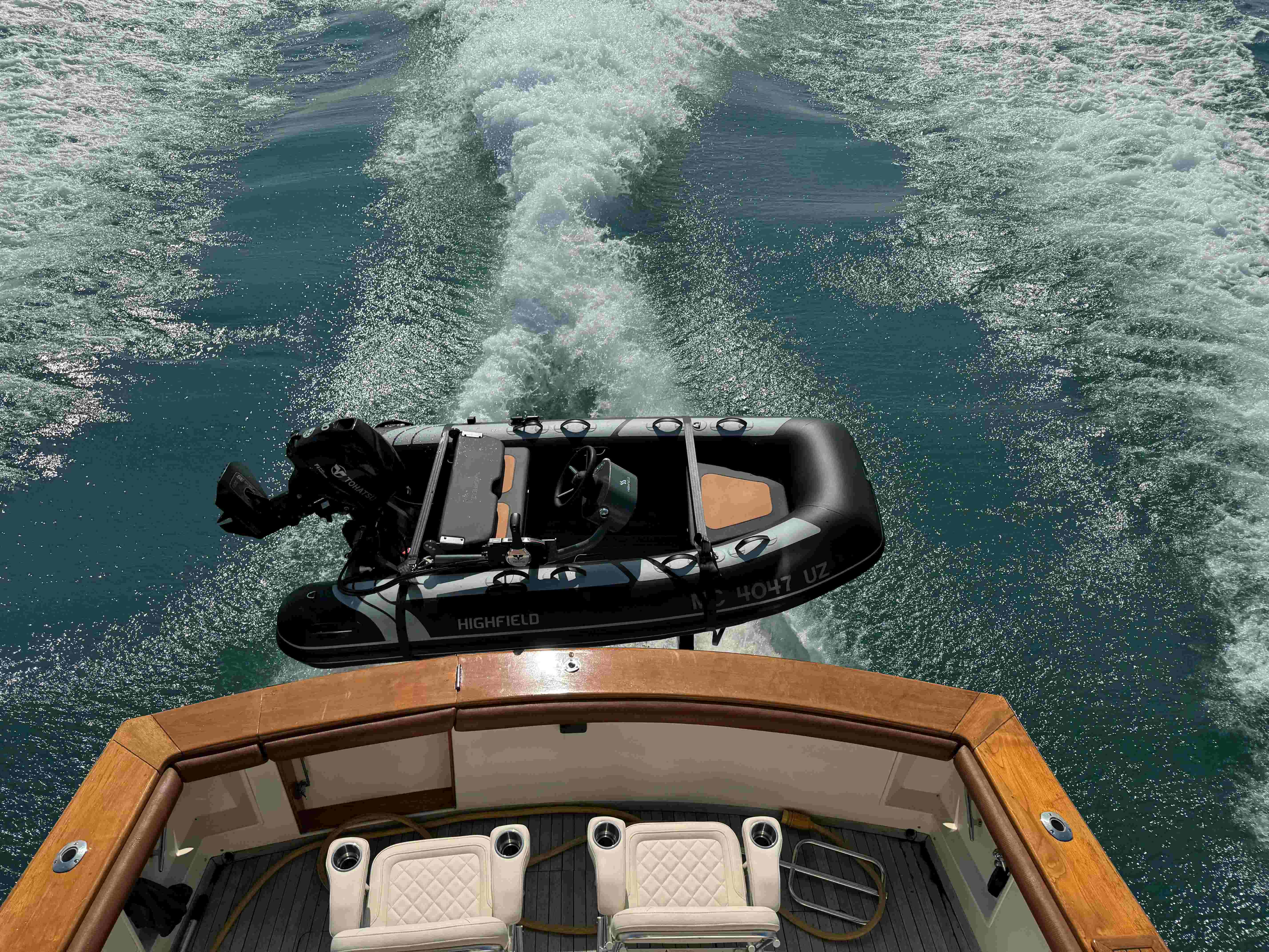

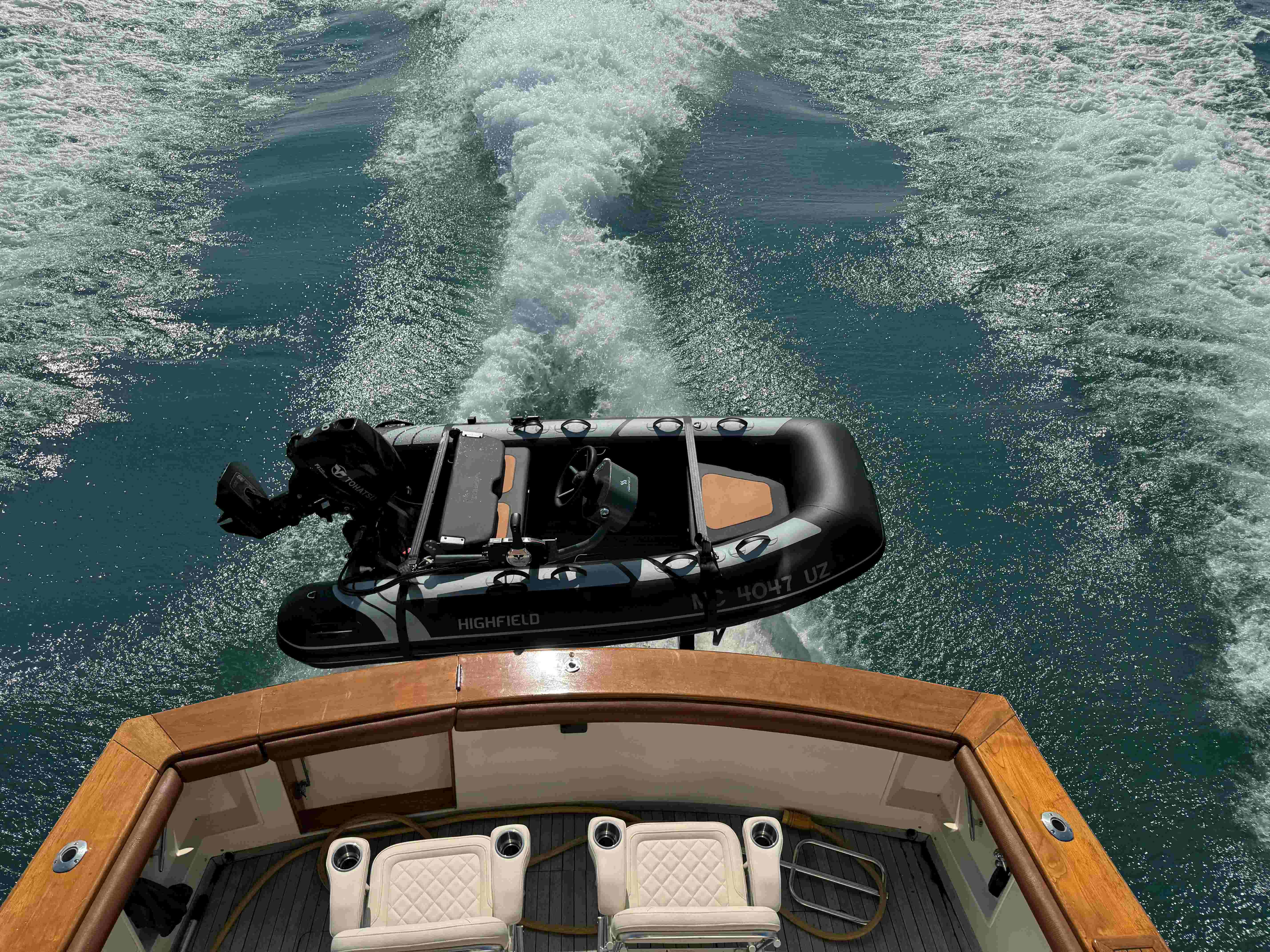

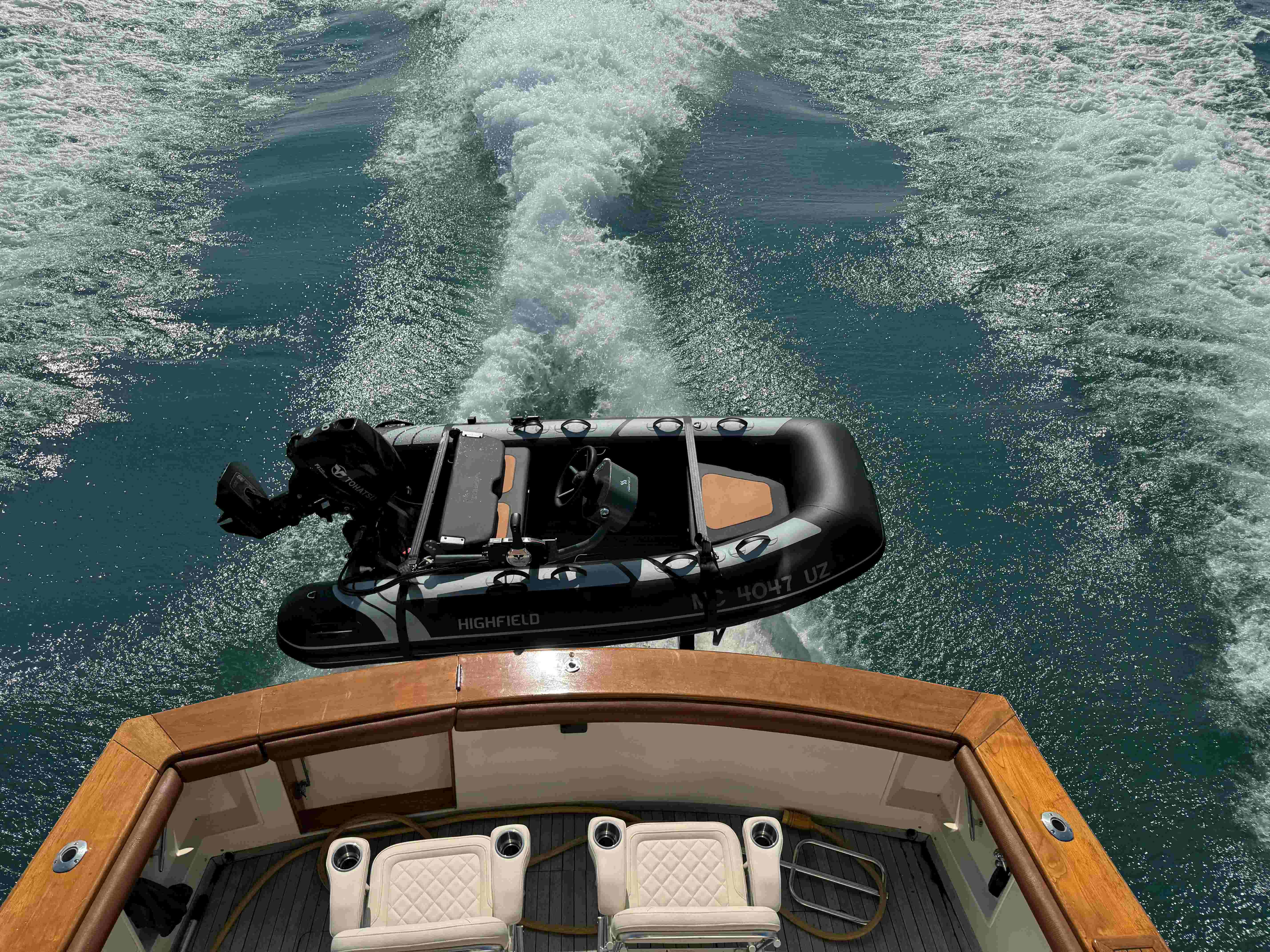

    Following up if anyone is interested. I ended up biting the bullet and splurging on the Freedom lift and I love it! Shout out to the Freedom lift company as they were fantastic to work with . The new lift saves my back and the hassle of taking off the 83 lbs motor and flipping the dinghy up on the transom every weekend. I went with a Highfield 10'2" and it fits great. With the extra weight of the lift and newer heavier dinghy luckily it didn't change the way the boat sits in the water or hindered performance. Pic attached and video link via Google photos
