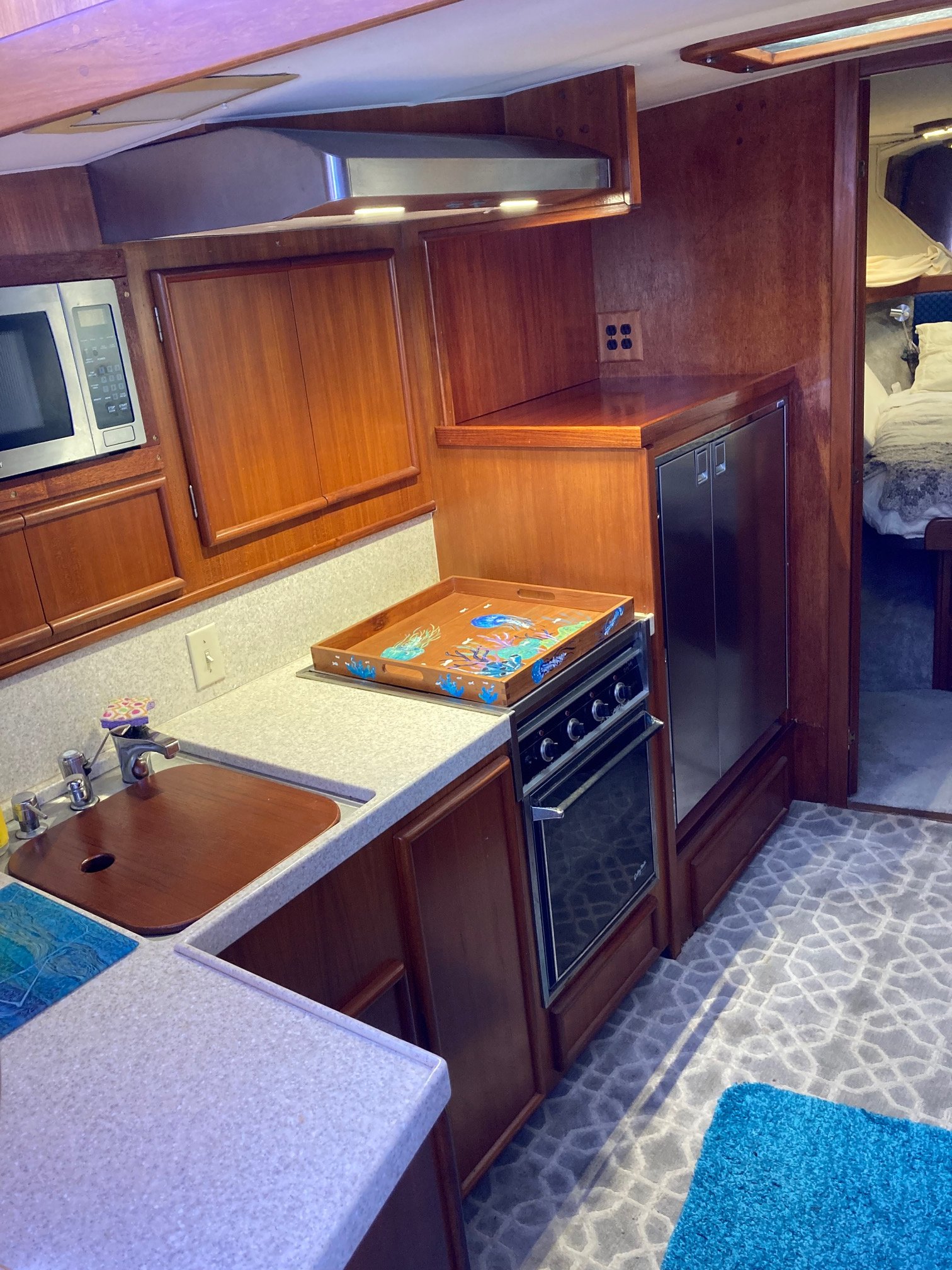

    We did a major overhaul in the galley, removing the original tall house refrigerator (a home depot scratch and dent by the PO that stuck out 6" into the hall). You can see several different finishes here. The panel on the left of the new fridge cabinet is original mahogony and stain just new top coat. The panels along the front of the fridge and the trim are teak, stained and top coated. The panel behind/above the fridge is new mahogony (lighter than original) stained and top coated. The wall at the far end is original mahogony that was not stained by factory, stained and top coated.

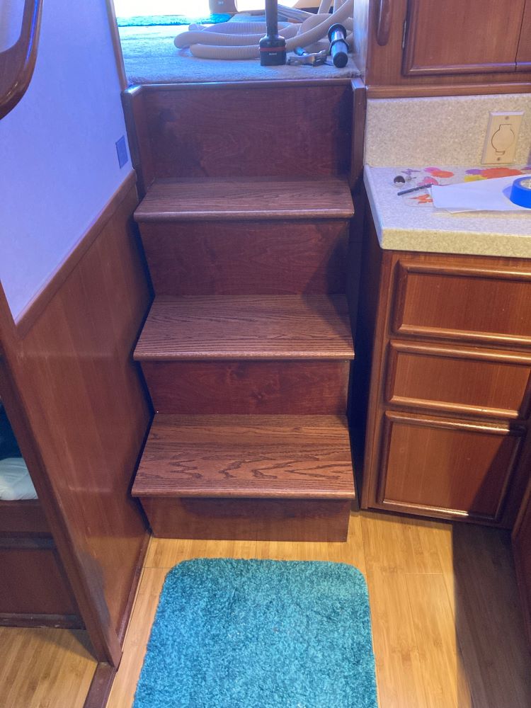

    Here the wall on the left is original, was sanded and restained a bit at the bottom to remove prior water damage. The fronts of the stairs are new mahogony, stained and top coated. Stair treads are red oak, new teak ones were way expensive. The cabinet to the rights is all original, just cleaned.
    Here the port side wall was sanded, stained in places to minimize water streaks and top coated. Same with the wall to right of stair. The oveheads (can only see a little) are all original, just cleaned.
    Overall the finishes integrate well and almost no one notices the differences but my wife (she is an engineer by day, artist by night) and myself since I know what was done.
