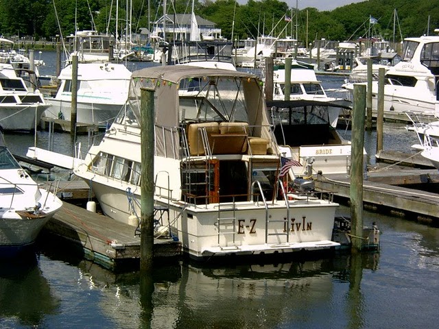

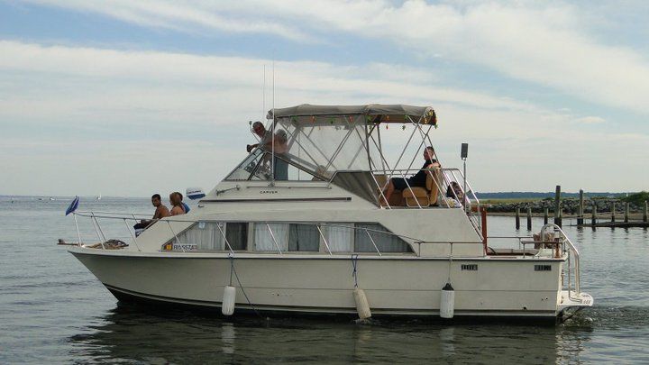

    For the past two years I've been working on my 1981 Carver Mariner 3306. She's a great live aboard for weekends on the water and she cruises pretty good too. I've rebuilt a half dozen boats over the years and I do all my own work, so I'm pretty handy on all aspects of marine repair.
