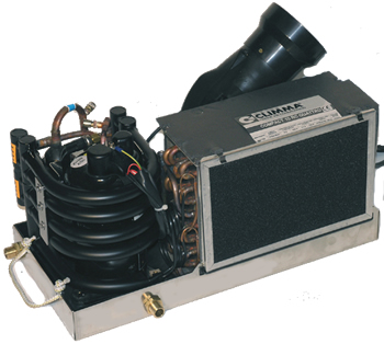

    Do you have a number of things that look like the thing in the picture, particularly the thing (Compressor) with the pipes wound around it ( The Condensor)

    doug, what others where trying to ask is whether or not you have remote condensors or all in one. Marine air cons have two main components: the condensor which is the part on the left side on K1W1's picture (a compressor with pipes all around) adn the air handler (also called evaporator) which is a blower and somethign with cooling fins (seen on the right side of that picture)
    typically on smaller boats, they are combined in a single unit, like the one pictured, located under a couch, bed or cabinetry.
