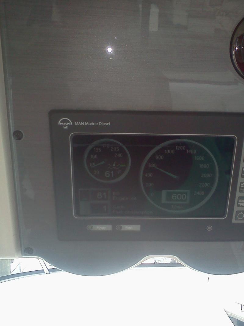

    One of our customers MAN display has a led panel going out. The display box is perfect and the display is nice and bright. A line of segments starting dropping last year from the upper left. Now, the bad area is getting larger.
    Don't need the whole box, just a lead on a good lcd panel or another whole box.
    I still have the shakes about the Man price on the box, no lower parts available.

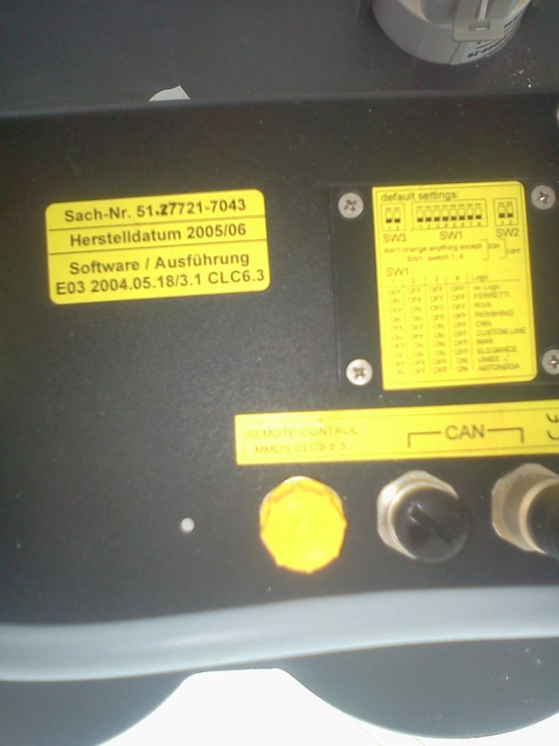

    Seems the LCD display part of the whole display box is a special part not available on the regular service/repair market.
    Boengin seems to be the supplier but no support from their web site.
    Looking for somebody that has an extra box or a bad box and maybe a good LCD display in it.

    Ralph, Can you confirm the spelling of the supplier name in your post of supply any more details?
    If you can open up the box and see the display as a whole you might be able to see some identifying marks on the LCD Panel itself.
    This could well be the easiest way to get a new one.

    The supplier / manufacturer for the MAN displays and monitoring systems is the Boening Company in Bremen, Germany.
    If You look under Homepage- www.boening.com - after sales - spare parts, they provide contact data (service@boeing.com), telephone numbers and a download pdf spare part catalogue (in english). This guys are very cooperative and eager to help.
    I know this company for years and as I will see the Boening guys at the Düsseldorf boatshow next week anyhow, PM me the details of your faulty parts and the problem. I will forward your problem to them and try to get them going.

    Ralph, On Page 44 of http://www.boening.com/fileadmin/user_upload/spareparts/spareparts_en.pdf
    You will find the screen that seems to have replaced all previous ones including the one the number on yours refers to.
    It was also refreshing to read on the home page that although they make all these for MAN they will support anyone who has one.
