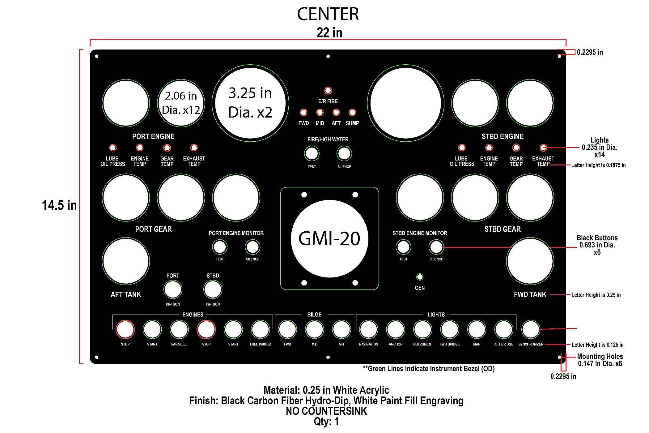

    Nearing the end of the process of replacing all of the analog gauges & switches along with 3 new carbon fiber dipped panels that will be LED back lit. Gave only a little thought to going all digital to MFD's so as to avoid the loss of all Man Engine information in the event of a black-out especially when out of country. Might be old school, but a lot to be said about old reliable.

  7. SplashFl
    SplashFl Active Member
    Feb 2, 2021
    508
    S. Florida _ Bertram 46
    Engines fortunately not electronic (VDO gauges except for digital tach's) as no damage was sustained a few weeks back when a lightning storm, which seemed to park near my dock a few weeks back, "only" fried the two ECM's on the Tiara docked next door but no other electronics effected. Previous boat had electronic controls fried when lightning hit another boats antenna two homes west sending bits of fiberglass all over 3 yards but didn't destroy anything else on mine but the boat hit lost all the electronics.
