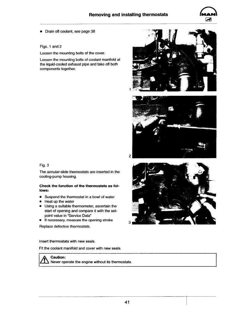

    It appears I have a sticking thermostat on one of the engines. It will read a lot cooler than the other engine. 30 degrees or more until I get up to cruise speed and then they both run the same 190degrees.
    Anyone know where the thermostat is located on this engine?
  2. Capt Ralph
    13,427
    Forward of cly #1 right. You may do better waiting till your home.

    Came home this past Sunday. Thanks for the info. Where did you find it?
    Skip
  4. Capt Ralph
    13,427
    Page 41 in my MAN D 2848 LE 423 Repair Manual.
    That is a bad scan. There are a few thermostats in there.

    Are you saying there is more than one in each engine? How do I tell which one is bad?
  6. Capt J
    14,524
    I think your engine has 2, I would replace all of them in both motors with your age and hours. How long has it been since the coolant has been changed as well?
  7. Capt Ralph
    13,427
    The pic shows 3.
    Comments on the page I copied mentions heating them up in a pot of water. I used to do that with a candy thermometer when I was a kid.
    These look like the tube units found on ole DDCs. Sometimes the tube (cup for some folks) distorts and jams. Easily observed by eyeball. Usually they stick open.
    New seals, wipers and O rings required to reassemble.
    Call Pref Diesel in Texas with your serial. Greg will put a kit together for you.
