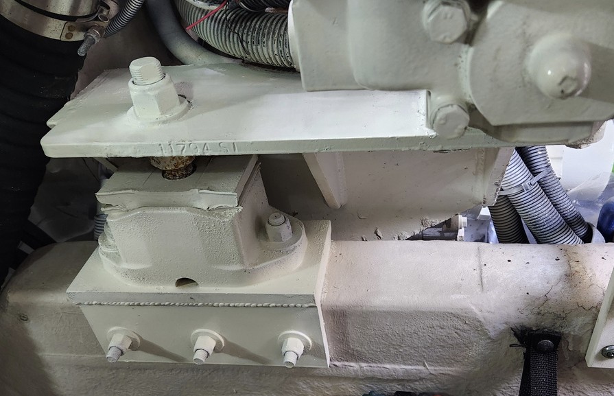

  9. ranger58sb
    ranger58sb Senior member
    Aug 20, 2013
    966
    Chesapeake Bay, USA
    If it helps to know, the aft inboard mount on our starboard 900 CRM is stamped 1794 51.
    -Chris
  10. Capt Ralph
    14,185
    I fear that is the PD part number for the adapter plate and not the isolation mount itself.

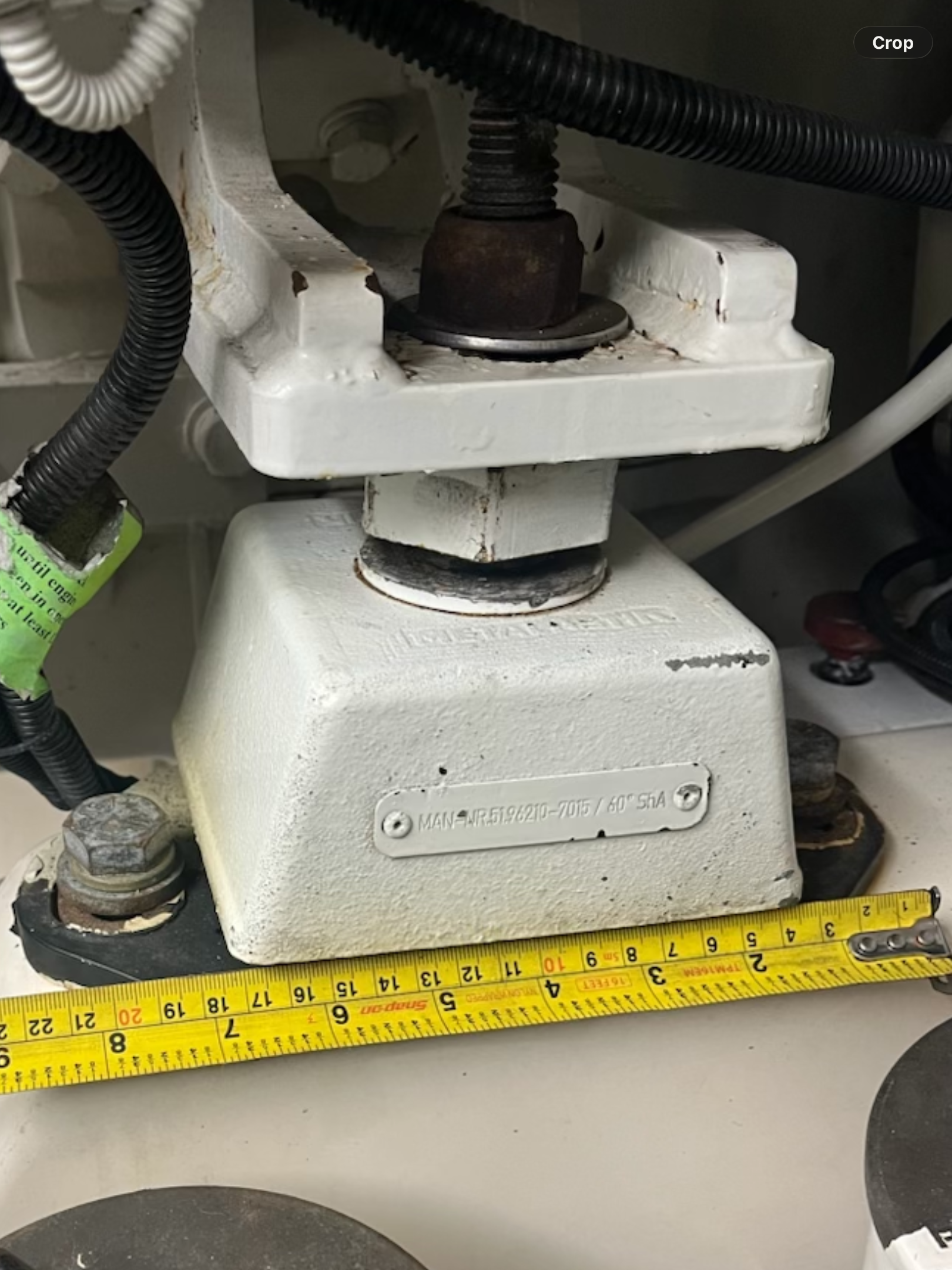

  11. Breckster
    Breckster Member
    Aug 22, 2013
    66
    Bay City
    [​IMG] MAN-.R.51.96210~7015/ 60°Sh4
    is what is stamped on isolator.. it looks like the “butter cup” design

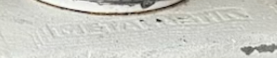

  14. Capt Ralph
    14,185
    AND, the mfg name on top?? Maybe?

  18. mapism
    mapism Senior Member
    Aug 9, 2008
    2,281
    Sardinia
    That is consistent with the coding I previously mentioned.
    FWIW, the final "15" makes it a version costing €1700 according to the EU price list.
    Though the one I've got is a bit old, and more than likely has been subject to a revision by now...

  20. luna
    luna New Member
    Aug 25, 2007
    Vancouver, BC
    Metalastik was a brand name that was used for years by Trelleborg. It seems to have lost some favour lately.
    The mount could be a Cushyfloat HT as shown in the Catalogue on Page 49, drawing # 17-1990-1.
    The height adjusters are purchased separately and can be found on page 56.
    Good luck with the repair/replacement.
